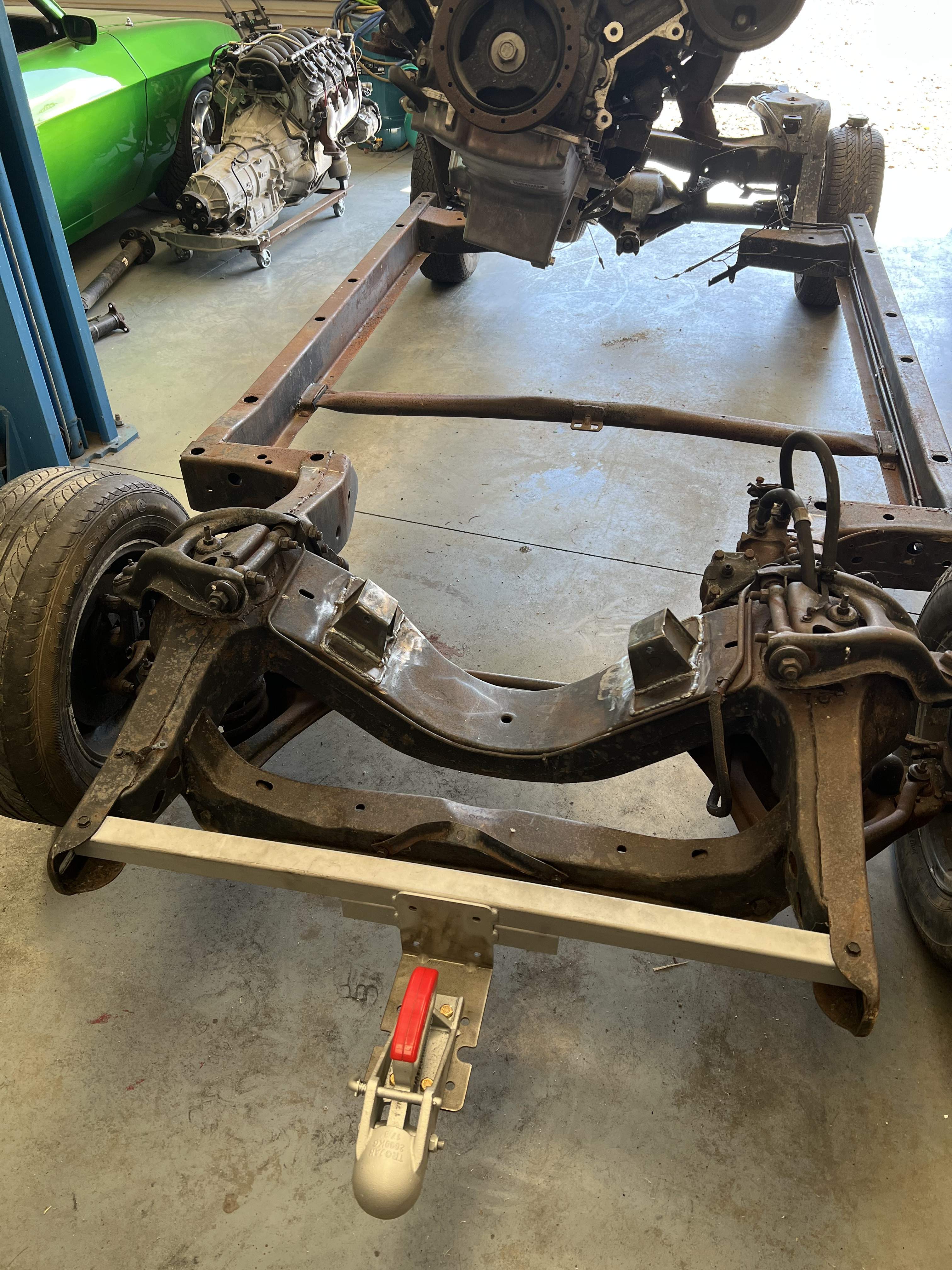

you will have a x chassis too justA like the chevs, usa 63 ponti have parallel frame design .... just like this
Kiwi is correct. The Canadian Laurentians used Chevy chassis and drive trains back in the day. So looking for a Chevy Impala disc brake kit should work for you.
