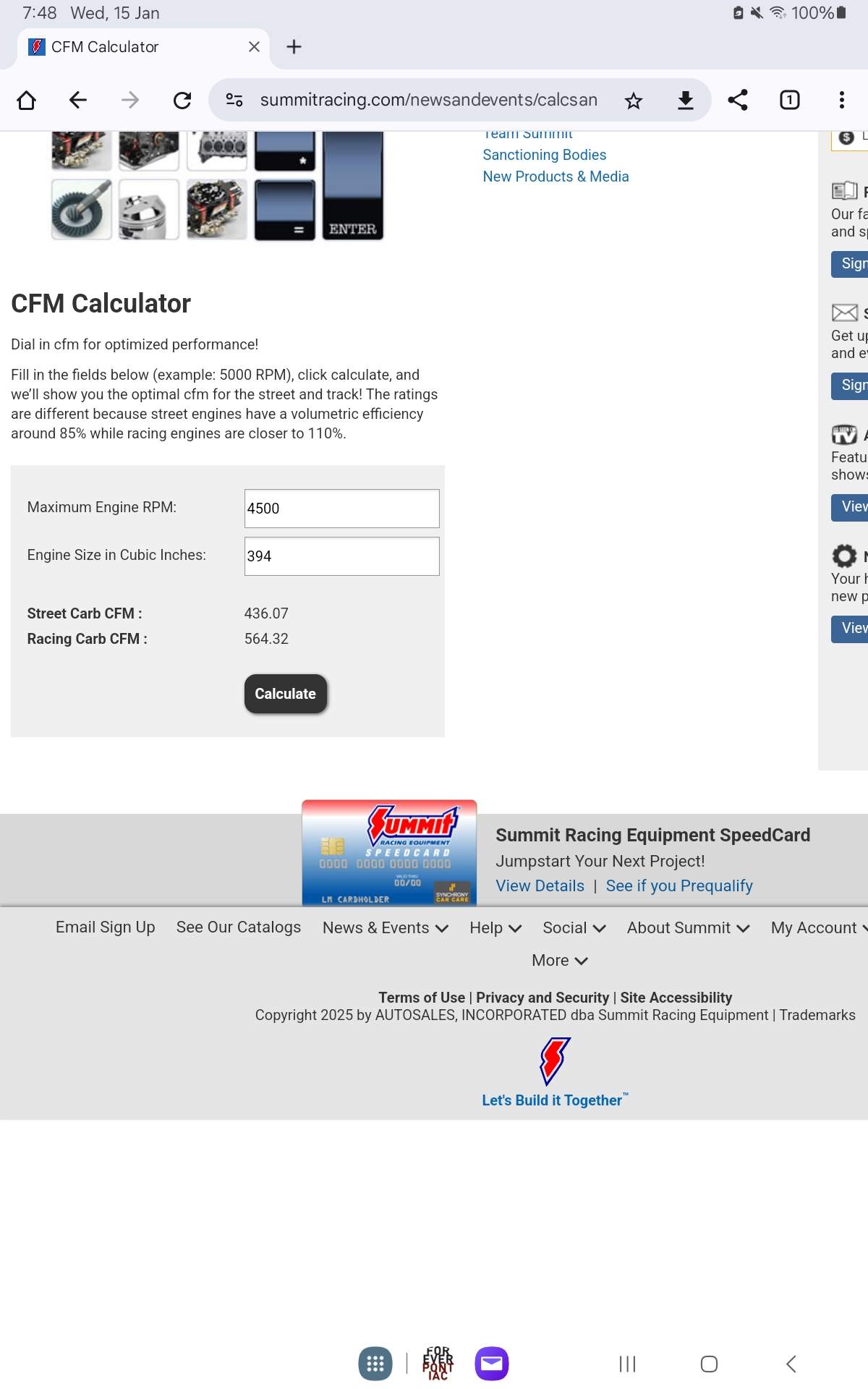

I found this, using my own engine as an example:
As you can see, my engine needs a piddling 450 cfm. Not enough to brag about to your friends but sensible enough to work properly.
