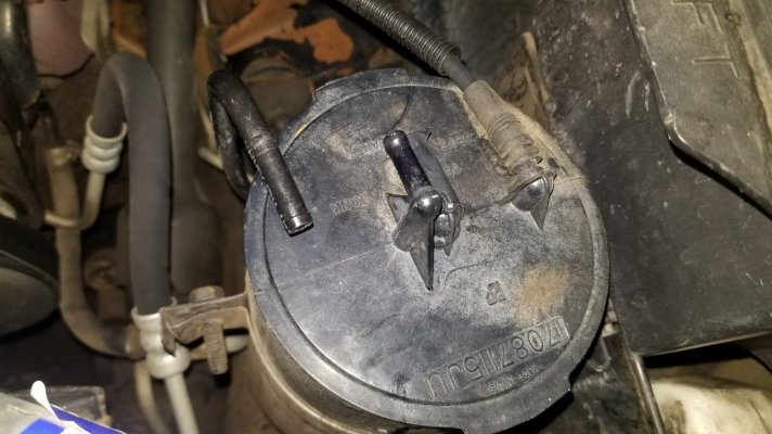

If you car has a charcoal evap cannister in the engine compartment - usually on the passenger side of the engine bay, then you can run a non-vented cap. Otherwise you should be running a vented gas cap to insure that you won't have fuel delivery issues.
Charcoal evap cannister looks something like this in the engine bay.
Thanks Frosty,
That's what I kind of thought. It currently has a Non-vented cap. There is no charcoal canister that I see. So, I will try a Vented cap and see if that helps. Thanks again, Rick
