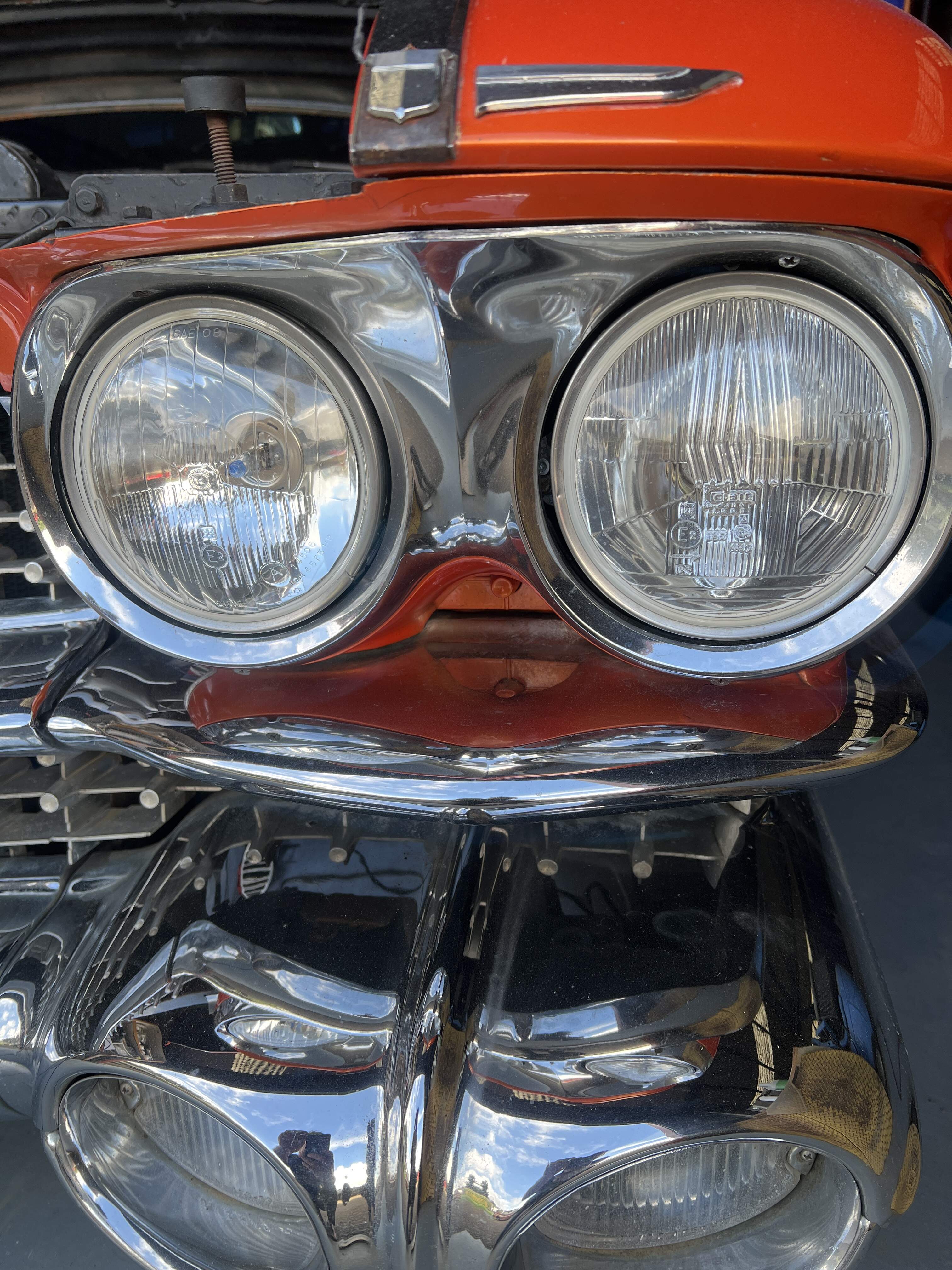

i found some cibie lights for my  59 caddy and   Fitted led bulbs to them
only to be told when I went for my warrant of fitness that they are illegal in my car as they never came from the factory with  them
That’s nz rules for ya :rofl:
so I just swapped out the bulbs for halogen … they work ok
way better than  the sealed beam lights
So check before you buy any thing , but my recommendation is get some led bulbs !
they are the brightest !!!
Here is a pic of the cibies I was lucky enough to find on our local trademe.

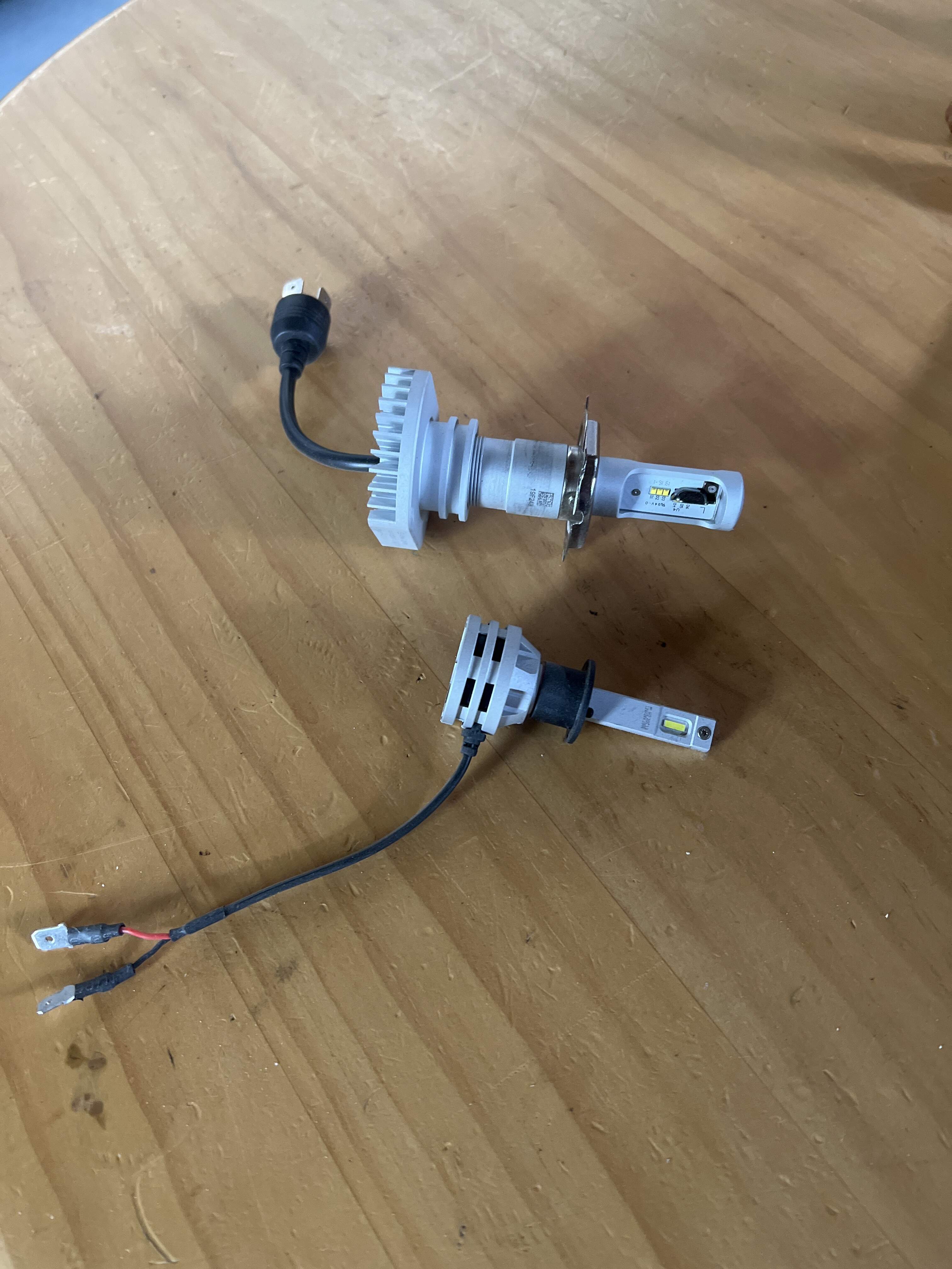

And here are the led I used . They are certainly the best but these where over $100 each

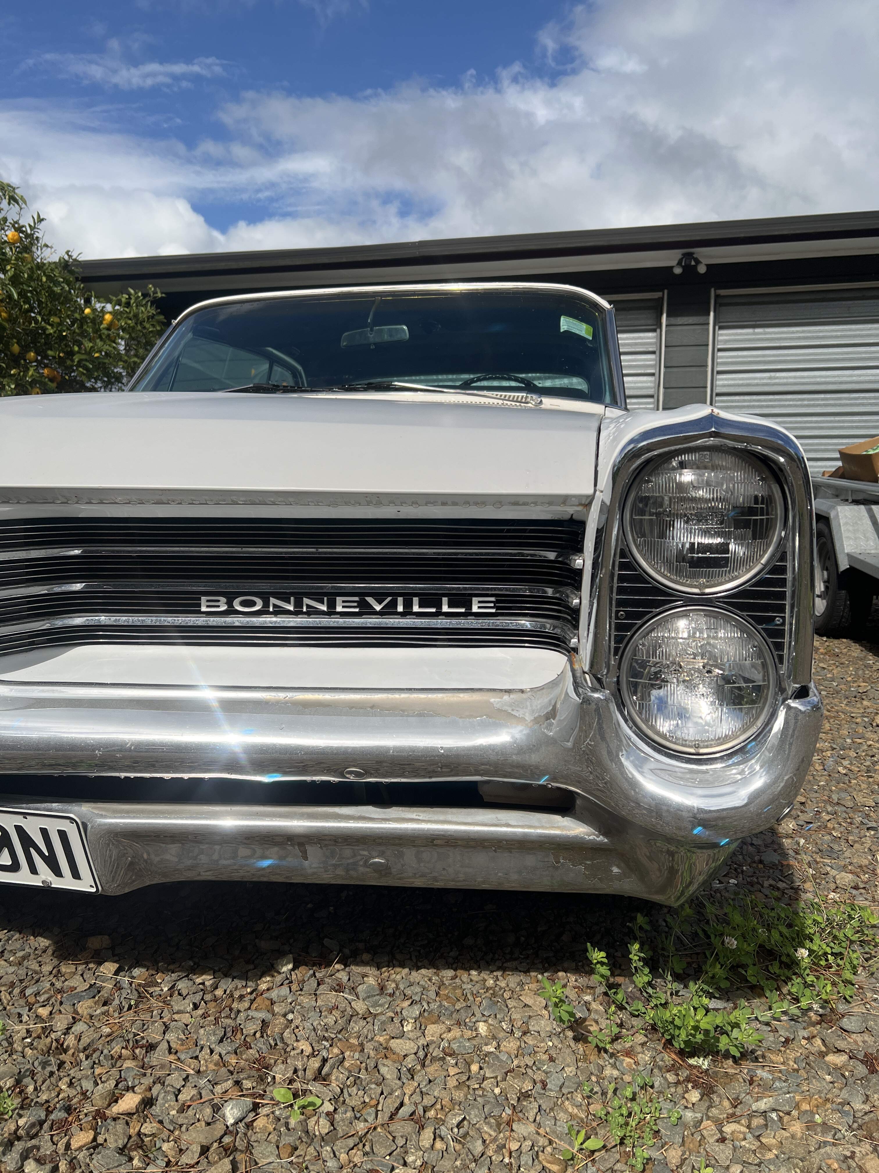

I have stink seam beam ones in my Bonnie
till i can find some more cibie !!!:dancingpontiac:
