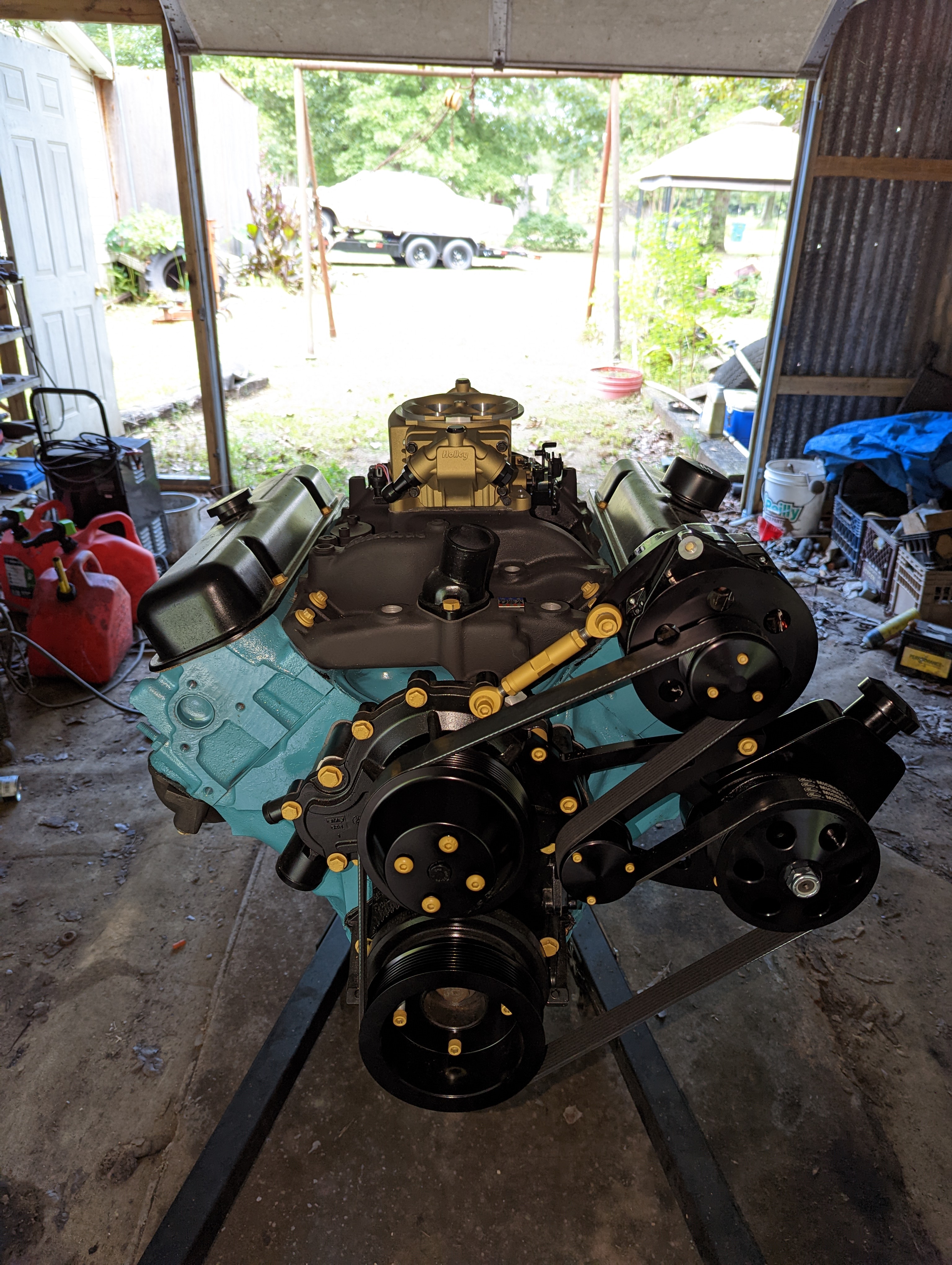

Hi matt, you have to tell use about the engine !, did you build it from the stock 389 ?
Started life as a 455. Bored .030 over with Keith Black dometops and Crower 60242 Cam, Edelbrock performer intake and RARE exhaust manifolds.  Will be sporting Holley Sniper Stealth EFI. Hoping it will be a fun street setup in this big car.  My factory 389 is in storage and will be kept for posterity's sake.

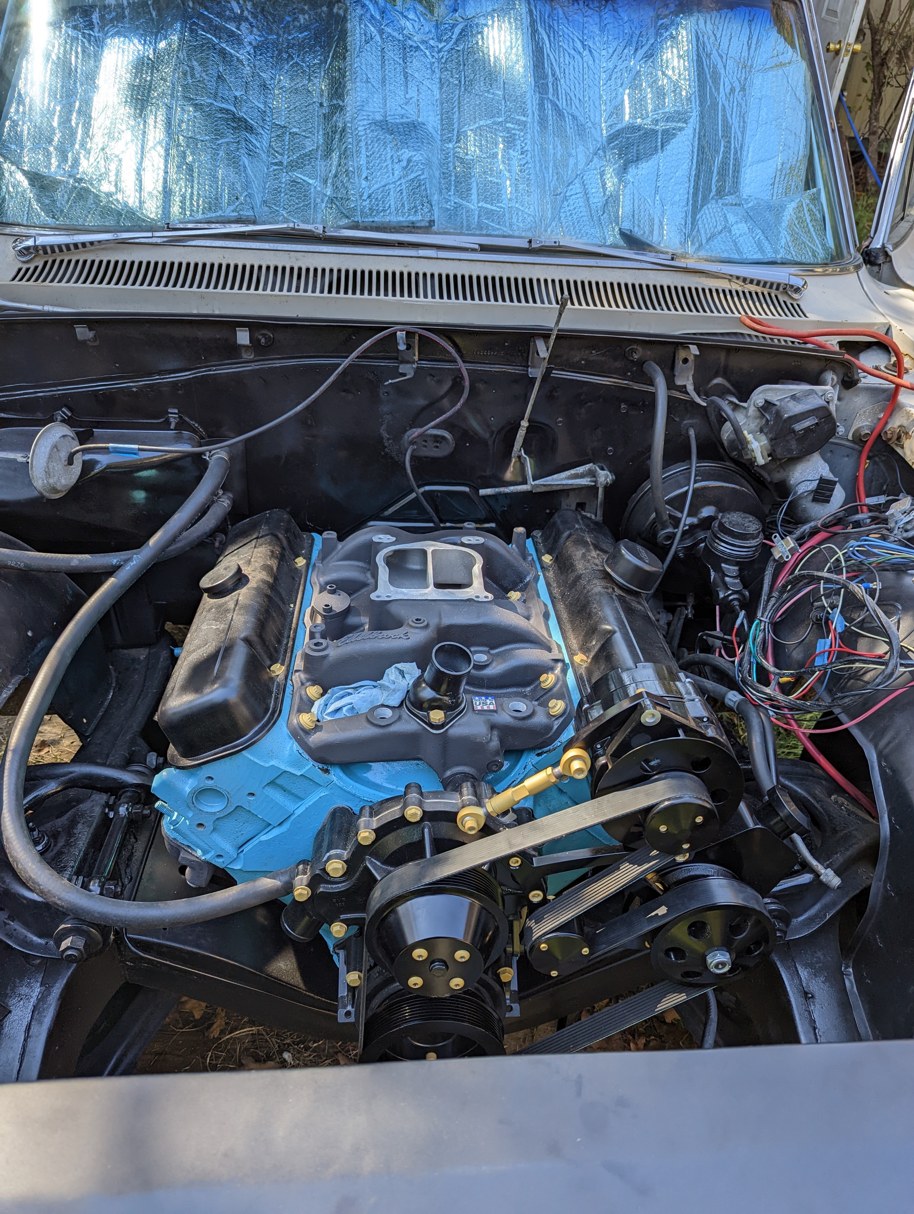

Was able to put the engine in this weekend.  Hopefully I will be able to get everything else installed next time I'm in from work.
Nice! Congrats!
looking Good Matt :cheers:
Did you use the oil filter offset block with your long branch headers ?
Were did you get the serpentine belt kit from ?
I'm using the Ram Air Resto headers that are alot more accommodating than long tubes.  And I am using the 45 degree oil filter adapter and Ram Air Resto's extension block.  The serpentine kit is from CVF Racing.
