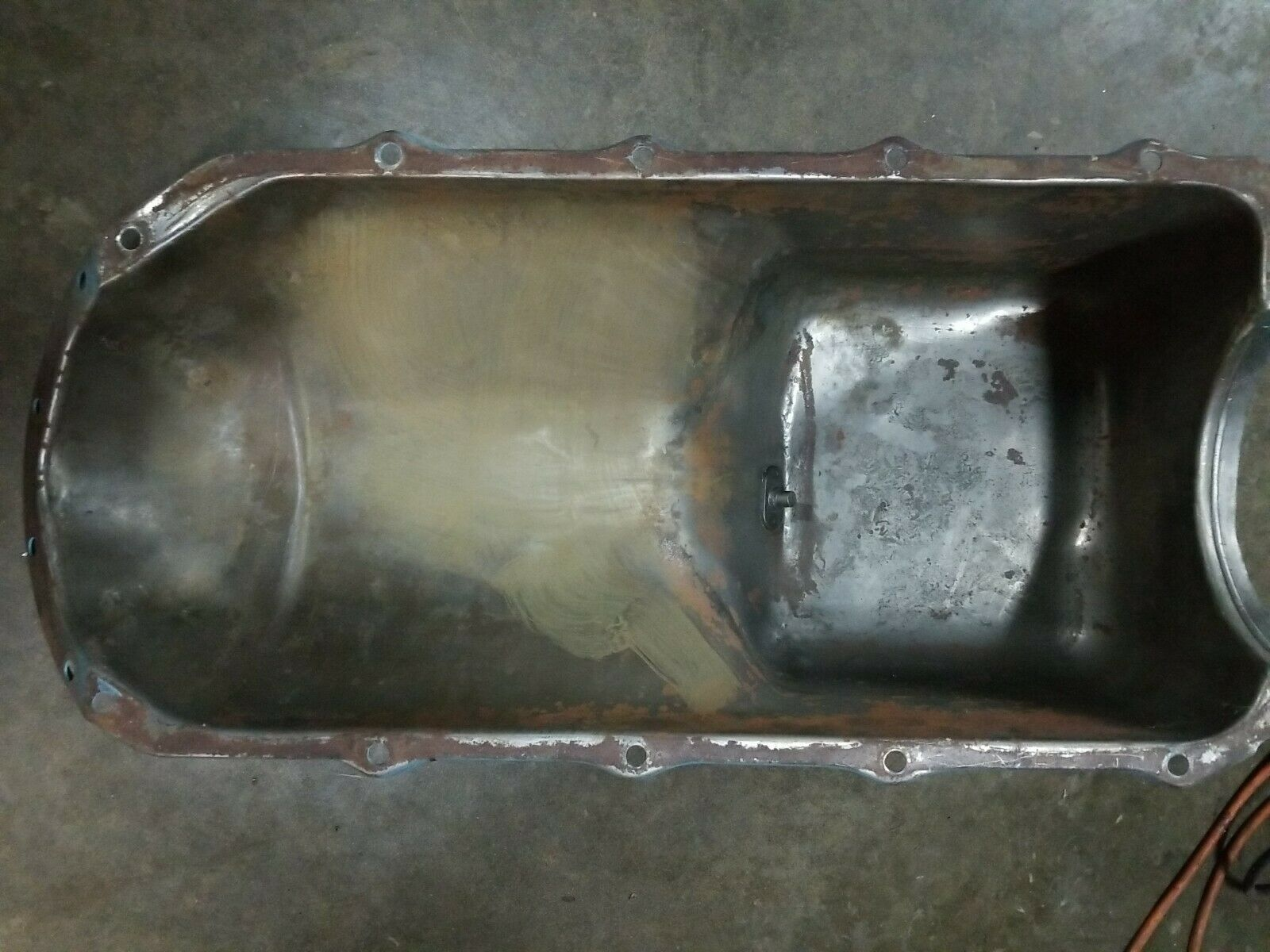

i have tried a 1957,1965, 1968 and a 1973....none of them will work....they either hit the small windage tray in the back by the oil pump.....or they hit the front  crank main cap bolts....or both.....soooooooo no not just any oil pan will work
the above pan appers to be what i need???? no sheetmetal spot welded inside the pan,for a baffel, and notice the dimples in the front for the main cap bolts

FROSTY....bONE STOCK BOTTOM END....ORIGINAL PAN WAS REALLY BEAT TO HECK....NO LONGER SERVICEABLE

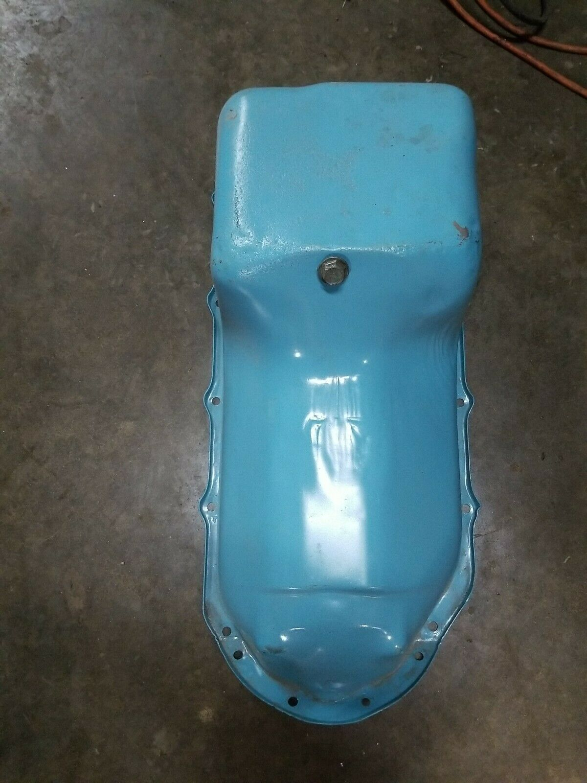

alan this picture looks justA like my 64 sump ! and thats a 389 no baffles
awesome !!!  im in contact with a person who has a pan like this...i think i will try it to see if it in fact will work
got super tired of looking and not finding the correct pan.......geeesch waht a pain

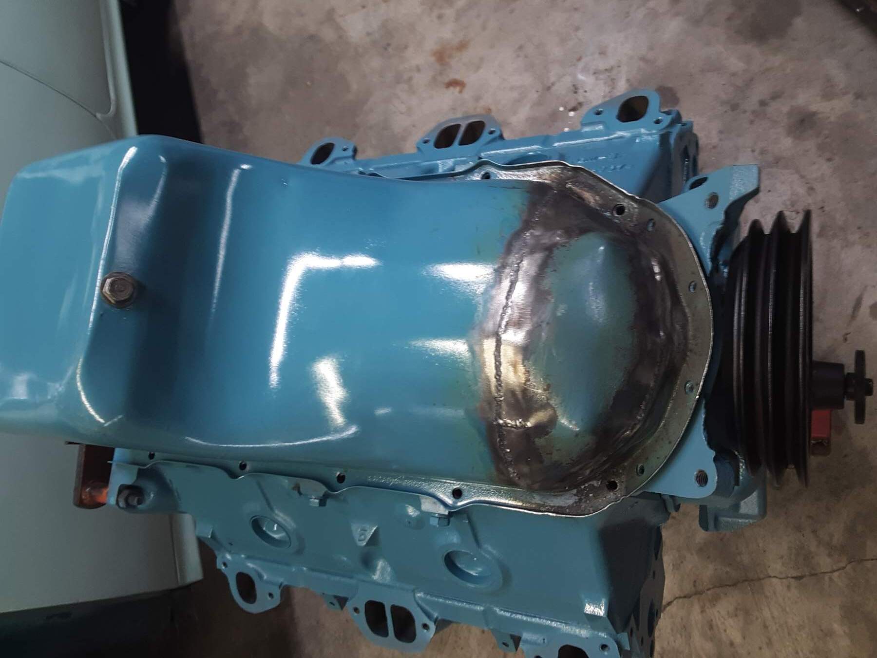

made my own

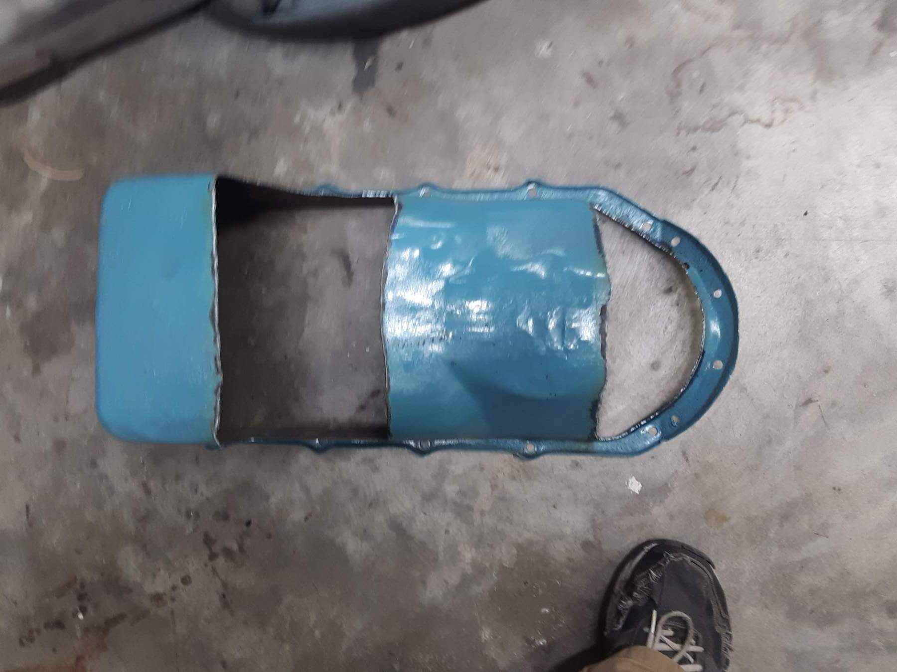

combo of a 1957 347 pan and a 1968 Catalina pan......fits perfect now.......ill get it blasted and a repaint!!!!
An ingenious solution - well done. I wish I could weld like that. I can glue metal together, but it's a long way from that level of workmanship. I really appreciate it when someone is forced to find a solution in the face of adversity - something anyone doing up an old car is all too familiar with.
I am of the same opinion as Fitzy on this handy work of yours Alan !well done ... nice panel work too mate:cheers:
THANKS GUYS !!!  The carved up pan? i was going to pitch....but then discovered its really very nice to use for "clearancing" the oil pump pickup !!!
