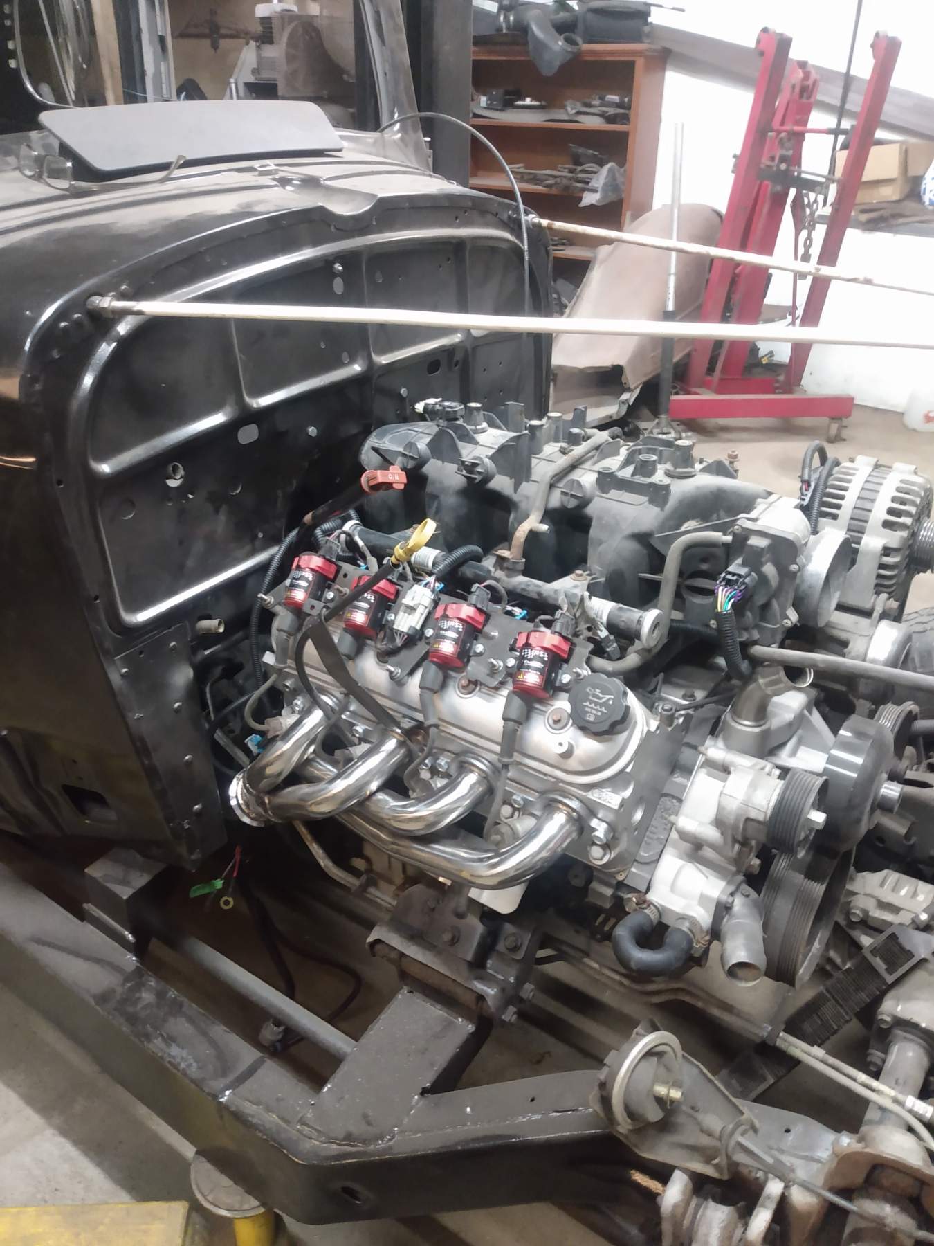

The LS moto can actually be seen. It isn't hidden by the wiring bundle this time around. Have you done any work to the motor and transmission at this point too? Or is it still just being used for mock up at this point?

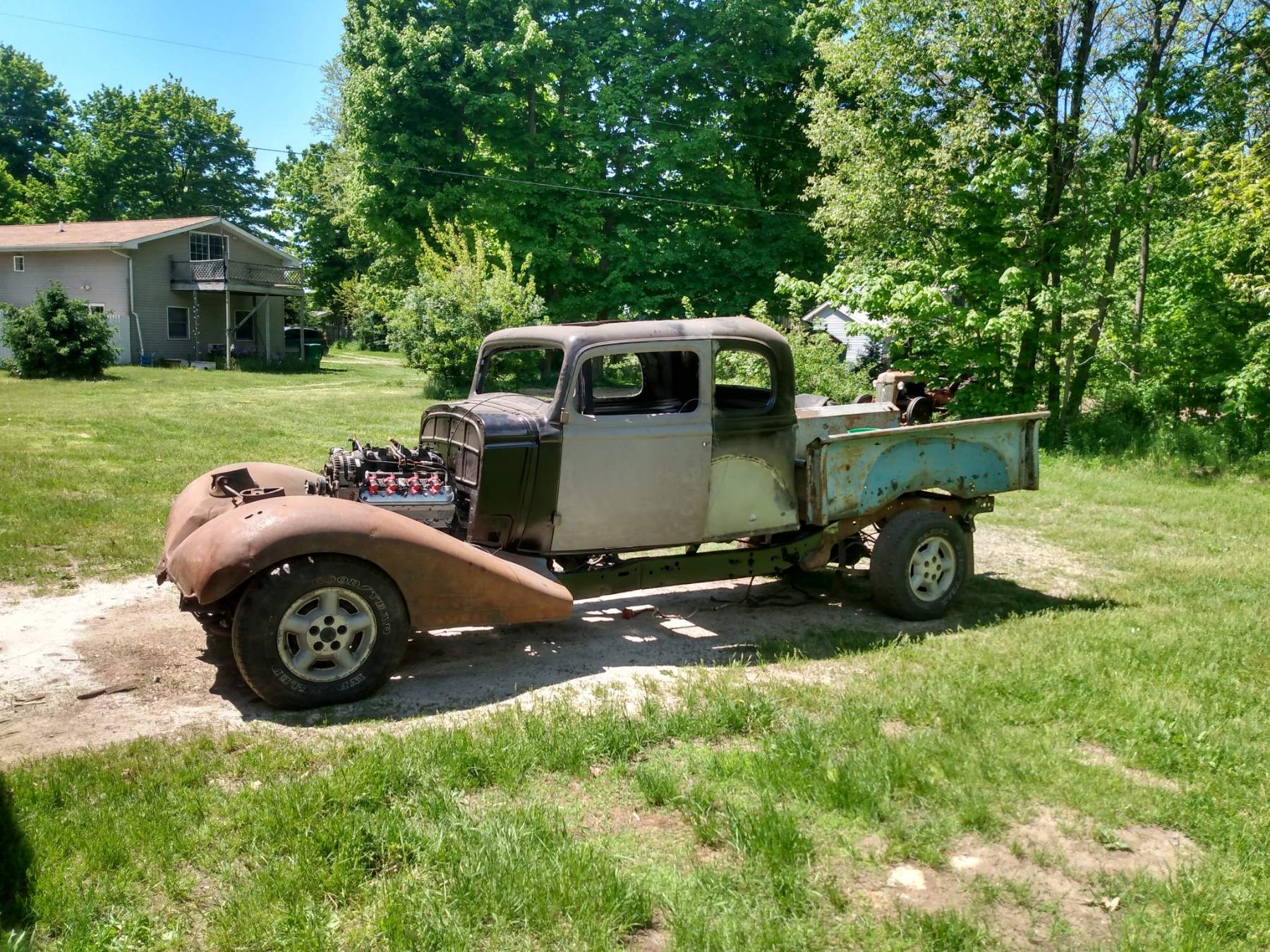

    Picked up as a 4 door sedan in Kansas

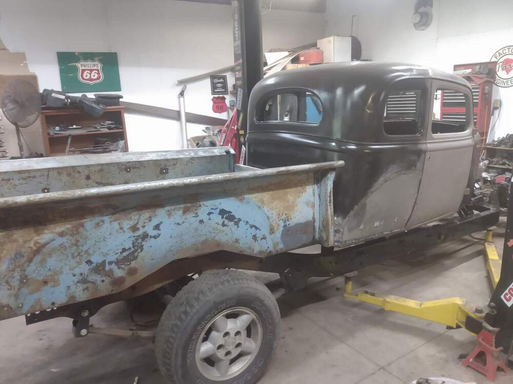

    Made some progress! Looks like I will have to stretch the chassis about 12". Still tacking and aligning the extended cab section.

    It is officially an extended cab now!

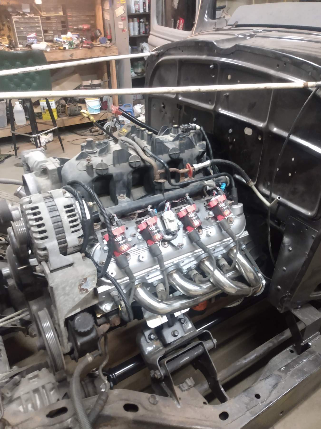

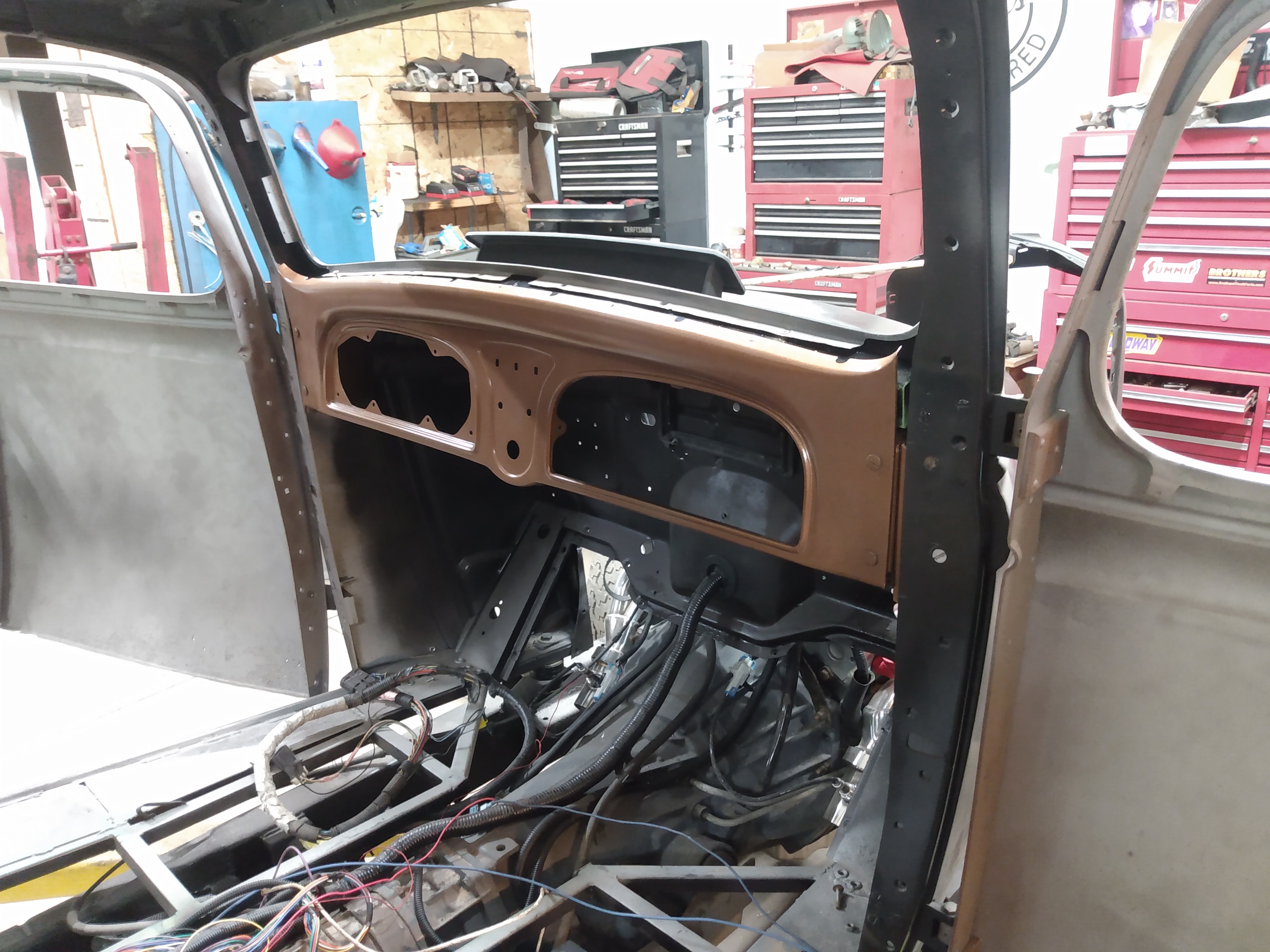

Thanks Frosty! I just cleaned up the heads and lapped the valves. new oil pump and front and back seals/ gaskets. I'm reworking the original harness as the only affordable harnesses don't include some things and none have the transfer case low signal. The finished harness will sneak everything up the back of the engine and fuse block/computer will be inside the cab.

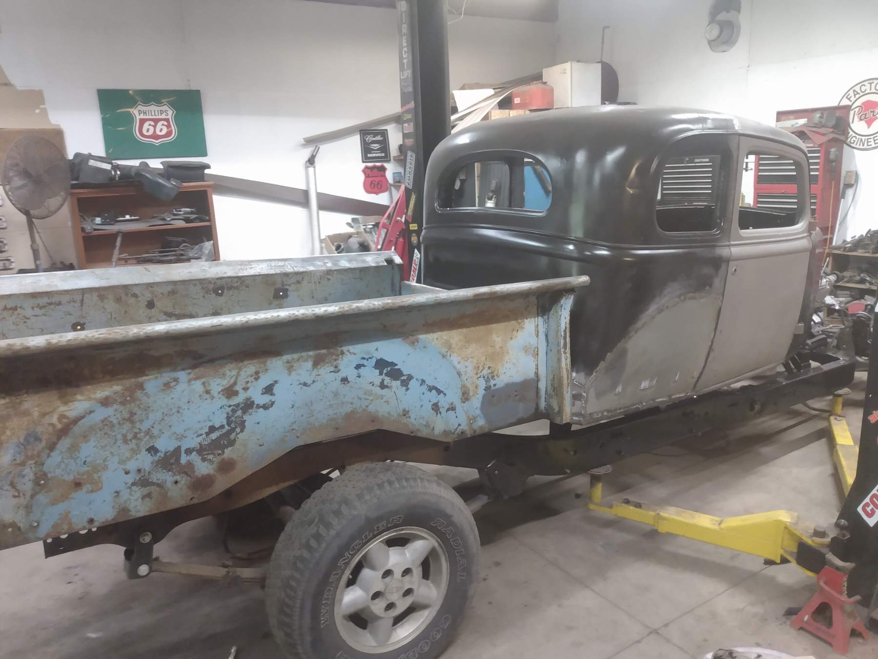

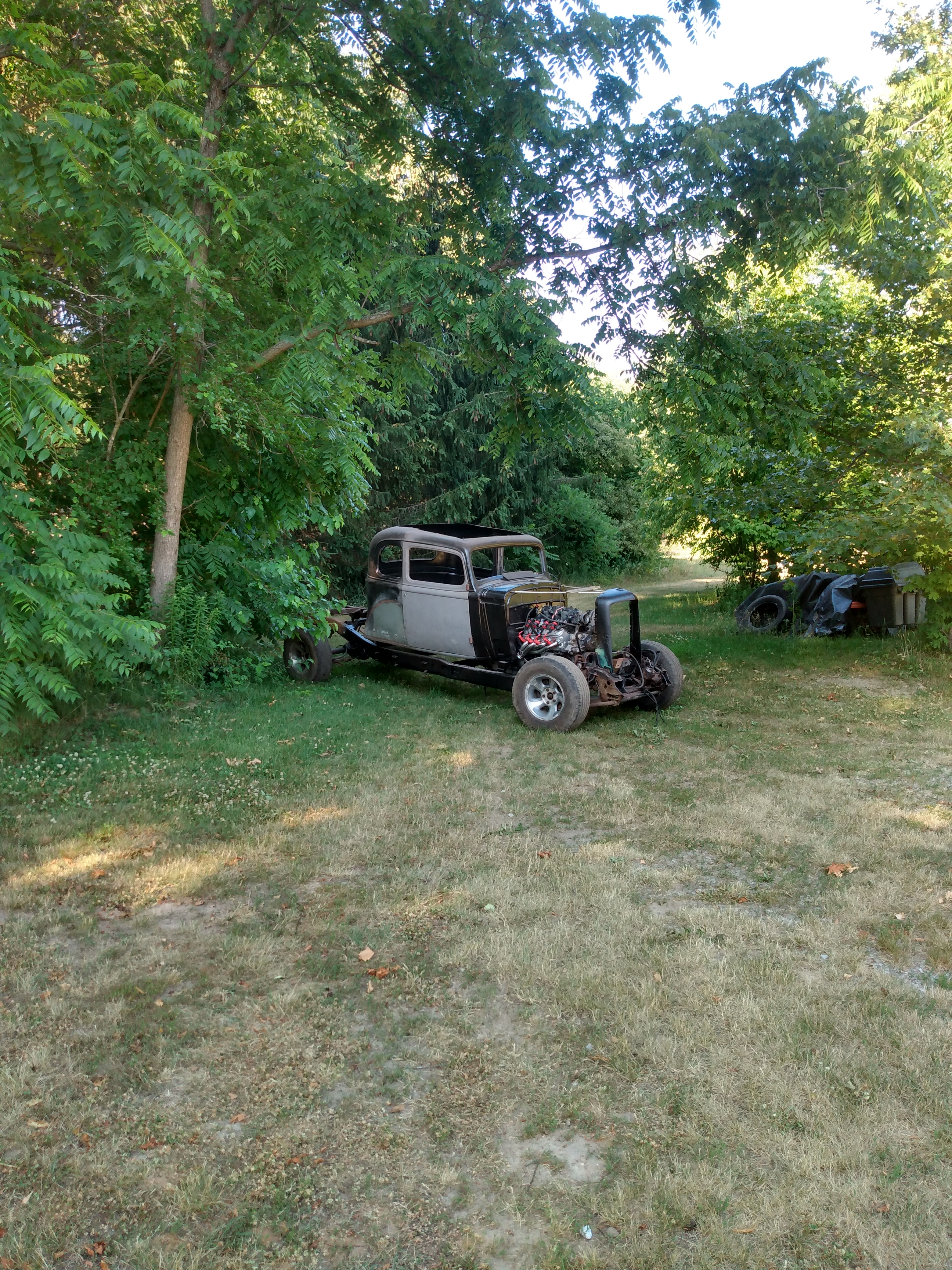

And today: it's a truck!

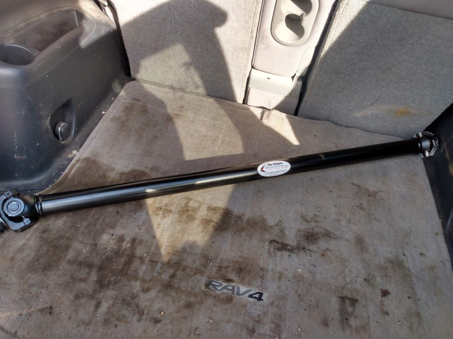

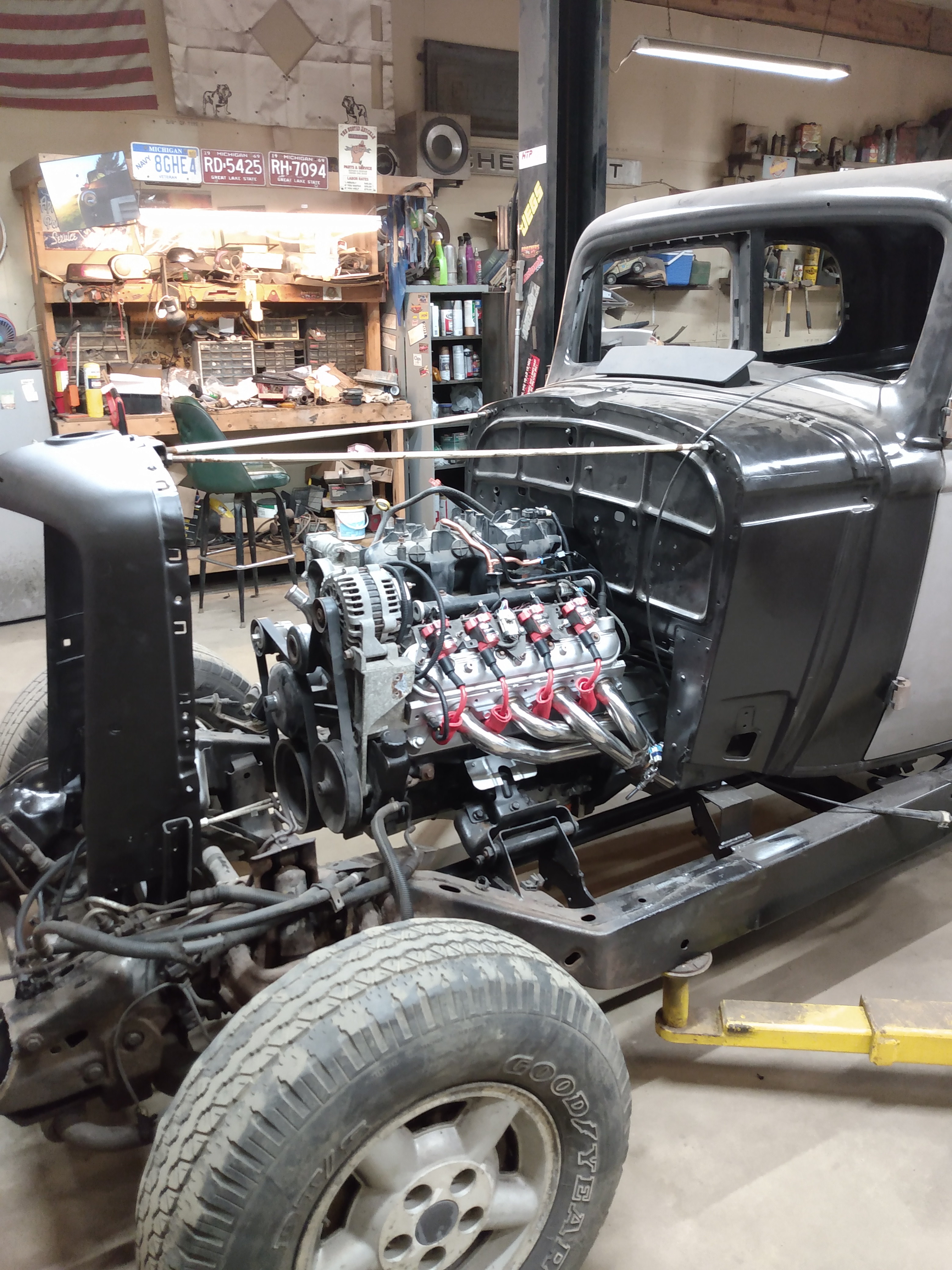

Body is back on, new front driveshaft is in, finally found a set of headers that fit, and engine is wired.
Bed and fenders are not mounted but here is the basic idea. it will have the hood, running boards and rear fenders at some point.

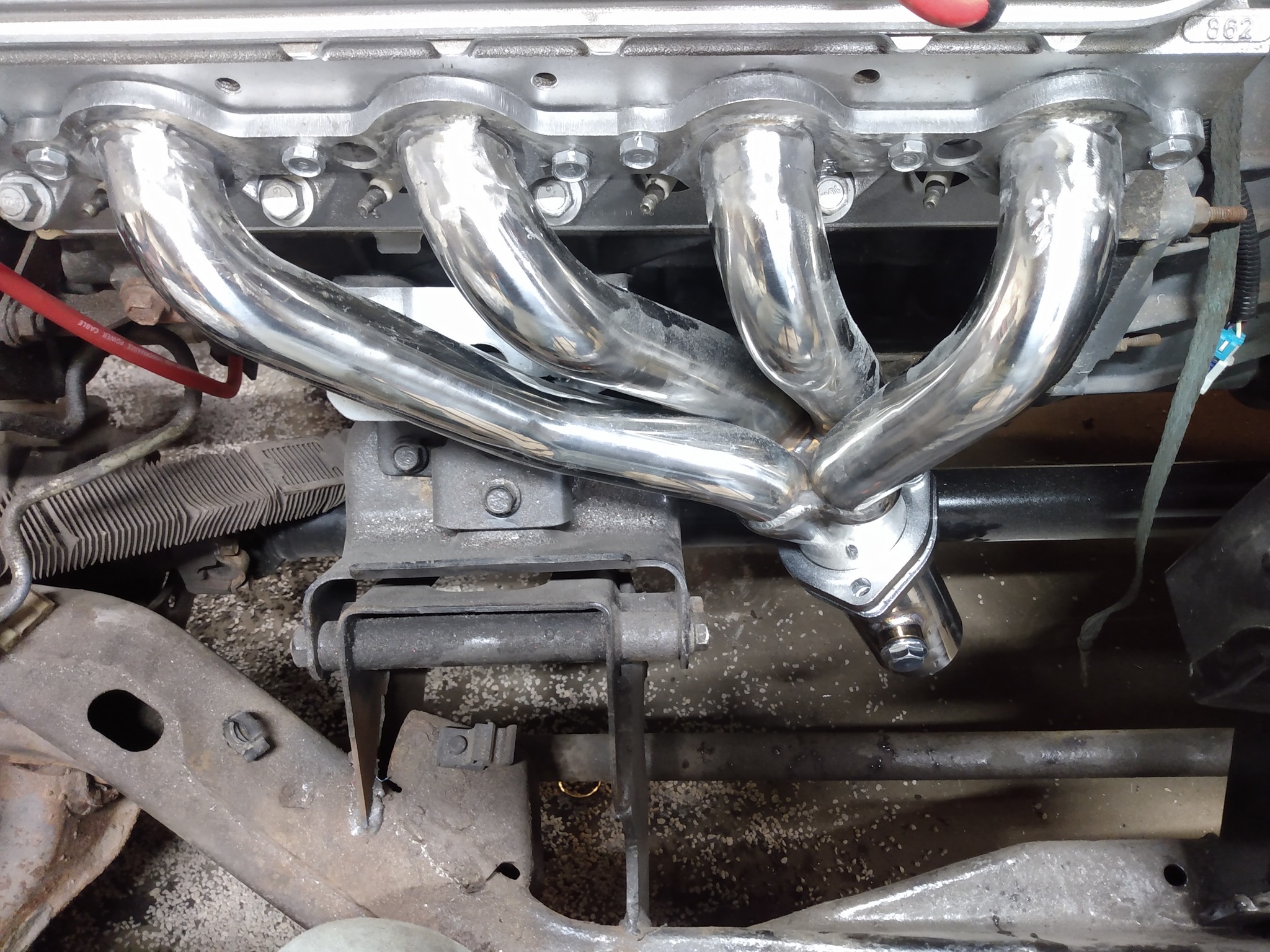

some progress. last pic is the header after cutting it apart and reshaping it to fit between the driveshaft and torsion bar.
