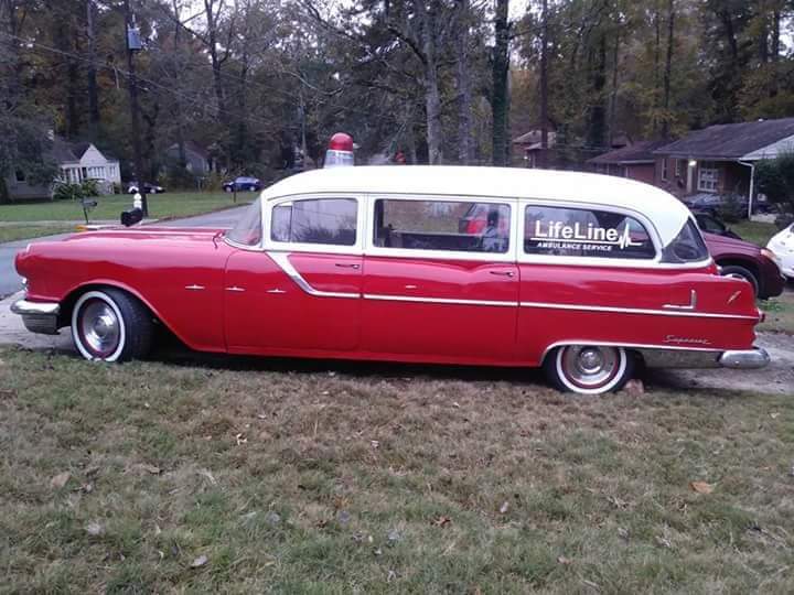

1955 pontic in atlanta i need a good repair guy
My transmission is going in and out of gear nonstop while driving its a dynoflo

Cool car...Hate to see that you're having transmission issues...I have a couple of questions....First off I'm not trying nor do I want to come across as being a smart ass..or condescending in anyway shape or form... So please don't take it that way...I also don't want to put up inaccurate Info if at all possible....
Are you 100% sure that the trans is a Dynaflow and not a Hydramatic..Or a Powerglide...??
I ask this because Dynaflows were exclusive to the Buick brand and were only used in Buicks...The exception to this is when there was a catastrophic Fire (Burned to the ground) at the Hydramatic plant in Livonia Michigan that shut down production for an extended period of time in the fall of 1953..As a result of that...GM had to scramble to come up with an automatic transmissions for use in cars that were supposed to be equipped with the Hydramatics...So they hastily reengineered the mounting points of the dynaflow trans case for use in other GM cars...They were for sure used in thousands of Cadillacs and Oldsmobiles in 1954 and possibly into early 1955..If you bought one of those cars they came with a certificate that would allow you to take the car back to the dealership and have the Dynaflow swapped out for a Hydramatic free of charge...Once production restarted and the supply chain was up and going again...Automatic trans (hydramatic) equipped Pontiacs of that same time period used the cast iron cased Chevrolet sourced Powerglide...Instead of the Dynaflow...The Powerglide was adapted to the Pontiac engine via a steel band adapter plate about an inch or so thick so it would bolt up to the Pontiac engine block...As with the Oldsmobiles and Cadillacs the Pontiacs also came with the Certificate to swap out the Powerglide for the Hydramatic free of charge..The seperate steel adapter band between the engine block and the bellhousing remained afterwards and continued to be used on the Chevrolets equipped with the cast iron case  Powerglide transmission until it was updated to an aluminium case in the early 1960s...
If your Pontiac 100% for sure does have a Dynaflow...Instead of a Hydramatic which may or may not Be possible..?? Since it is on a commercial type chassis and could be or not..??? More closely related to the very early 1955 producton Cadillac ambulances and hearses..?? Than a standard Pontiac station wagon...
