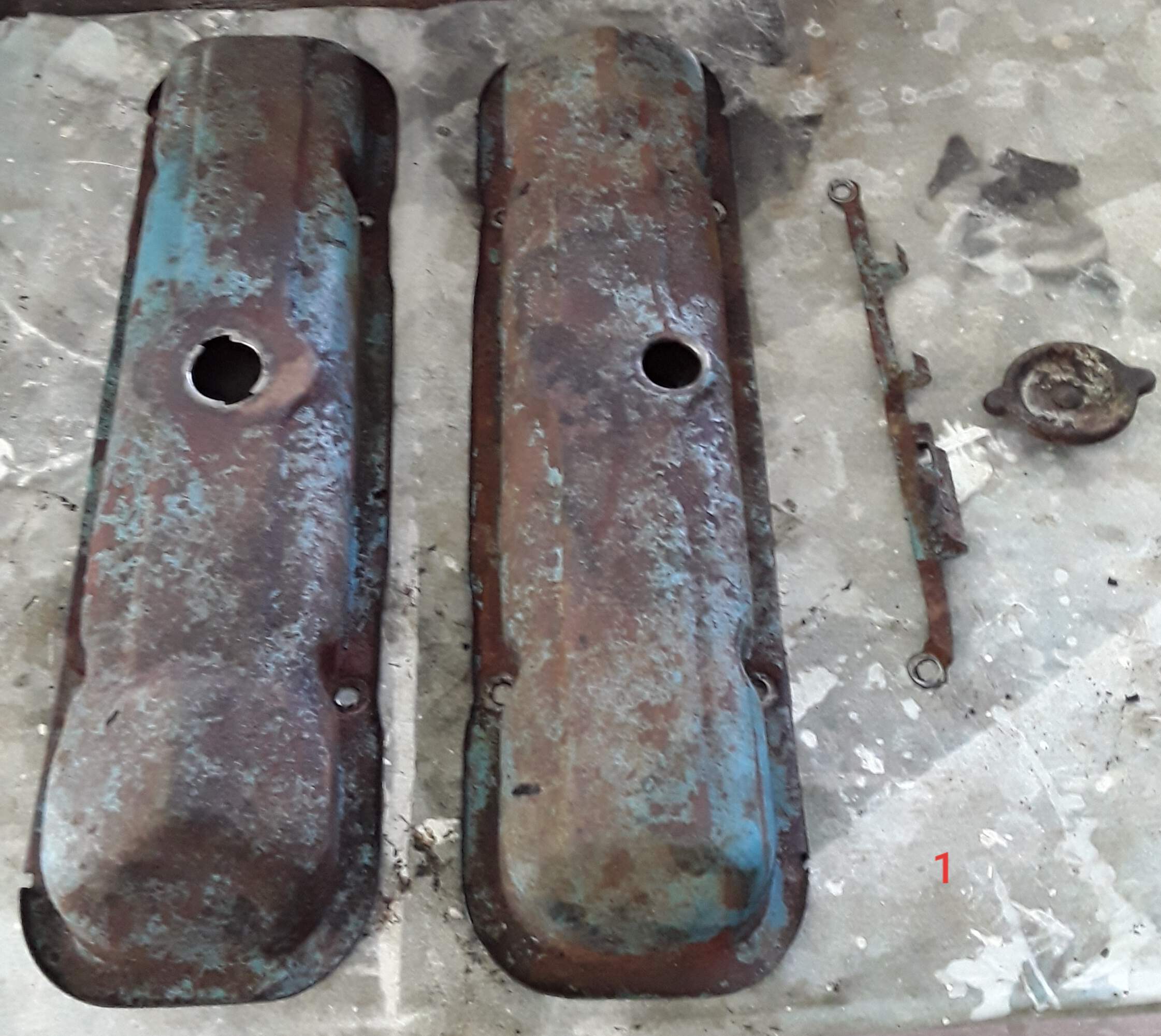

Welcome Everyone to Tightass Tricks, with Fitzy. Thanks to the ever plummeting Aussie peso plus the fact I'm TIGHT, here is my latest mini project: valve cover rejuvenation.

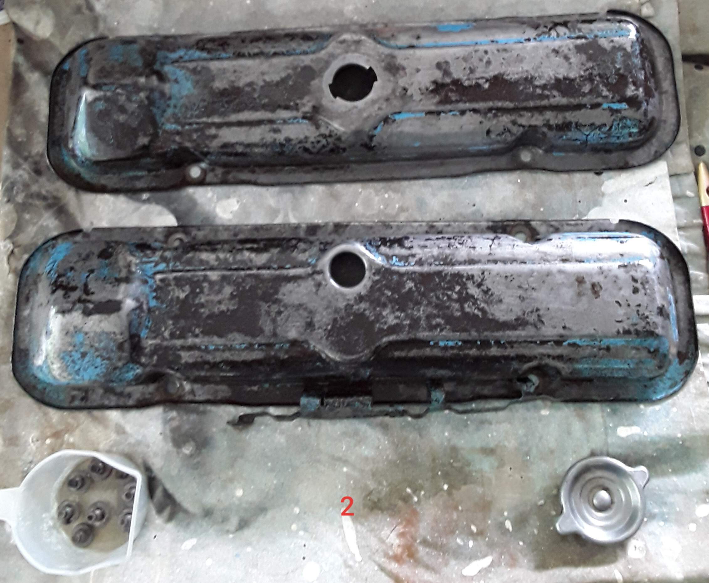

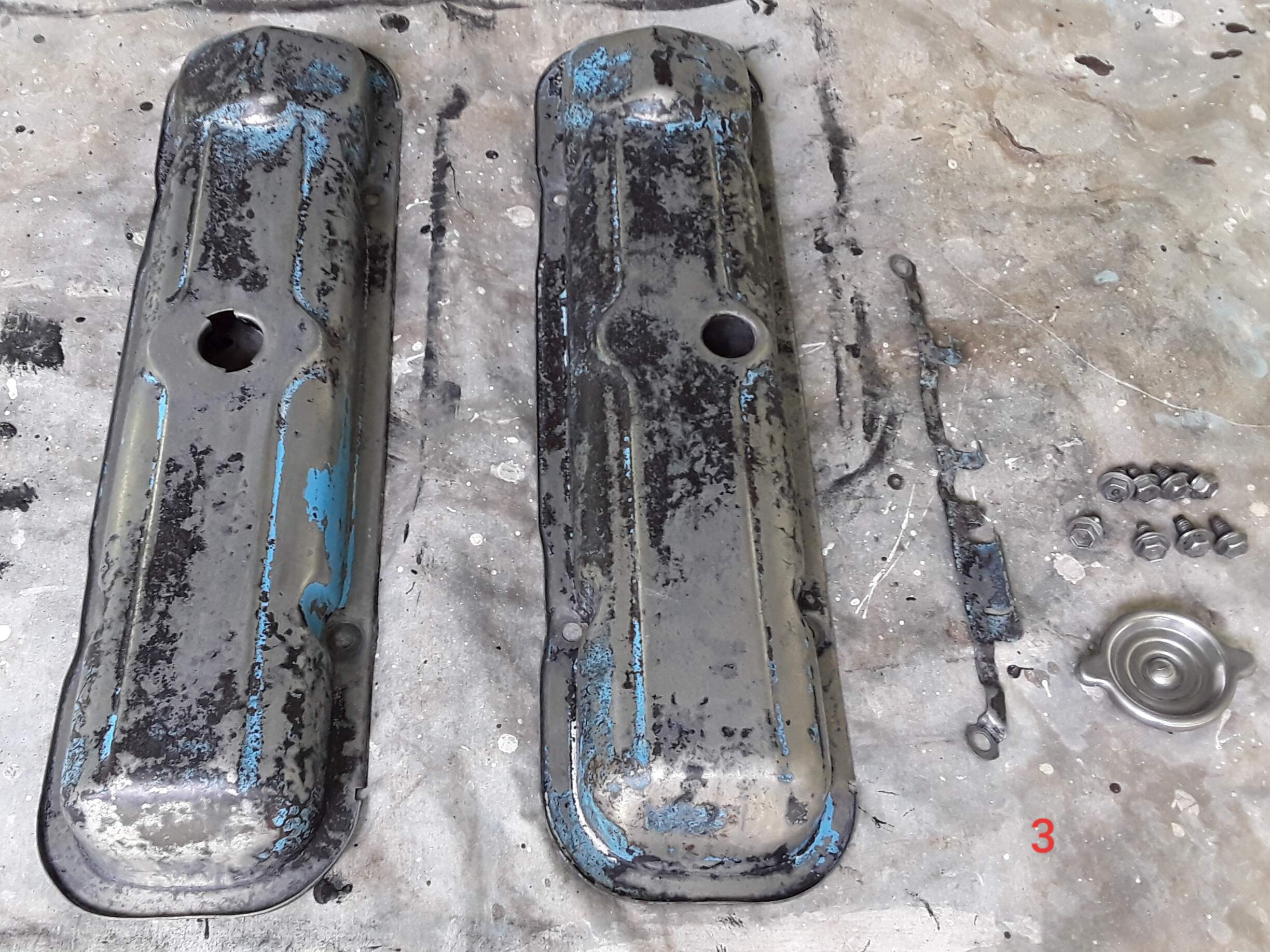

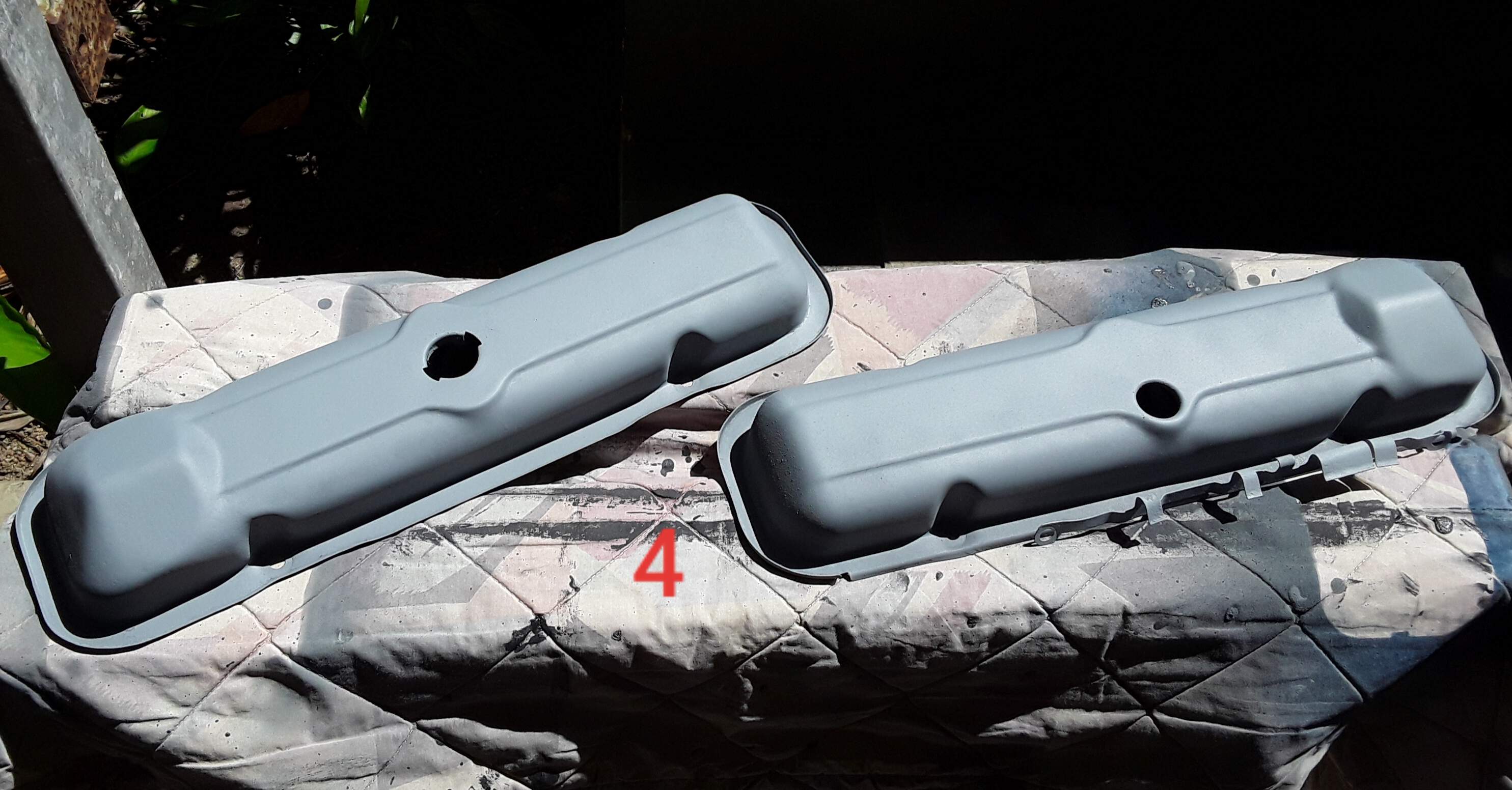

As you can see, they started off looking terrible. I wire brushed them, then 80 grit, then 400, then I converted whatever rust was left, wet 1200 (at this point, if I was building a rat rod, I would have clear coated them and job done) then VHT primer. Once finished, I'll post a pic of the final result. They are gonna look great. I polished the oil filler cap and the retaining bolts, just to provide a little variety amongst the blue covers. Total cost, incl. paint, sandpaper & rust converter - about 50 Aussie pesos, that's roughly US$30.20200422_120810.thumb.jpg.91af48a0b64c4fe086ed47752500bb7b.jpg20200422_120852.thumb.jpg.48a3f2ebef9776d2573b6699d9748e29.jpg20200422_120926.thumb.jpg.af3081f7539d5e7030dcba101599b23a.jpg20200422_132701.thumb.jpg.e31e871aeb83fef660815ee5278345c6.jpg

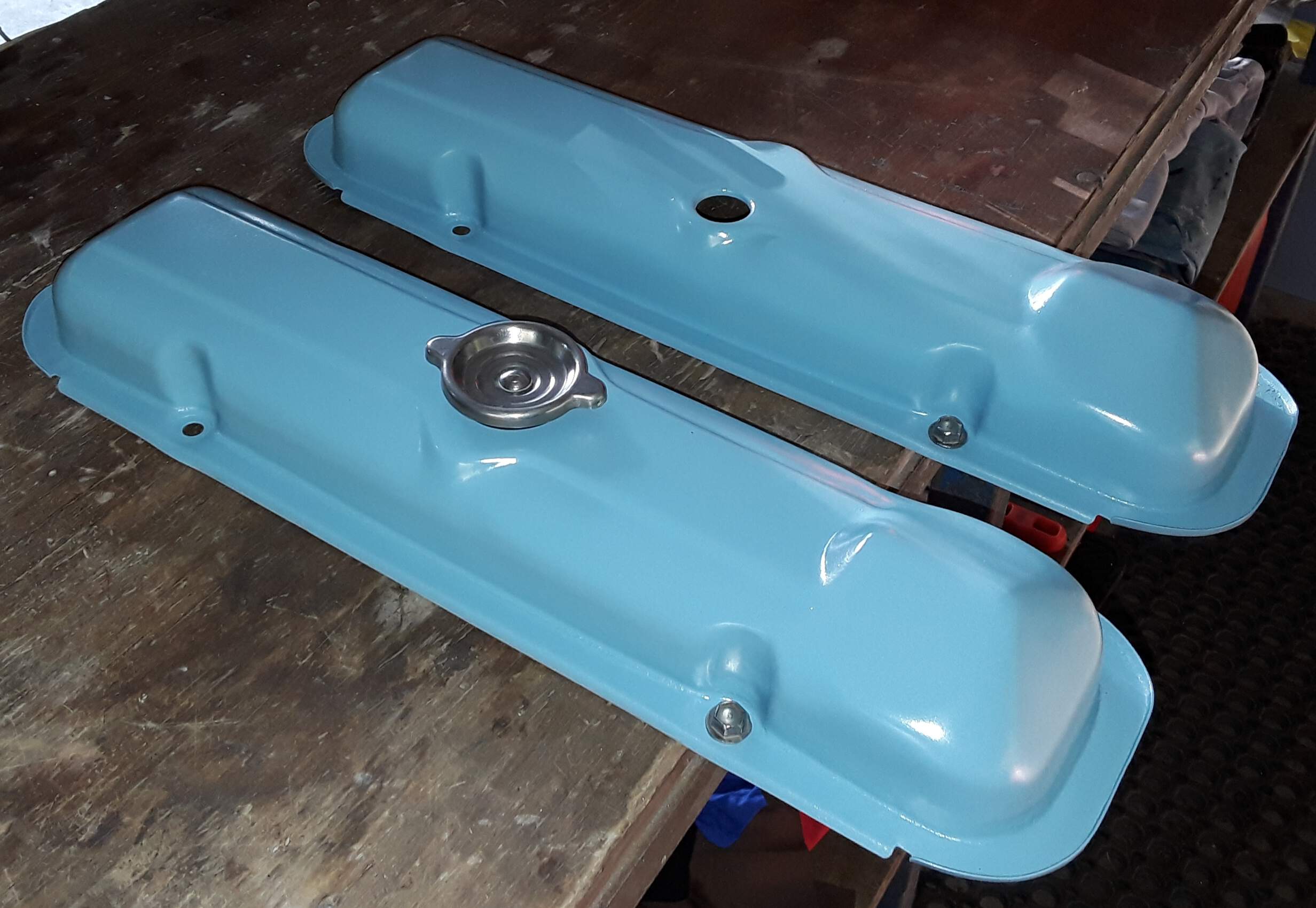

Okay, here they are. NOW I can pop the hood and stare lovingly at my freshly painted valve covers. All I need to do now is whip out that little 389 and unbolt every accessory and sand & polish everything until it gleams. The engine runs sweet but I have yet to perform a compression test to see where it's at. I figure that if it needs a rebuild, I might go all out and chuck in one of Butler's 420CID stroker kits. Like Wrongway said - gotta make it mine!20200424_173749.thumb.jpg.f2dacd8e035e75226b46779c449e3838.jpg
