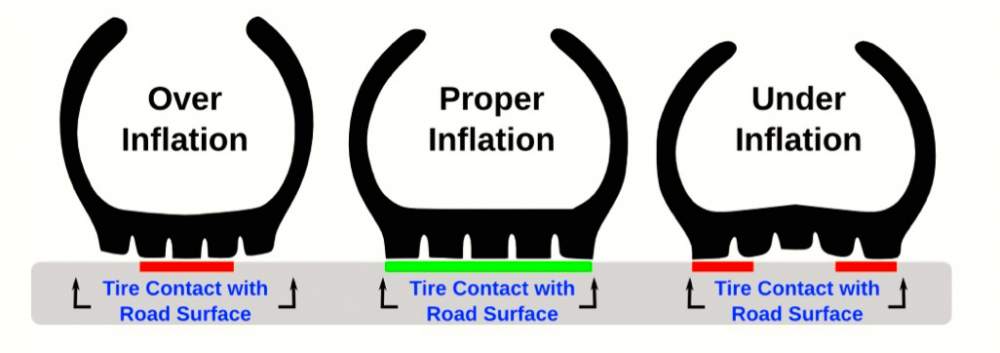

What is the maximum cold inflation limit of your tire? It's on your tire. It's usually not a good idea to inflate them to the max because as the tire heats up, Charle's Law says this will increase tire pressure.
Also consider what over inflation (or near over inflation) can possibly do to your contact patch.

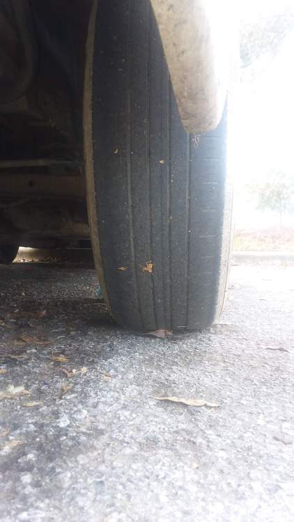

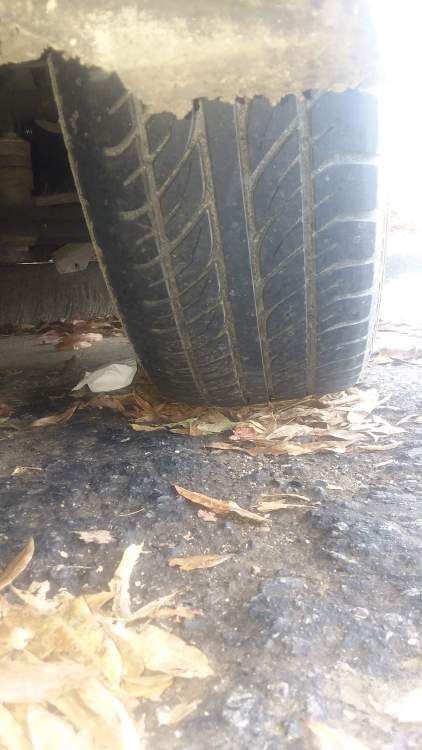

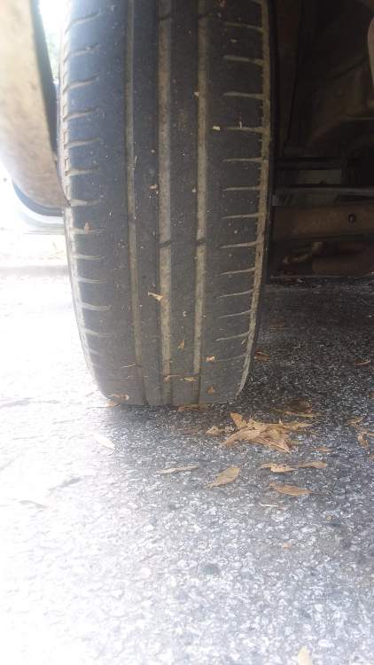

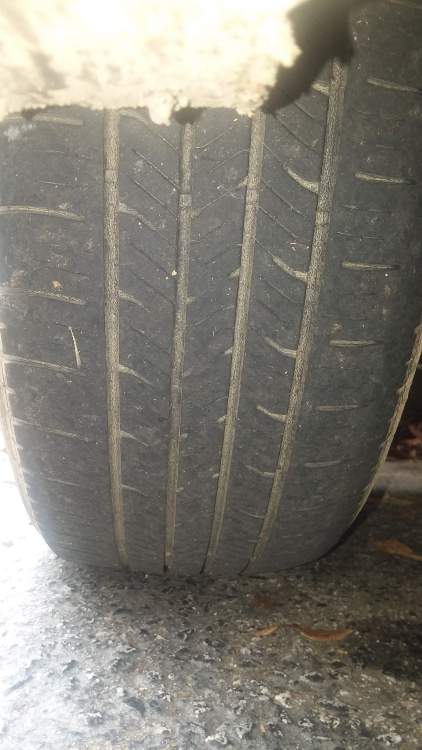

So here is a good one. What causes all tire to ware out on the inside track front and back. The shocks seem good. Like if I push down on car it stands up and doesn't shake or anything. The car drives like an arrow. Like on a almost perfect road I can let go of the wheel for close to a mile with no corrections. On non-perfect road it will go right or left...????

There used tires and yes they get moved around lol.  The outsides of tire ware fine it is just the insides of front and rear ones. Like this /------\ is how they sit not that extreme tho. Ill get some pics up soon
Ok so it goes top to bottom pics RL FR FL RR don't ask why I took pic in that order
My guess would be either a severe alignment problem (toe-in/toe-out), drag link (loose tie rod end, idler or pitman arm or center links), or possibly some sort of bad ball joint problem based on the wear on your tires. You may also have a camber problem based on the way your front tires lean.
Take it to a reliable alignment shop and have them diagnose all your front suspension woes. I suspect you probably have more than one.

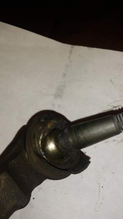

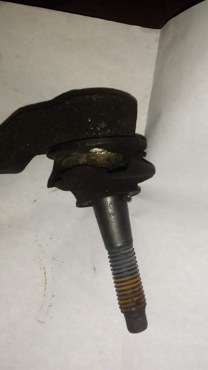

Yep like u so said. Tie rods where shot and bushing .... Car now turns scary sharp. This whole time I thought the car had great handling well come to find out it didn't. Next up ball joints and a wheel bearing or two. Question the oil when I drained it had like a glitter look. Not bad just like I could tell there was metal wear ... No flakes no large pieces oil was still amber on the stick. I had to look closely with a bright flashlight to see what was in there anyway. What do u all think?
They do look pretty well used up.......

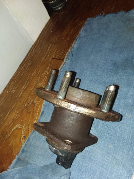

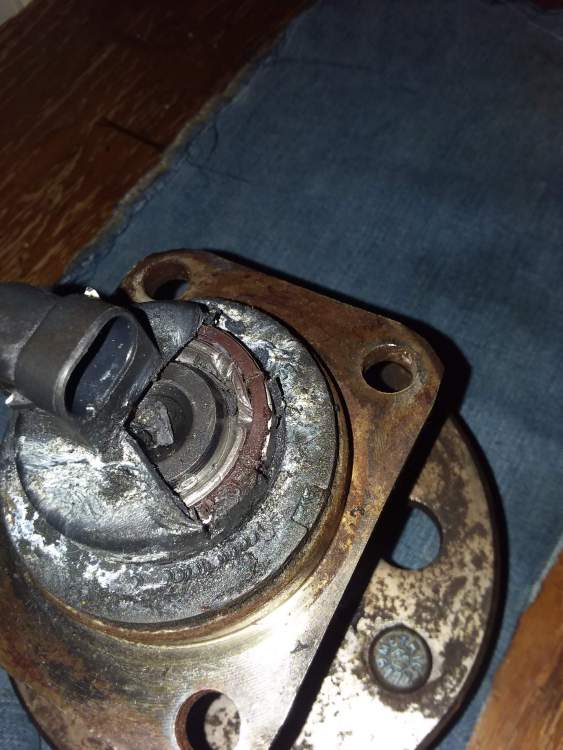

Found a good reason the rear left tire was messing up. Wheel hub/bearing was cockeyed and also bearing itself was wearing and drying out. The tire on RL would always look like locked up the breaks on the inside at just one spot and the rest was fine. So I guess it wobbled in motion. The hub had very little play when i changed it.
Thank you all for your help and input. More to follow, over and out!
