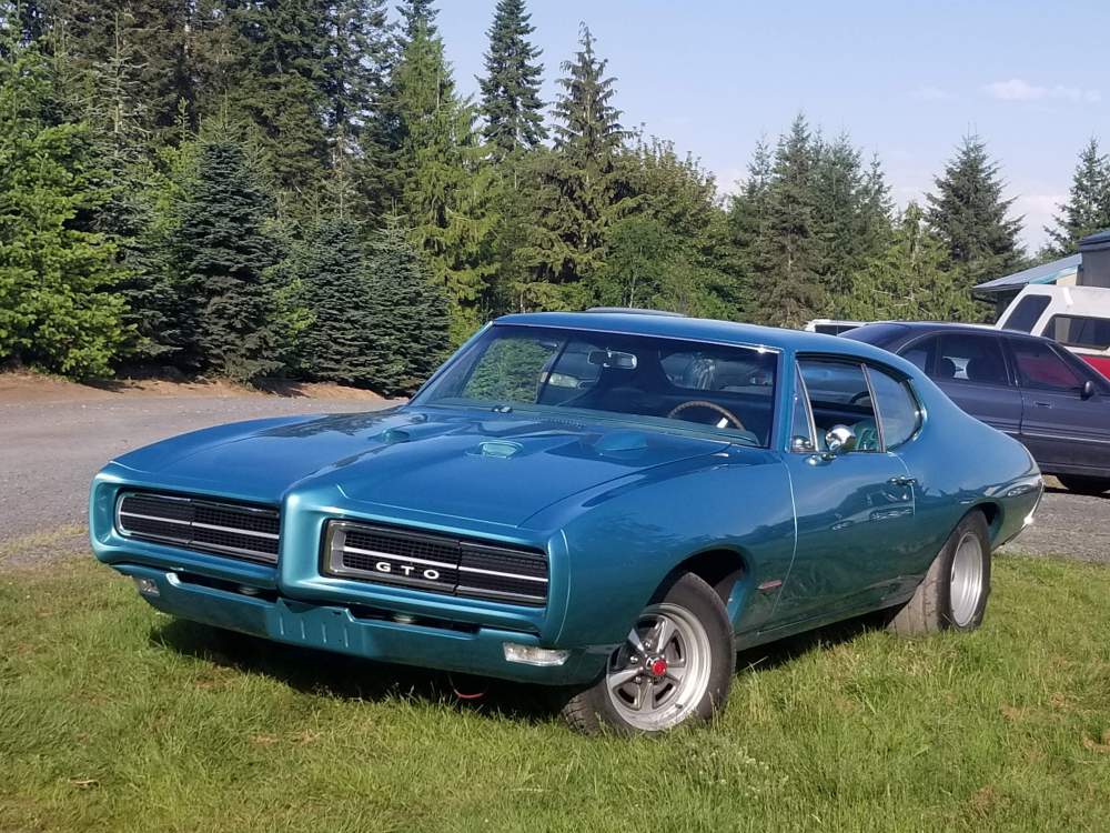

On 8/20/2018 at 9:42 AM, Ant said:
Here's my 68 its now got a 468 with Butler ported heads and a T56 magnum 6 speed. My 6 yr old always want " just a little burn out Dad" when we cruise it!!
with all the beautiful cars posted here I'll not be surprised if i don't make the calendar!!!
Ant
Beautiful GTO! What color is that and did you upgrades the bottom end of the engine?
Thanks!! The color is meridian turquoise. I went with a scat crank and eagle rods with upgraded ARP bolts, also used studs on the mains. It runs great and has tons of power like most Pontiacs!!
Ant
