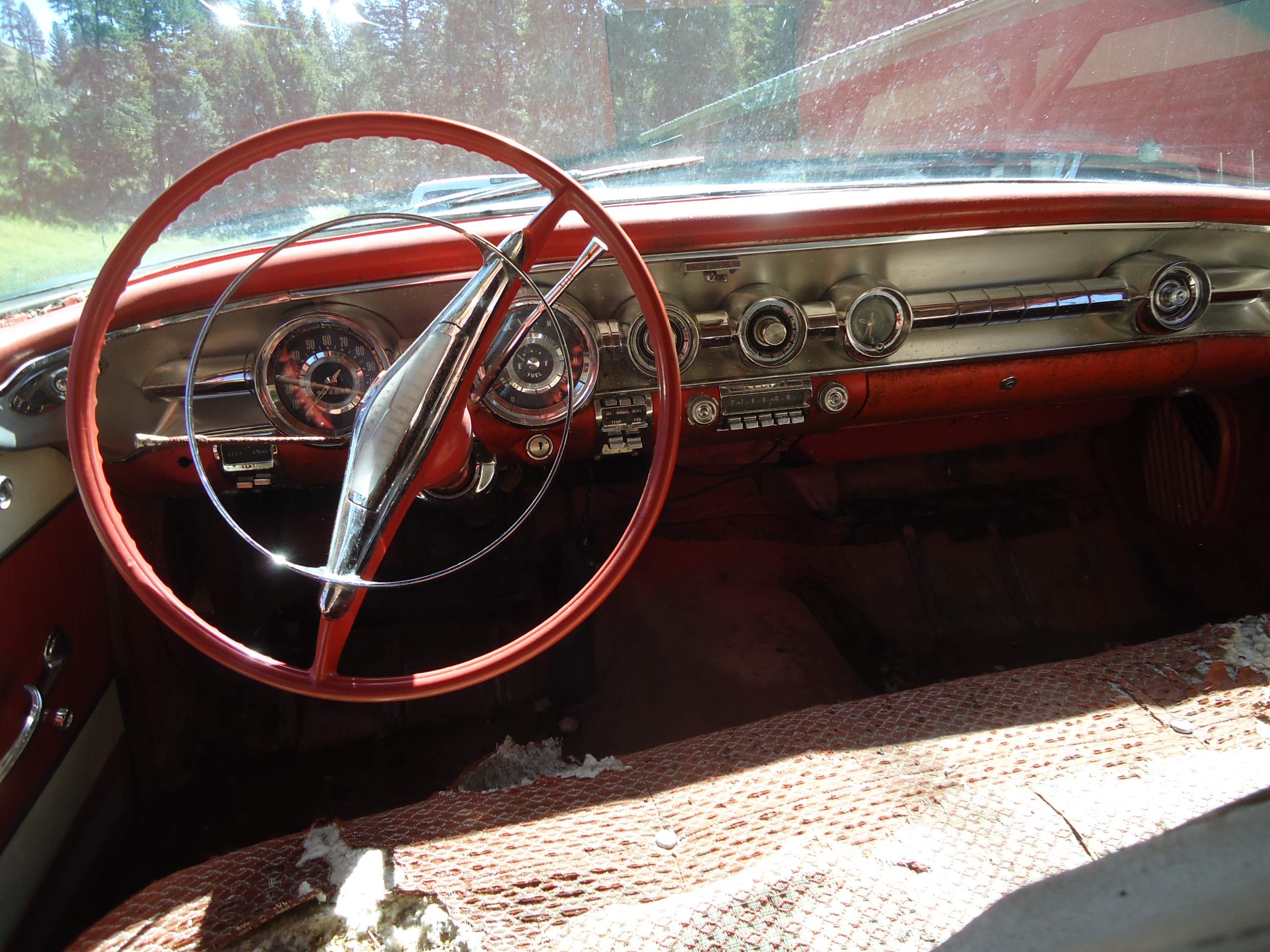

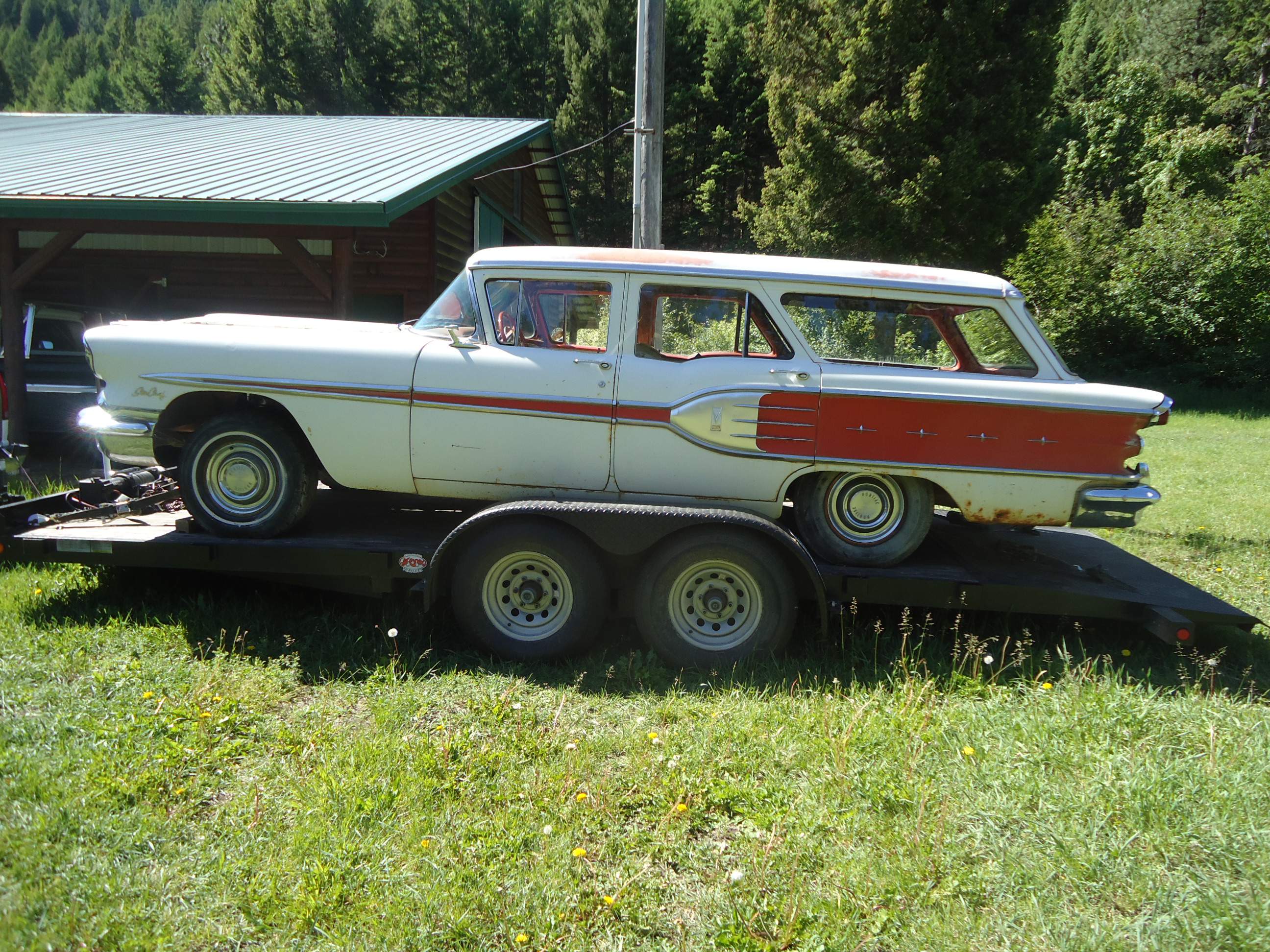

Here are a couple of pictures.  I don't think it is missing any trim or anything else.  I found a Pontiac 350 tranny today at a transmission shop.  The guy thought he might have a line on a motor as well.  This might end up all Pontiac after all.
WOW what a wagon! Welcome aboard, That's quite the project. Wagons of all years have really come full circle in the collectors world and are widely excepted now.
I think you'll be surprised on how somewhat easy it might be to locate a correct V8 power-train, but at the end of the day it's your to with as you wish.
