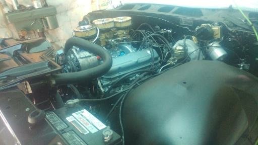

I'm finally getting somewhere with my Pontiac Bonneville convertible restoration so I thought it might be a fun thing to post some pic and see if others would like to also. Looking forward to seeing your progress pics, Bud. I finished the firewall forward, only to find that when I removed the windshield ( well it's self evident in the second pic. I have since repaired the damage but can't upload in this post. More pics to follow. Come on guys, Sent some of your progress.Bud

Engine compartment is lookin good.  Looks like you have some welding in future.

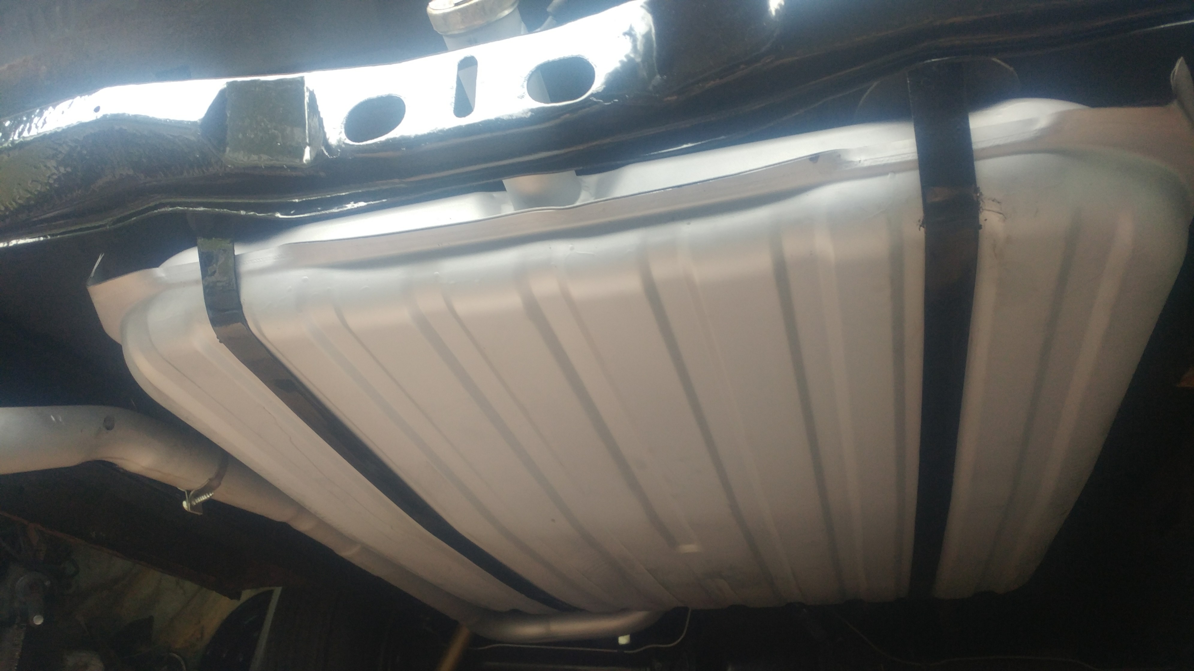

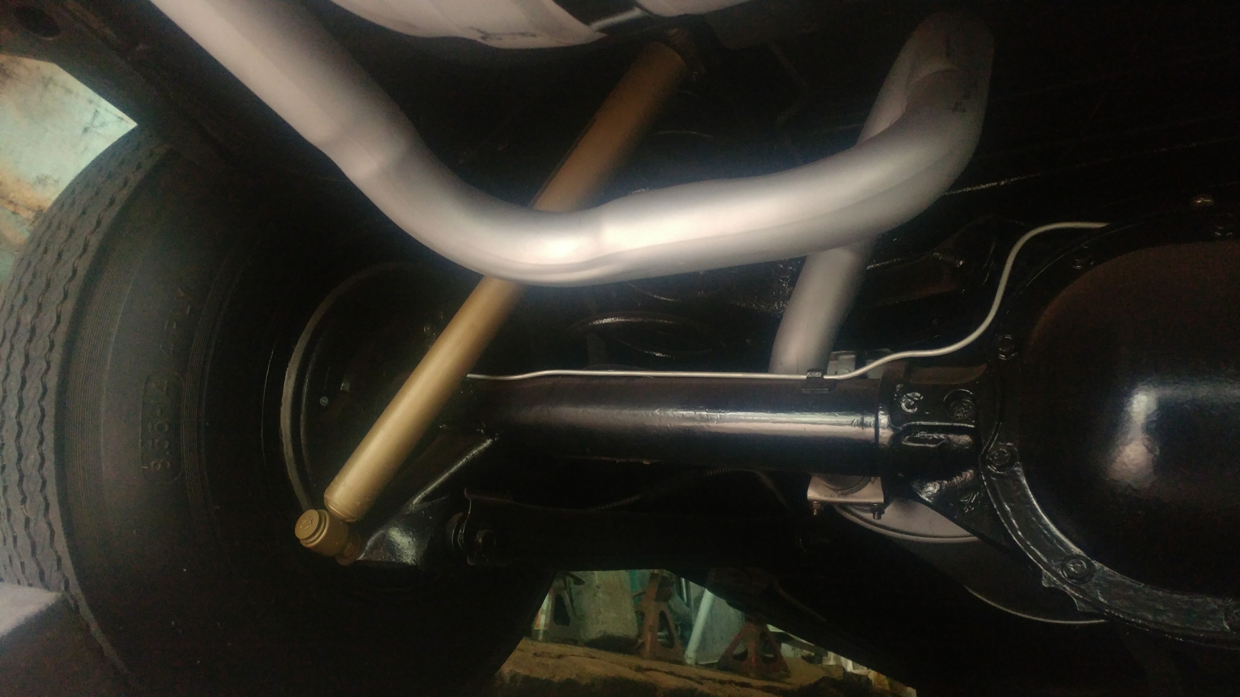

Got a converter. This side is done. I'm currently working on  the other. New tank refurbished original straps. You can't get the same quality in repro. Stainless pipe clamps, fuel line and sending unit. I know they're not original, but I replaced all the bolts with stainless. That's an nos pleasurizer shock. I bought nos pleasure-lift air shocks but they don't seem to extend as far as the regular shocks so I nixed them for now. Anyone know if they're supposed to be that way? Seems that they would be correct for a smaller model. I'll update more regular since I can now convert the pictures. Thanks for all the responses. Bud

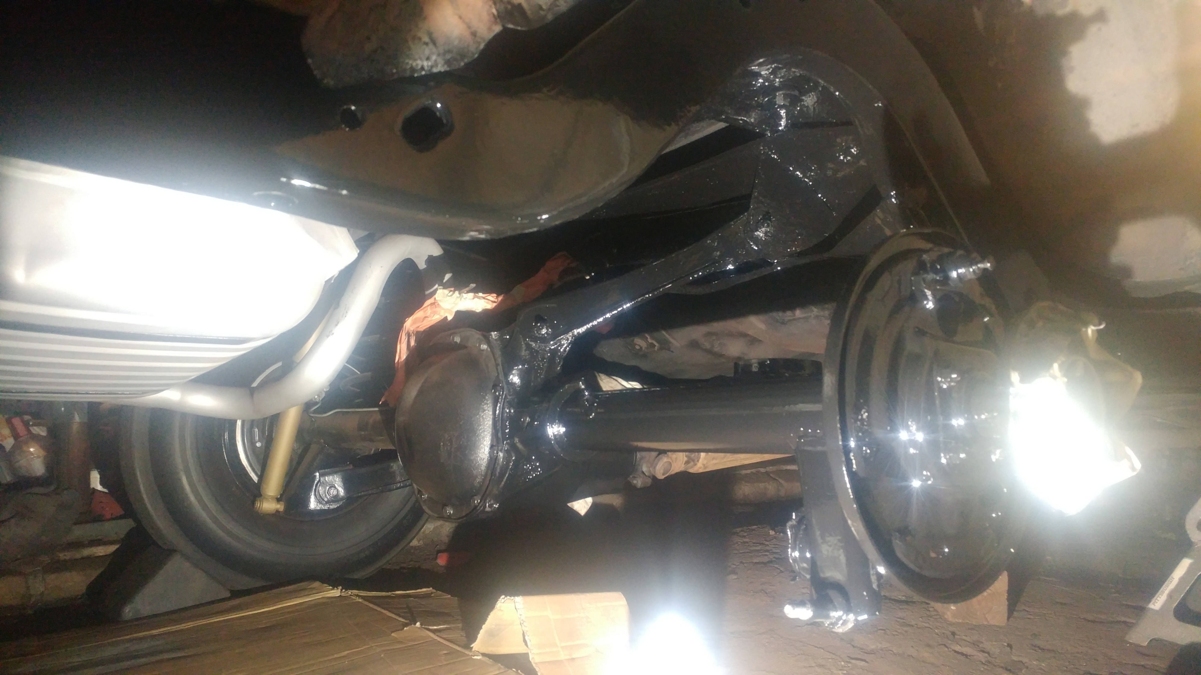

This is a night photo of the pass side I needed to finish. De rusted, rust reformer sprayed and chassis black topcoat. Yet to install the new muffler, pipe hangers (stainless) and new brake line and hardware. I'm so glad I'll be out from under the car for a while while I sand and seal the body panels. I'm using Rustoleum rust converter spray. It is an excellent paint if you never want to see rust again, but a topcoat should be applied soon after. All for now. Will post more soon Bud. P.S. thanks for the comments!!!
