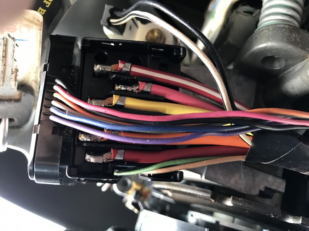

2020, if I may, first off wheel sensors if the don’t work simply revert to a dormant mode, I.E. no abs & no traction control. So they are a non issue under all circumstances. The downshifting issue is another story! It is definitely electronic, but without looking at a schematic I can’t say what. That will take a little time, I have all the manuals, I just have to go see what interfaces with what. In the mean time you can look at another possibility. While it may be a slim one, I’ve mentioned this before, that these platforms are are wired with five 12 volt leads. They feed the ignition switch which is a series of finger switches that distribute power to the rest of the car. It is very common for these finger switches to burn and when they do they no longer deliver 12 volts. This in turn causes electrical issues with whatever branch is on that 12 volt lead. As of now I don't know how, if at all the tac ties into the equation. So try two things, first go down on the steering column and find the plug coming out of the ignition switch. Locate the 12 volt supplies at the plug. Using a volt meter, with the key on, get in to the backside of the wire were it inserts into the plug and see if you get 12 volts. Do this for each 12 volt lead. The other, and you may wish to do this first is disconnect the traction control at the source, not the switch.
Ok im looking into this right now i will let u know what i find.. thanks
I have 12 volts on all them except the yellow wire it has nothing.. and the orange wire is only getting 11 volts
Hey what do u mean disconnect from source? I dont see a fuse for traction control anywhere
Ok with car running i have 13v on all the wires except yellow one it still shows nothing... i pulled abs fuse incase it was tied in with trac control and same issue
I have crawled all over this thing looking for loose wire or broke wire.. i have found nothing so far.. i need a miracle lol
Do you know if you have cruise control? It appears the yellow wire feeds the cruise & the cruise & trac control are tied together. Because all traction control does is low rpms. So possibly it's one of two things, 12 volt power to yellow or a ground issue. See if you have cruise, then pull the cruise fuse and also check your ground connections. If that's not it…. Well we’ll keep thinking.
