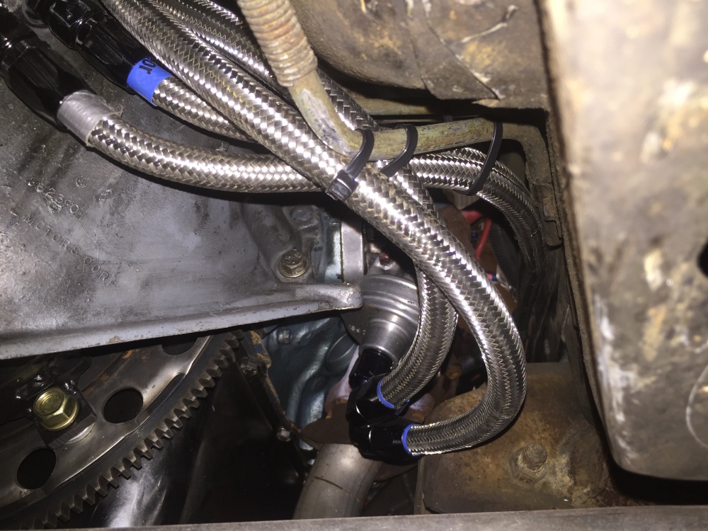

Was looking at the photos. Can't see where the remote oil filter is located. But I'm old and halfway blind. Was just wondering how close if at all.The oil lines going to the filter were to the exhaust manifolds or headers helping possibly making the oil temp hotter than should be??
Edited by TWO LANE BLACK TOP
Two Lane, Good thought, the lines coming off the adapter go up and over the bell housing towards the left then under the steering shaft wrap around the inner fender well going towards the front of the car and the filter is mounted on the front of the fender well. You can see in this pic the right side exhaust is not close to the lines. But I may be on to something, it doesn't make a lot of sense but. I had to cut out my muffler in order to replace the gas tank. For S&Gs I fired it up without the muffler and it never went over 195. BackPressure to high? It didn't appear that way. New muffler and pipes. the engine was plenty responsive with that muffler. Just weird, gremlins I tell you gremlins. Anyway I'm redesigning the exhaust and using tube muffler instead of the rear mounted. TempOil.mp4
