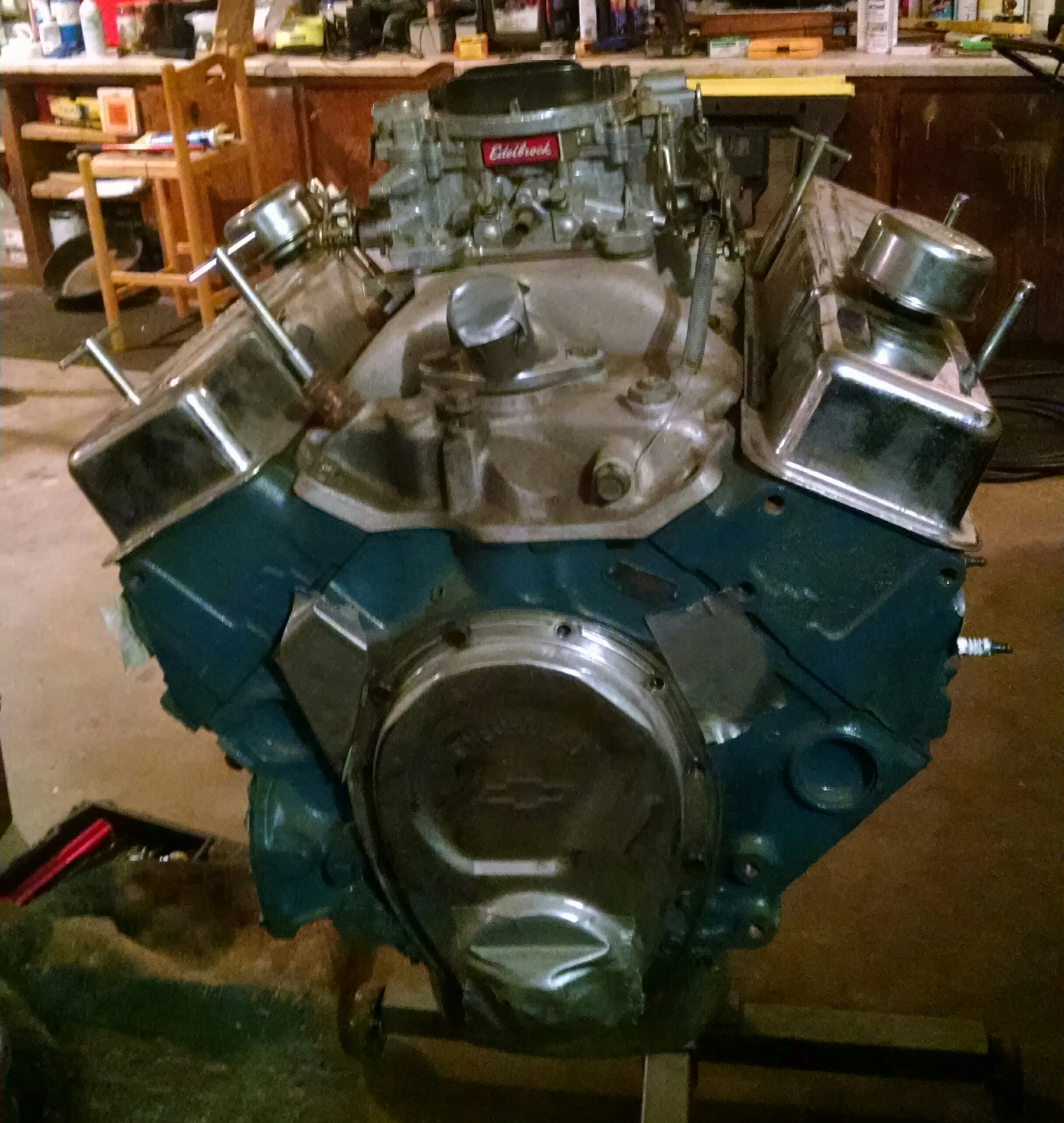

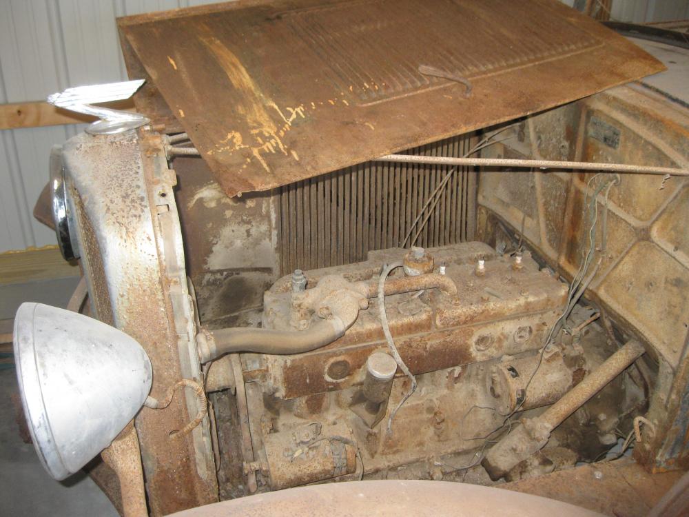

Stephen you know what they say about a picture... Well here's the six.

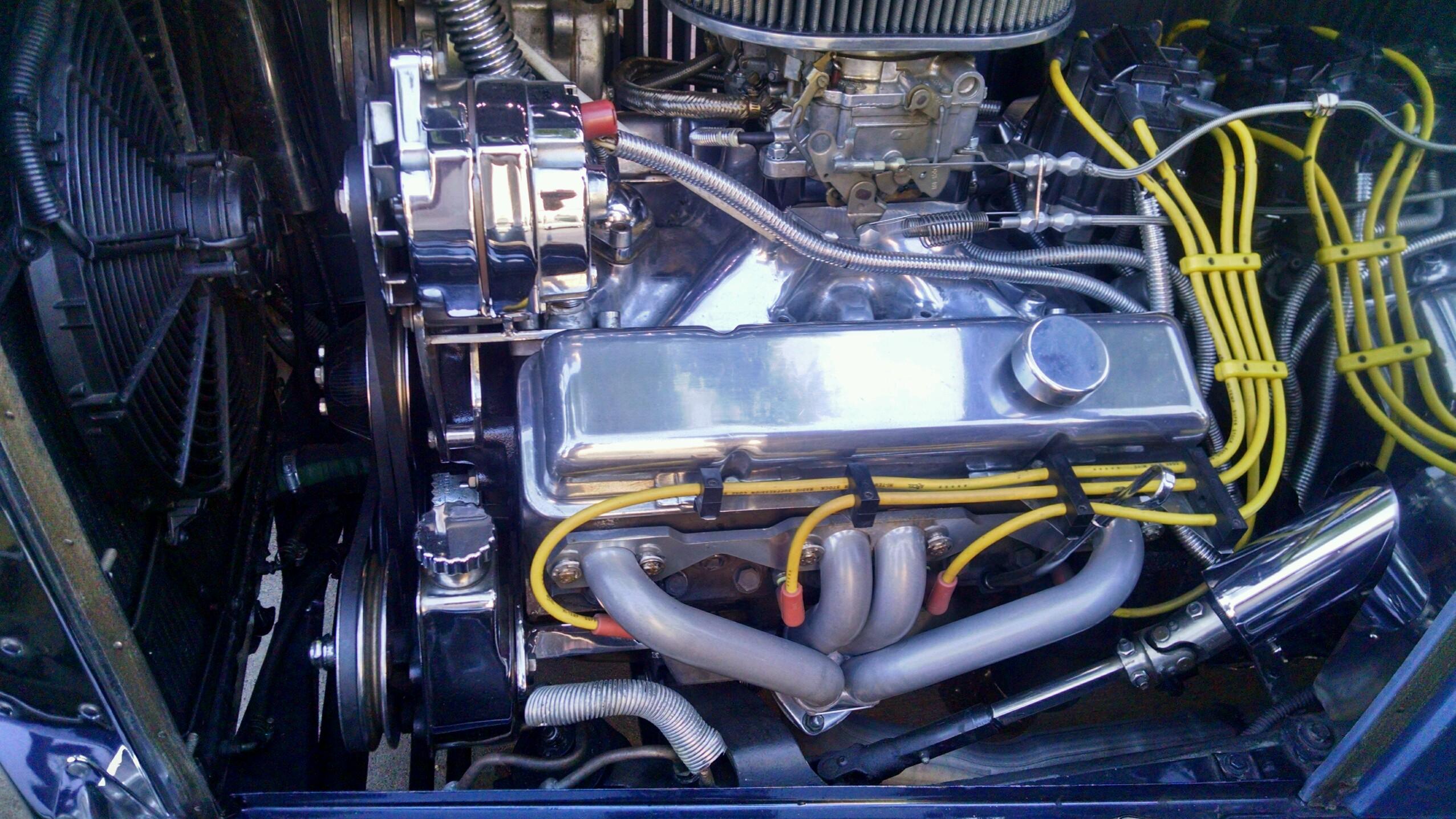

And here is the eight. The weekend before we bought this car we met an older gentleman that had a 26 Buick with a 350 in it, which fit beautifully in it. There is plenty of room under the hood. Nothing wrong with 6's I have a 4.3 with laker pipes it sounds great, but since I own the 350 already I'm gonna stay that route. But thanks. And once I have this restored I think people will be more impressed with fact that a 31 Pontiac does exist!

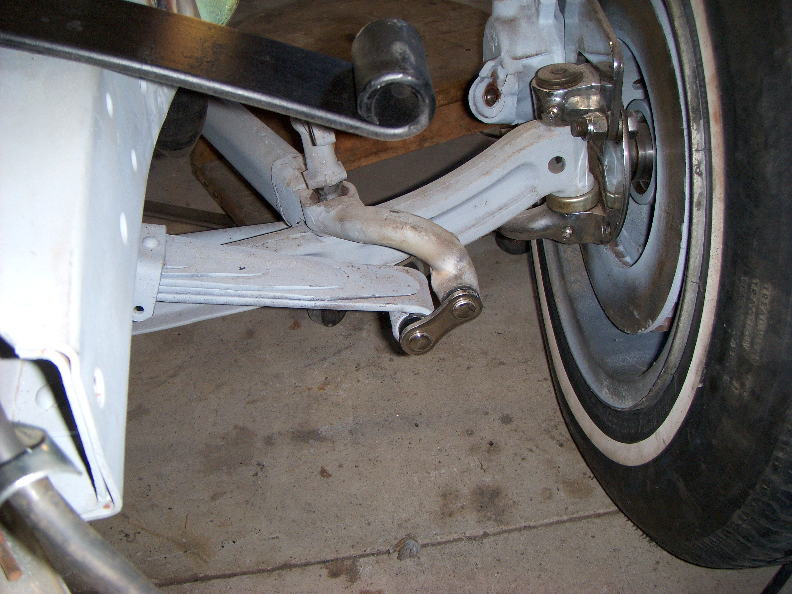

I mention that since he also runs a 3" lowered straight axle. There are shocks also mounted on it to smooth out the ride. Here is an early picture of the front suspension before he went to the lowered straight axle. This is the stock straight axle.

     Only 30 lbs of dirt under the hood? That Pontiac has led a sheltered life, hasn't it? I noticed in the engine picture that the six has two cylinder heads - just like your 4.3 and your 350! Or not quite. You must have a problem with the spindles, that you're thinking of new ones. As I said earlier, I have no experience with solid axle front ends. But I wonder, if you still want to stick with the solid axle, whether compatible spindles would be available from places like Speedway Motors. Their catalogs give dimensions you could compare to your Pontiac's. Thinking of driving the car, the tilt steering column is a great feature, just supposing that Mrs. Danny occasionally lets you in the driver's seat, and your dimensions don't exactly match hers. (As to arm length, I mean.) As to non -power vs. power steering, you have to choose your pain. My '53, at over 3600 lbs, was no picnic to steer when I got it, ("No job for a lady" - forgive the incorrectness) and I put power steering on it. Your '31 is lighter, I imagine. The power steering boxes are always bigger and heavier, and there are mounting, hose routing, and pump/belt clearance considerations, but the end result is a nicer driver. A serpentine belt/bracket setup is likely available for your engine, if there's enough under hood room. Lots to think about. But what fun!

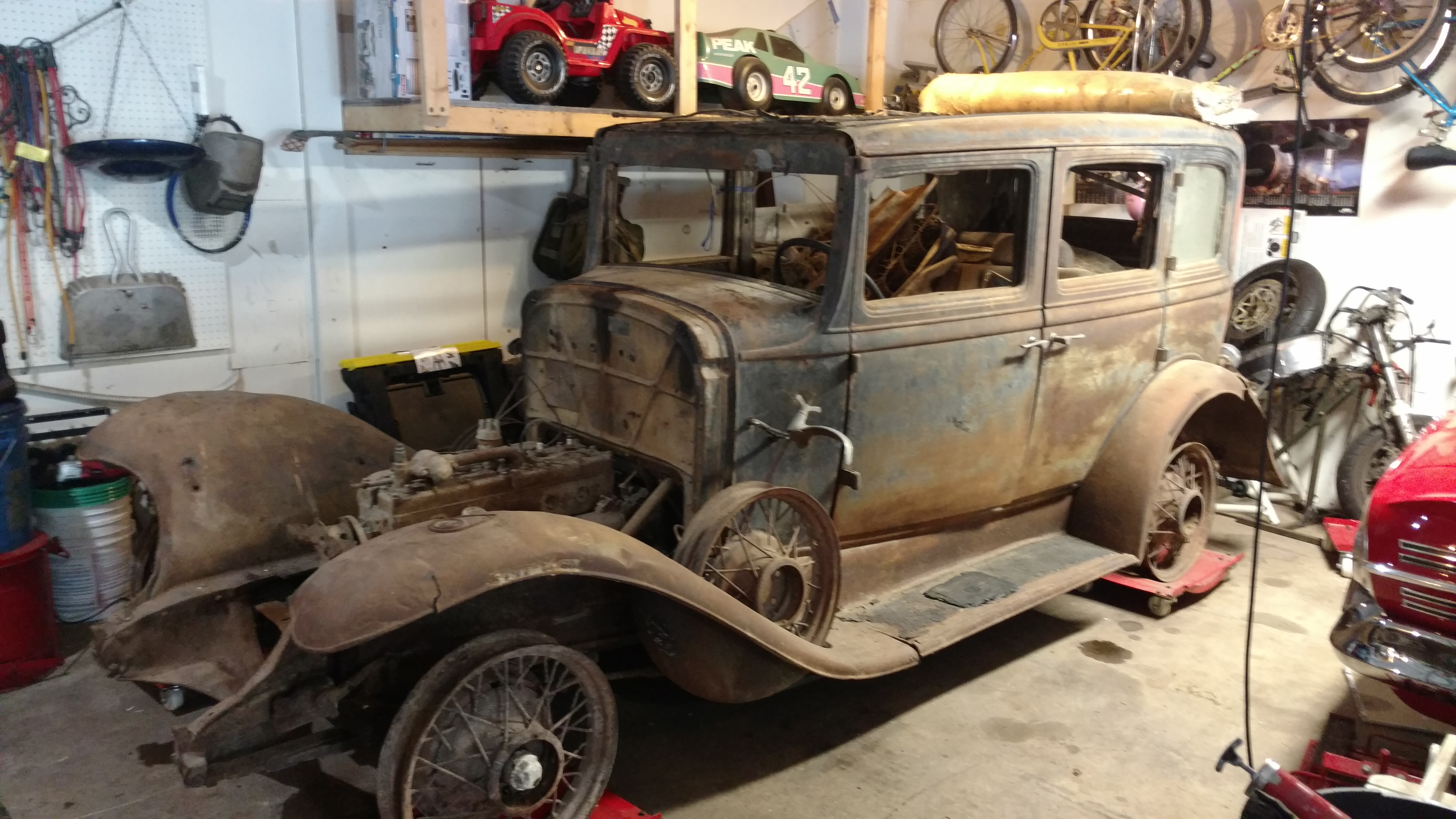

I Started tearing apart the 31. Got the dash out, hood off, rat off, fender wheel locks off and 75% of the fender bolts removed.
Danny, Sounds like fun, except the 25% of fender bolts that didn't come. I see the nose of what I'm guessing is the El Camino - great color, but I don't see any oxy/acetylene or oxy/propane tanks. Heat is a great persuader, when available, for stubborn fasteners. Have you seen the inductive coils used for heating seized fasteners?  I haven't, only on video. Looks amazing, and no flame or tanks or hoses  or fuel cost or rental. Or helmets or bulky gloves or wayward sparks or tip cleaning. But probably more limited, in what they can reach, than a torch.

I didnt have the rest of bolts out cause I ran out of time that day. They are just small 1/4 bolts and easily accessible so I'll likely just cut the off. The main ones came right apart. Amazing how good old steel is.
Car was black from the few places with paint left. We are doing antique white w/blue fenders and running boards and a blue accent stripe that climbs up to roof.
