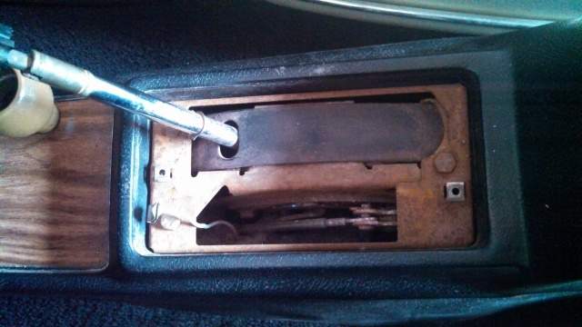

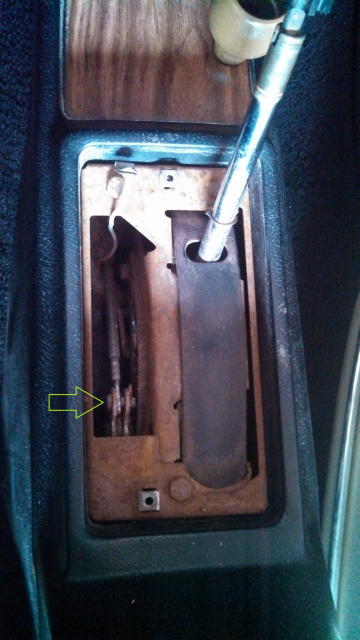

I took the console off, and undid the cotter pin and rod as pointed out in the picture below. The shifter then went forward and back without a problem. I don't know where this makes the issue lie, but I guess this means it is not the physical shifter

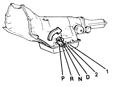

OK is the shifter cable engaging on the transmission side of the cable? You will need someone to shift the shifter back and forth while you inspect the transmission side of things to see if the cable is moving.
Check to see if the cable is moving gear selector on the transmission. The picture is for a 400TH or a 700 4R.

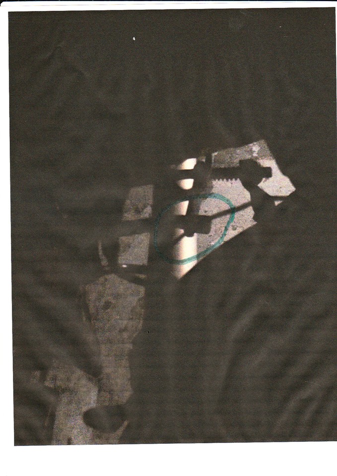

This is the online instructions that were given to me by a local Pontiac club member.  I am a visual learner and pretty new to these cars and that picture is pretty dark that I have no idea where he is talking about.  Below are his instructions and picture:
"The shifter linkage is tied to the transmission.  On the other end which shows up in picture....where the blue circle is the adjustment for the rod I was talking about.  Loosen bolt and push up all the way and retighten bolt.  Should fix the issue"

OK I do understand what he is saying. The bolt may either have originally (or may have developed over time) an elongated bolt hole. Loosing the nut/bolt and pushing it all the forward to take out any slack and then re-tightening the nut/bolt is what he is referring to. This is found underneath the car, near the firewall.
Thanks for the help guys.  My car is currently at the body shop so I can't work on it right now.  Going by that dark picture I am not exactly sure where this mystery bolt is, but once I get it back I will take a closer look and hopefully I can get this thing straightened out. Thanks again for now
It is between the engine and transmission, close to the body, near where the steering column exits the firewall. Your exhaust pipes might prevent you from seeing it very easily, or you might have to reach around it to get to it.
Okay, I found it and I am back from adjusting it.  Unfortunately loosening that bolt, pushing the rod up and re-tightening didn't work, in fact it made it worse and now it won't even go into park by turning the collar anymore.
I have a few questions, the rod is almost pushed right to the top of the collar so am I suppose to push it up more even if it made it worse in the grand scheme of things?  Also, is that bolt suppose to be super snug against the metal there, or is there suppose to be some slack, because when I tighten the bolt it holds the rod in tight but there is still some room before the bolt sits tightly against the metal.  Is this just trial and error...like just keep fiddling with it until it works or is there something possible up elsewhere?
