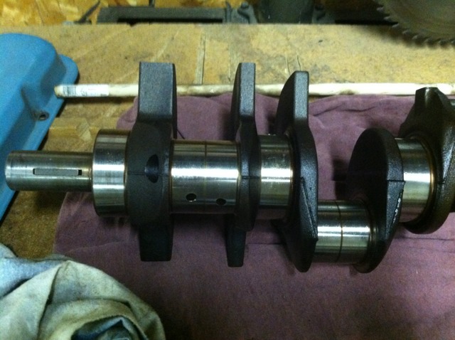

Getting an eagle stroker asm and pulling the motor apart tomorrow. If anyone needs a 400 nodular crank in excellent uncut condition let me know
This crank is outta the original motor, not the gold making one lol

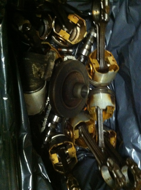

post-1672-135804946937_thumb.jpg. This stuff as well

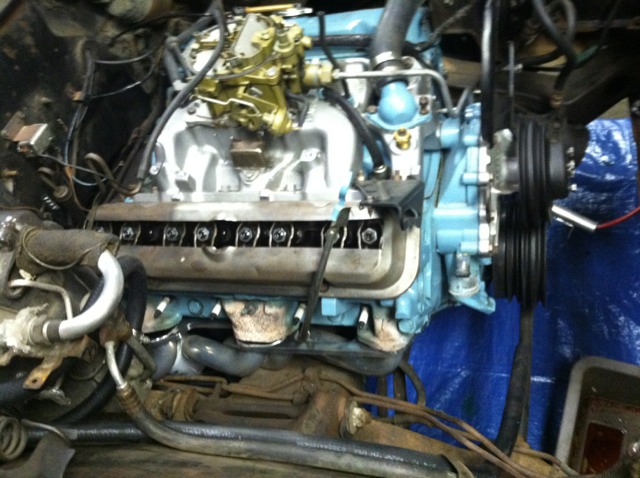

post-1672-135804984289_thumb.jpg. Looks naked lol
Nice work. I'd hang on to that stuff for now. Never know when you'll find someone to sell it to. So what are you stroking it out to? 462? Are you re-using the stock rods? What shape was the original cam and lifters in?
What is with the cut valve cover? Is it being used for breaking the motor in and making sure the valves are properly lashed?
Lookin good!!!! Looks like new headers too.
Valve cover is cut to adjust lash with it running
462 is where I'm going
Headers have been on for 2 yrs lol
Eagle forged rotating asm also
Valve cover is cut to adjust lash with it running 462 is where I'm going Headers have been on for 2 yrs lol
Ah ha I suspected as much. It looks great.
