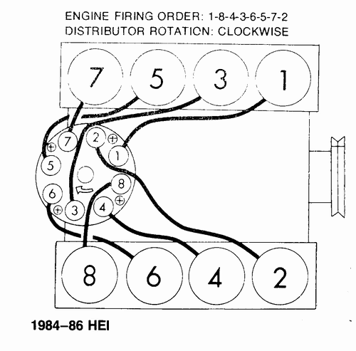

If what I know is correct then this is the diagram for my engine:
Well If that is correct then below is how my engine is set up
Distributor to Plug/Cylinder
6 to 6
4 to 3
2 to 4
8 to 8
5 to 5
3 to 7
7 to 2
1 to 1
Now I'm still learning, but to me that seems.... out of order. (*puts on sunglasses*, YYEEEEAAAAHHH)
But seriously, that doesn't seem right to me.
Bump for when my brain is working tomorrow and not dead from 12 hours of programming.
Seems right but I can't think for the life of me right now how to explain it. **see above statement**
This is how it should look. Ignore the hei year for it because they have not changed it.
Hey so I went to my gf's dad and he took a look and it is all correct. My cap had I think he said carbon streaks on it. We replaced the cap and my engine goesnt hickup anymore. Luckily I had this concern to my cap or else we'd never find out haha
