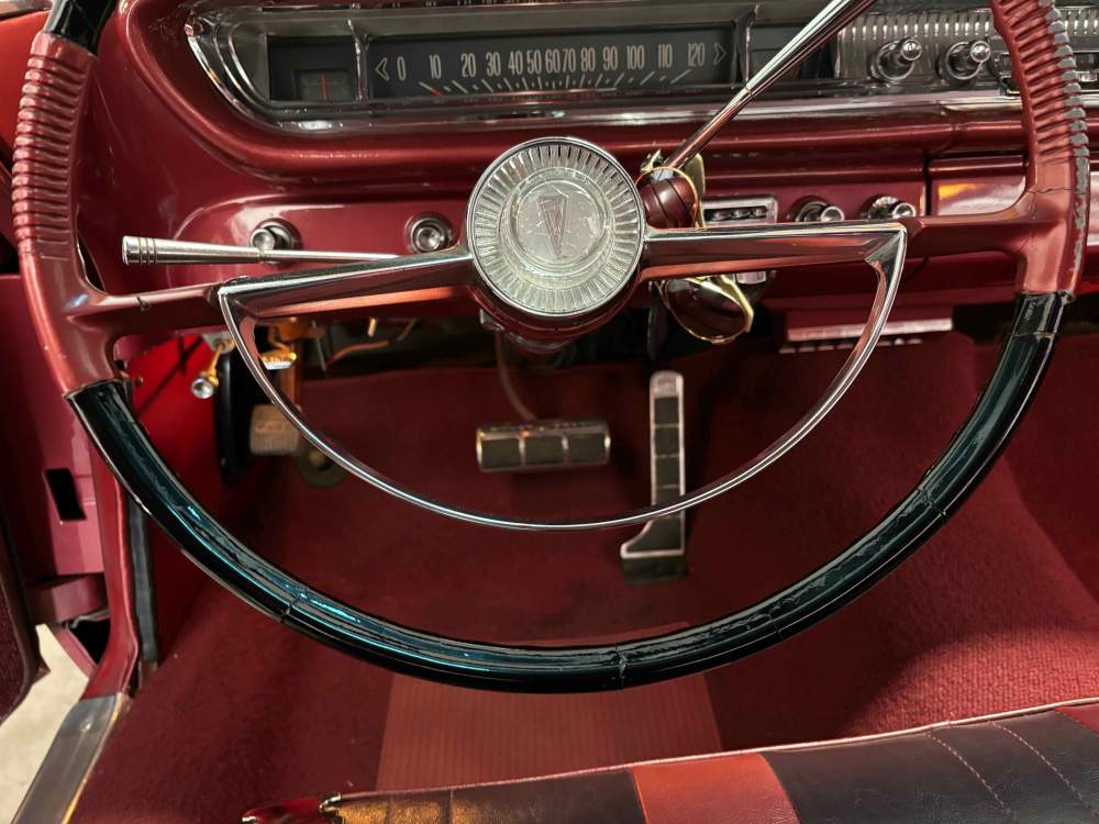

Can anyone tell me/show me/help me with what components I need to make my '61 Bonneville horn work? And if there are alternative parts available that will (if at all possible):-
1. Work
2. Be available this century
3. Not require me to mortgage the house to purchase them

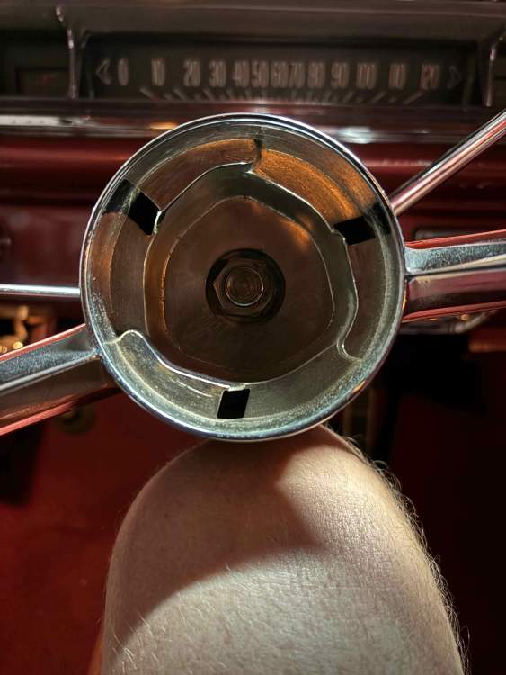

I have the wheel, horn bar, 1x spring, retaining washer and nut. And that's it. The horn bar doesn't "tilt", as it's tightened down with the wheel itself (so I suspect more than one spring is required, or there is a tilt mechanism I may need?).
And if you have a recommendation for someone who can repair my steering wheel for less than $1000 AUD, that would be greatly appreciated also.
Thank you 🙏

I haven't bothered either testing the horns or checking for a relay so far, because the steering wheel itself has no jewellery to make any of that operate. I know I can easily purchase either horns or a relay here in Australia, so it's the list of parts at the wheel end that I need - as far as I can see, all that is there is one contact ring that is screwed to the back of the wheel itself.

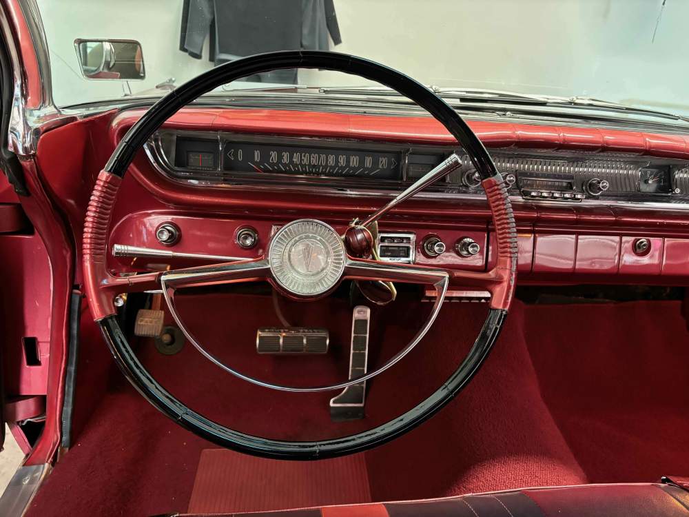

I recon you should be talking to our mate Dave the Ozzie Pontiac king ! Bet he’s. Got the parts you need Paul
By the way !!!!!
how come your steering wheel is sooooo mint !!!!!!!!!

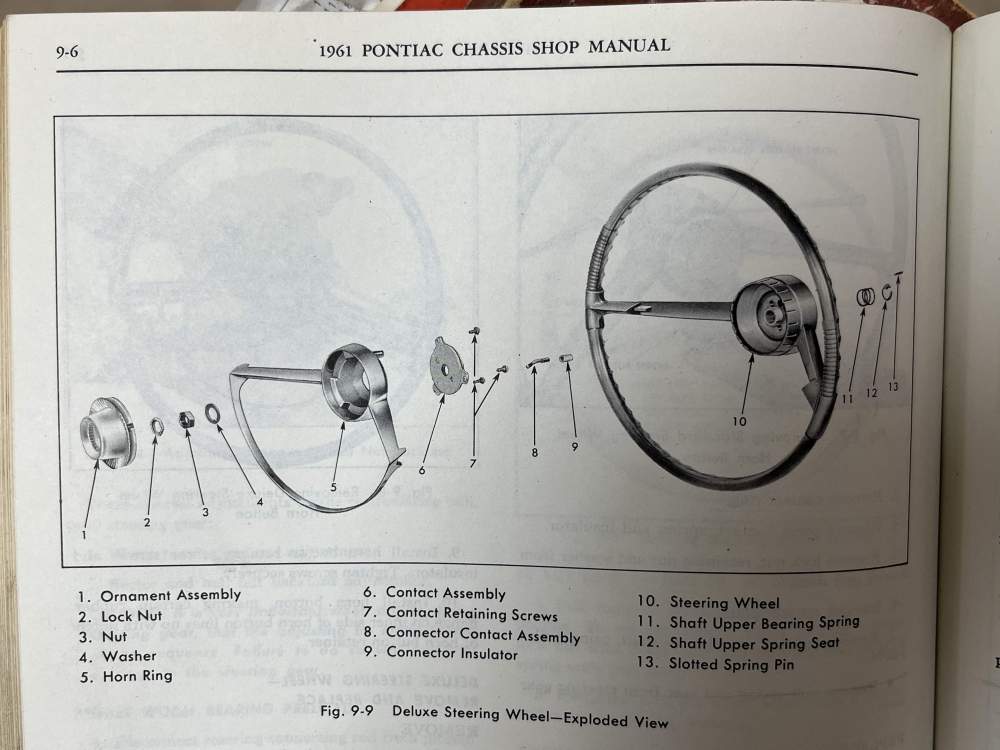

Does this help?

17 hours ago, 31pontiac said:
Does this help?
That is perfect-just like mine only legible 😆
On 9/25/2024 at 1:09 PM, 31pontiac said:
Does this help?
Just so you know my friend, with the assistance of the information you sent me above I was finally able to get my horn working, almost as it should 😃
I cleaned, checked and fiddled, and ended up making my own Connector Contact and Insulator.
Although it still needs some tweaking, it works.
Thanks again - see video below (short but very sweet) 🙏
