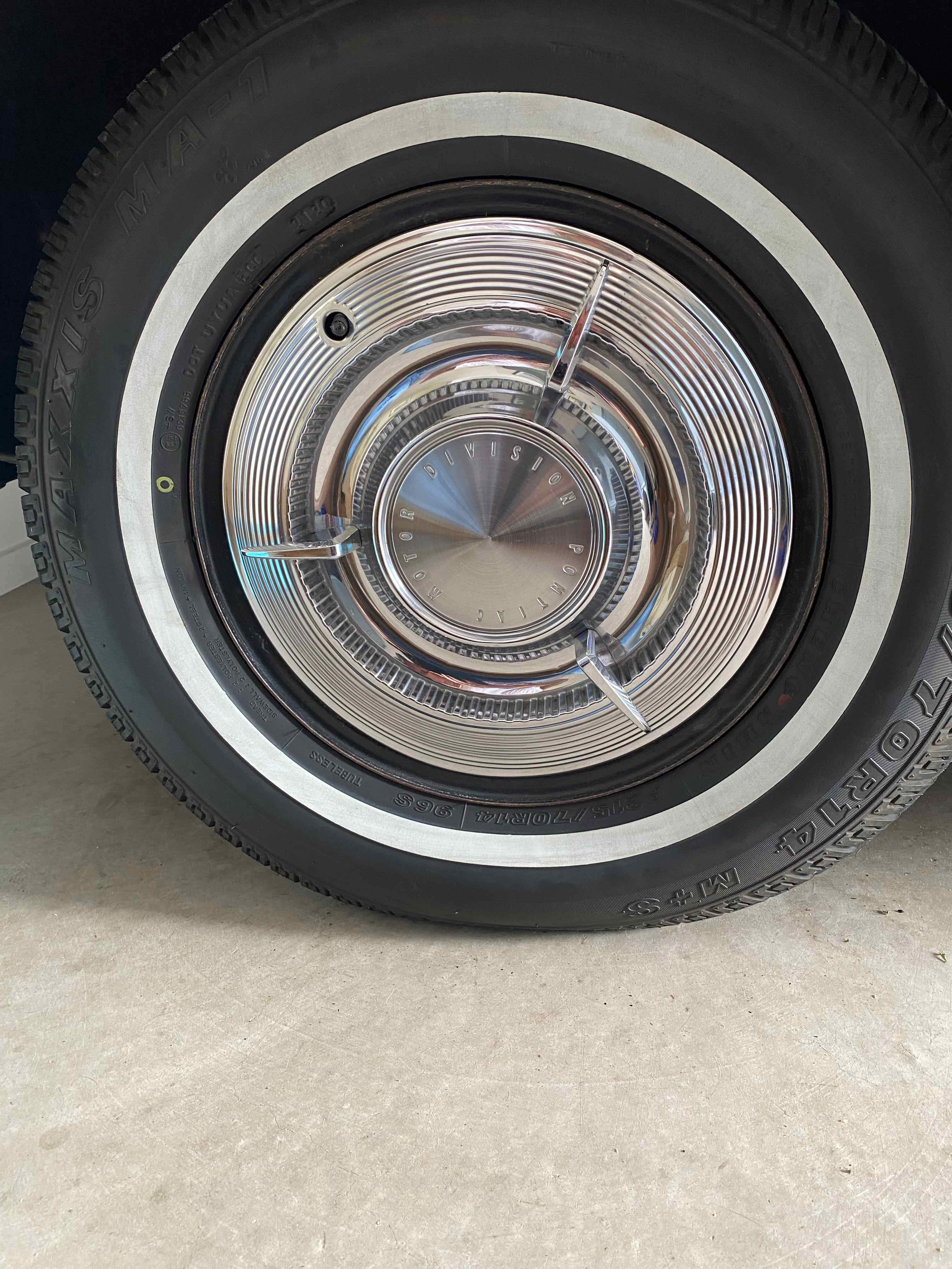

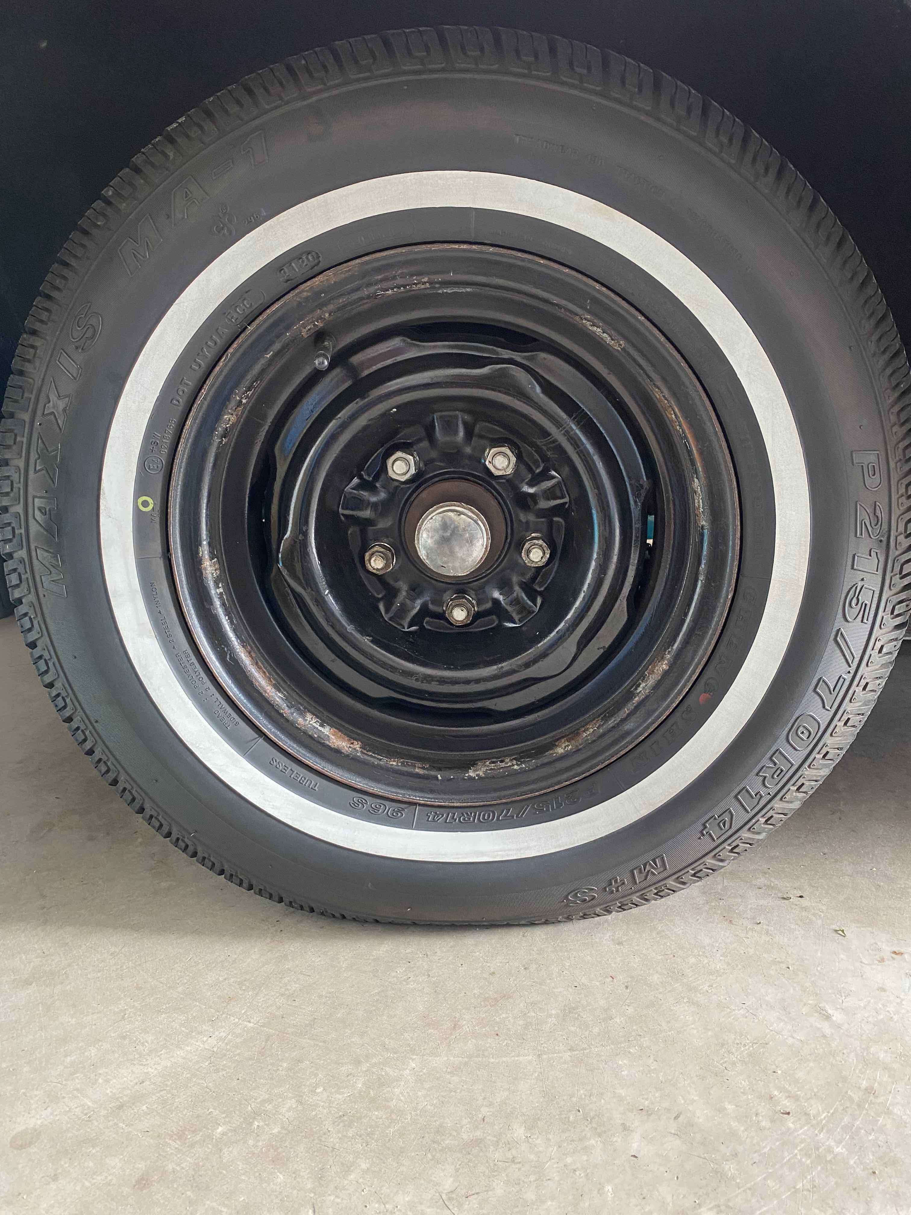

I am wanting to purchase a set of poverty caps for the Bonneville, so I can occasionally swap from the full covers and rear skirts to just caps & chrome trim rings for a different look (thinking of painting the rimes the same colour as the car, too).
As far as I can tell the car is running standard original wheels (they're 5x5, 14x6, & are running Genuine Pontiac full wheel covers). The approximate measurements of the centre of the rim that a cap would need to fit onto is 260mm (or 10 ¼"). Photos attached of a rim, and the current wheel cover.
Can anyone advise me what style centre caps may fit (I expect nothing Chevy will?), & where they would be available?
If centre caps aren't a realistic option, would I be able to fit the smaller wheel centres that slip through the rim?
Thank in advance 🙏

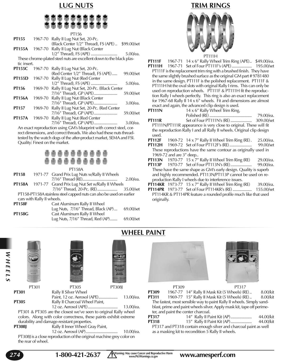

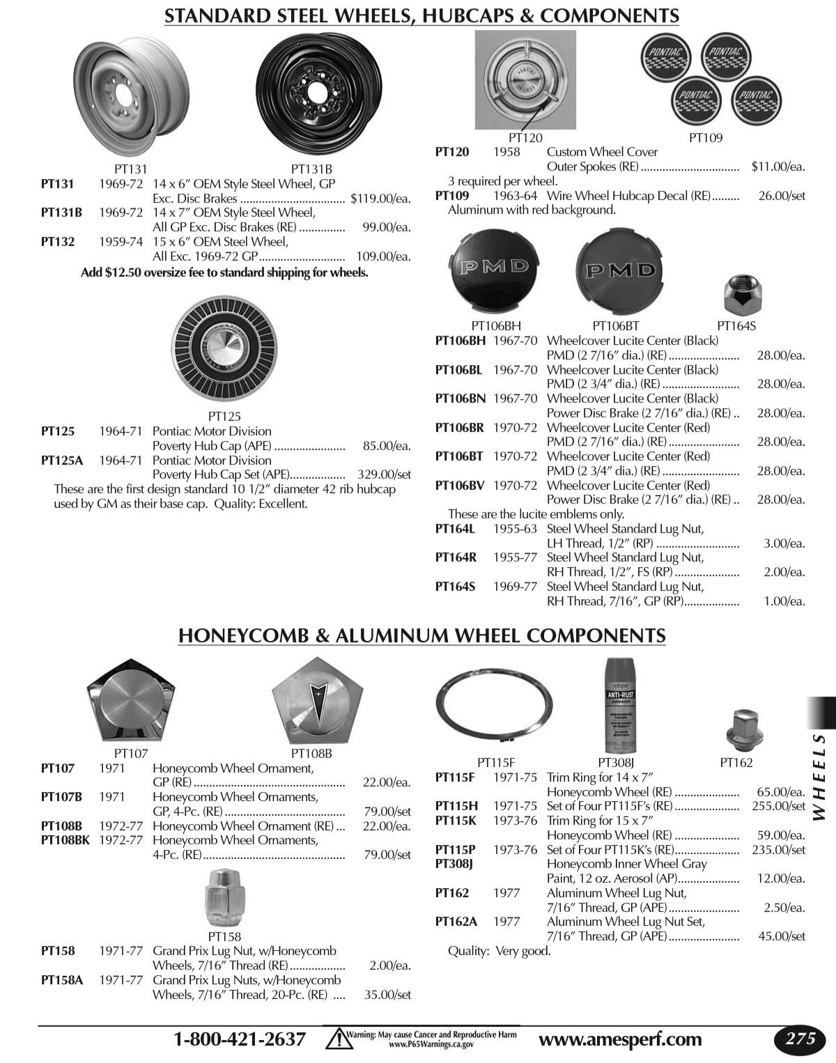

These are screenshots from the Ames Fullsize Pontiac catalogue (that I always keep on my tablet, in case I have too much money and need to spend some on trinkets.)
You'll see trim rings and what they refer to as 'poverty wheel caps.'

Used to call em Baby moons and add a trim ring. Always liked the 50's early 60's look.  ESP if your gonna paint the rims to match.  Shades of American Graffiti....
https://hubcapmike.com/baby-moon-wheel-cover-for-3-inside-bumps-on-7-1-2-inch-inner-wheel-flange/?utm_source=bing&utm_medium=ppc&msclkid=1f62843f2c761d12a4ede0ed6553383a
