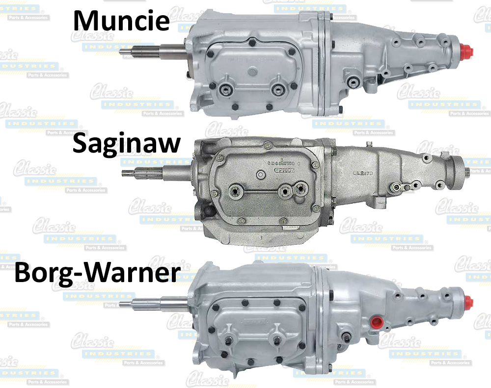

I suspect you have a Saginaw M26/M27 4-speed since the Muncie M22 was discontinued by 1974. Pontiac used the Borg-Warner T-10 only behind the 455 starting in 1976. So here is a visual differences between a Muncie, Saginaw, and Borg-Warner cases.
Thank you Frosty! I appreciate the info.
Happy to help. Let us know what you have.
