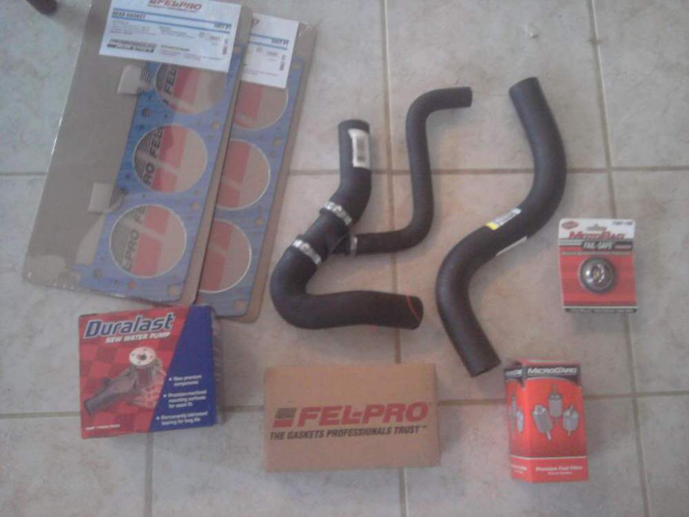

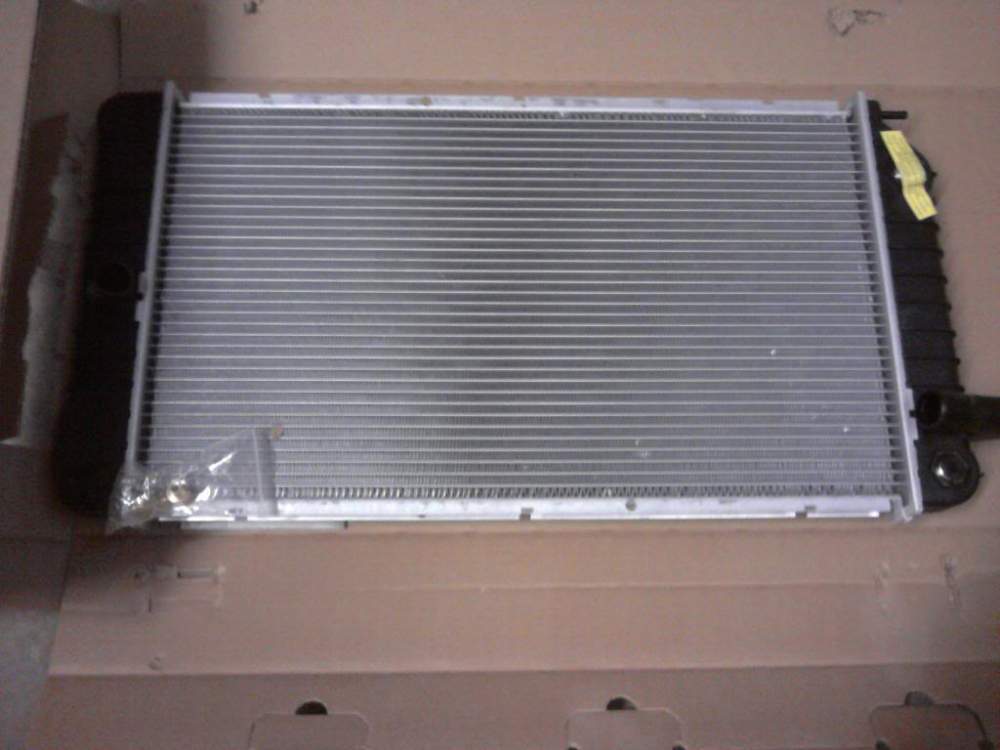

I bought new radiator hoses, new waterpump, new thermostat, new head gaskets, new lower intake gaskets, new radiator, new head bolts and a fuel filter as well for good measure. That consequently lead to..

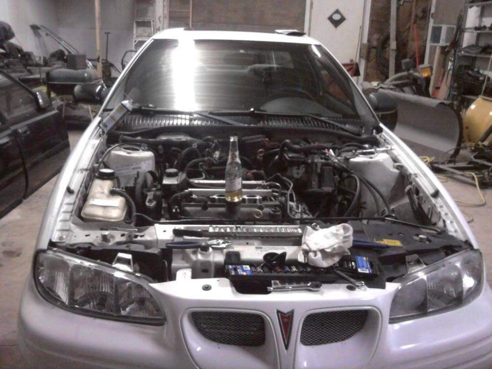

So next pic is very early on in this process. If your going to do head gaskets on basically ANY N-Car I can think of, go ahead and ditch the hood before anything else. I've dropped the hood on my head before and well.. I can think of better things to do with my time.

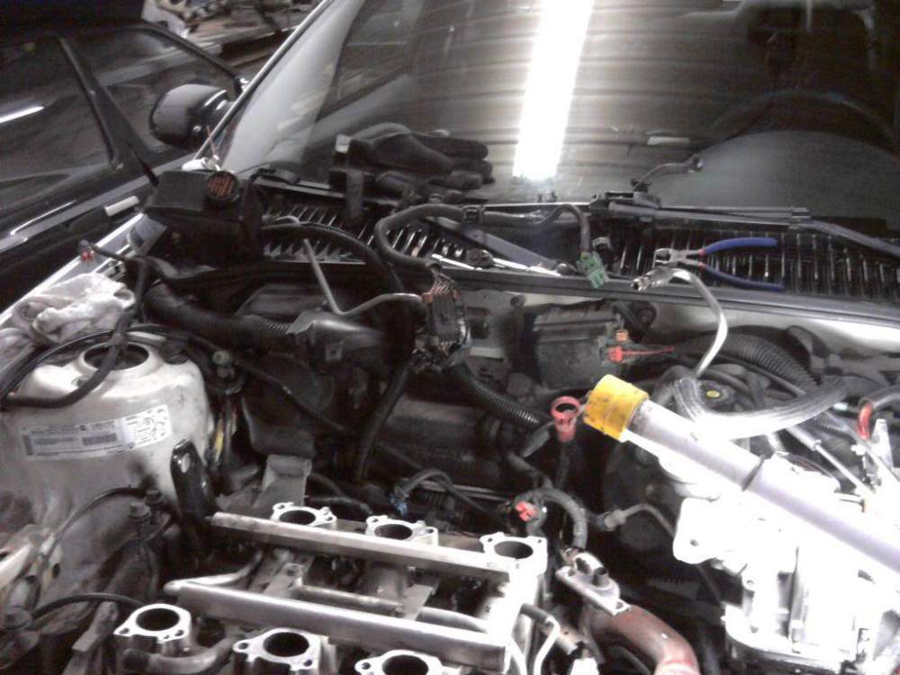

Here is a pic of what I consider to be the absolute most annoying thing about working on ANY newer vehicles, TONS of wiring loom.
Tucking that annoyance one wire at a time under the windshield wipers

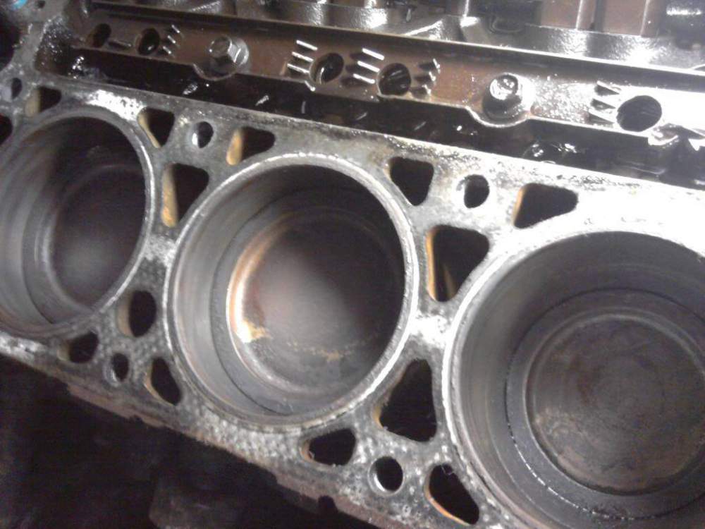

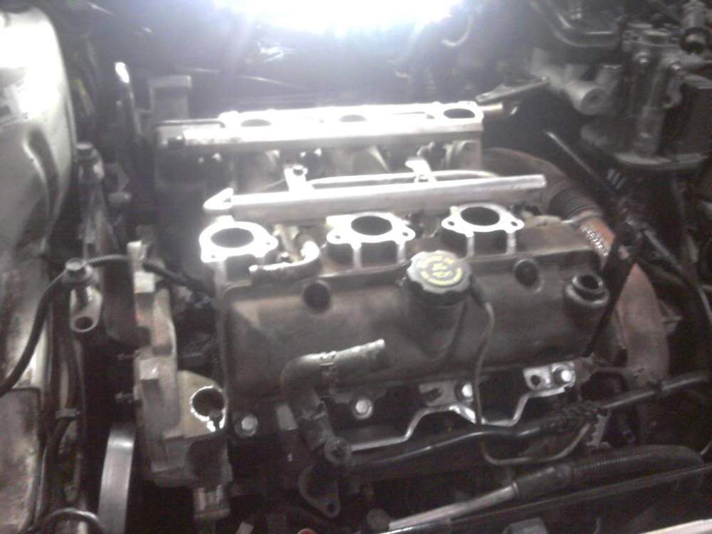

Within the next day the lower intake mani came off with little problems, and after using words a nun has never heard of we got the heads off and are left with this..

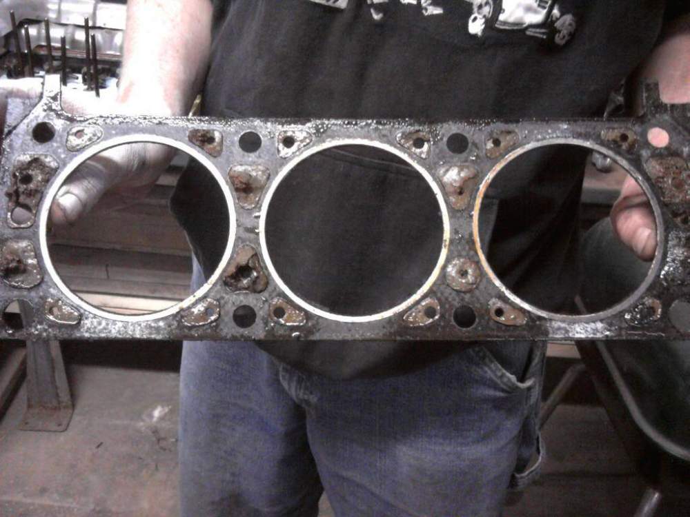

Thanks GM for using only the WORST possible gasket materials on the N cars. You always 'think' the gasket has failed but then when you get down to this all doubt you ever had is gone.
Isn't that just dandy looking?

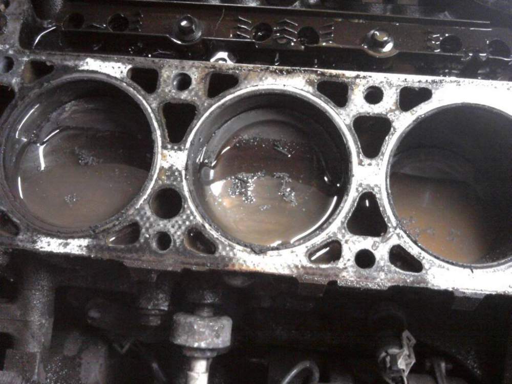

So then, after being so worried about the water sitting there and getting it vacced out, it looked much more acceptable.

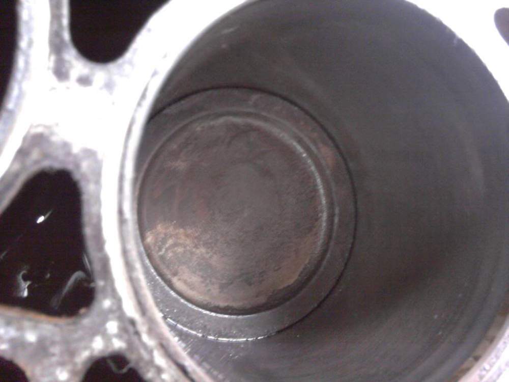

I come to find out a very positive note about this tear down, my cylinder walls are in absolutely excellent condition for a 115k motor. Not a single scar in any of them. 2010-11-27211333.jpg

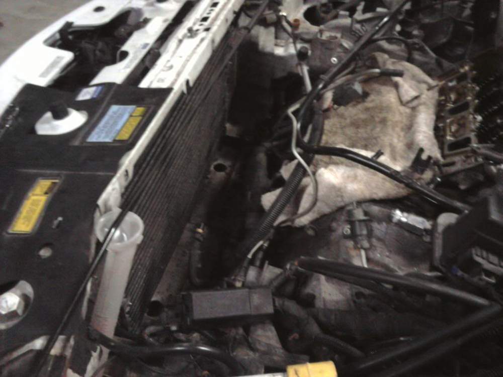

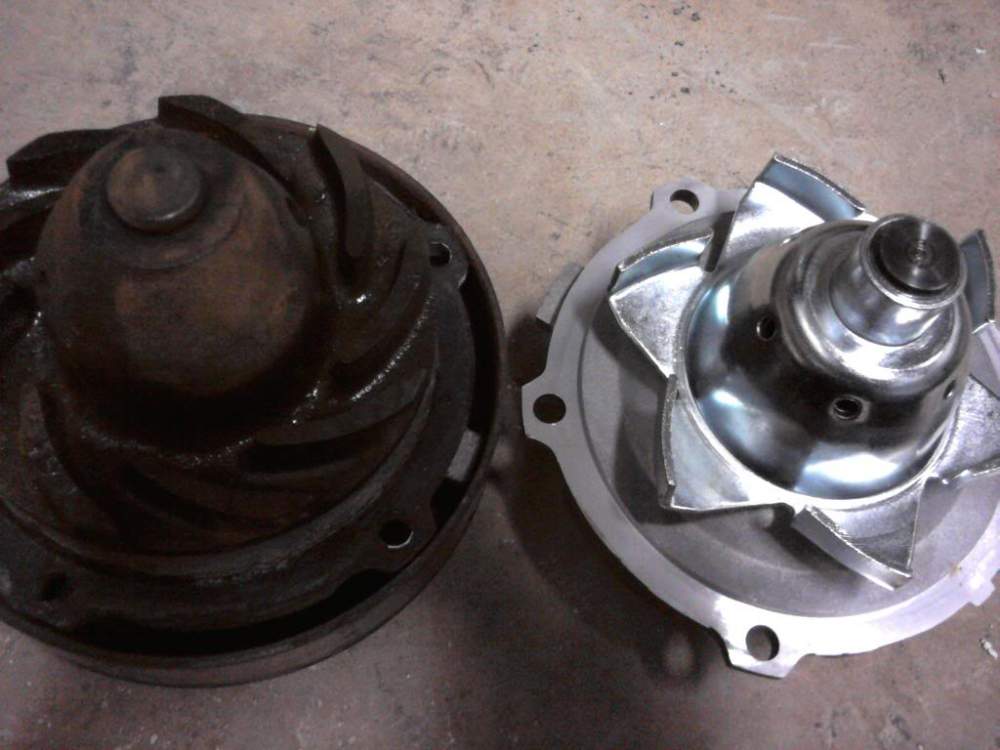

Which one do you guys think flows better? There is nothing necessarily wrong with the old pump, do you think I should reuse it?

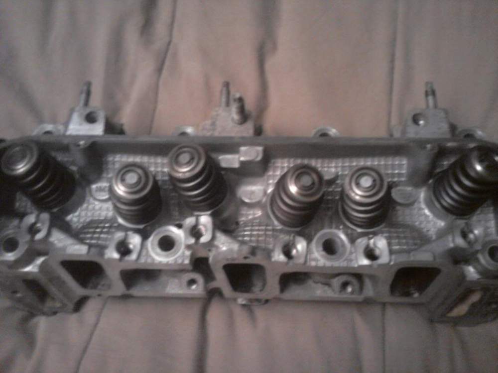

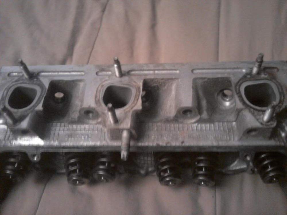

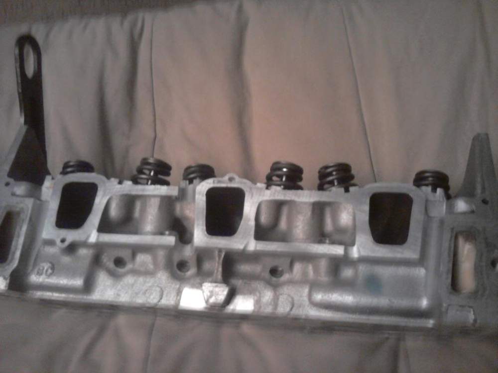

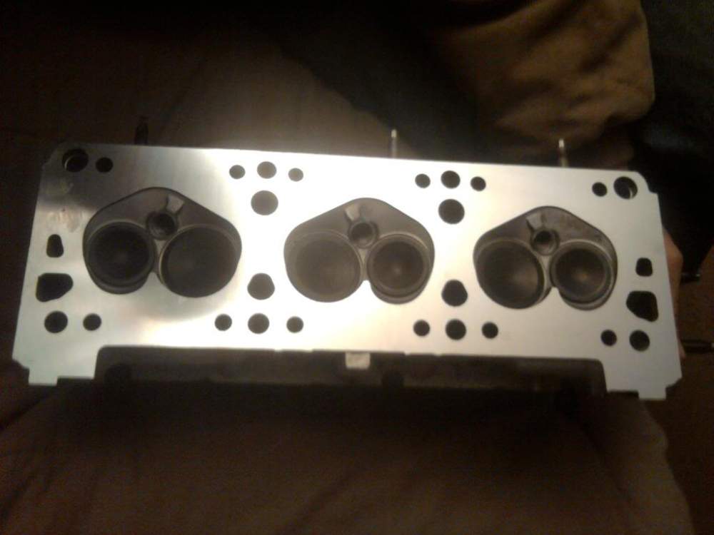

So about a day passes and I decide we should take the heads in to a friend of a friend to see if the heads warping is what caused the gasket to go.
Another $150.00 bill later I have shaved warp free heads, and the valves, valve springs/seats and everything are brand new! Not bad huh?

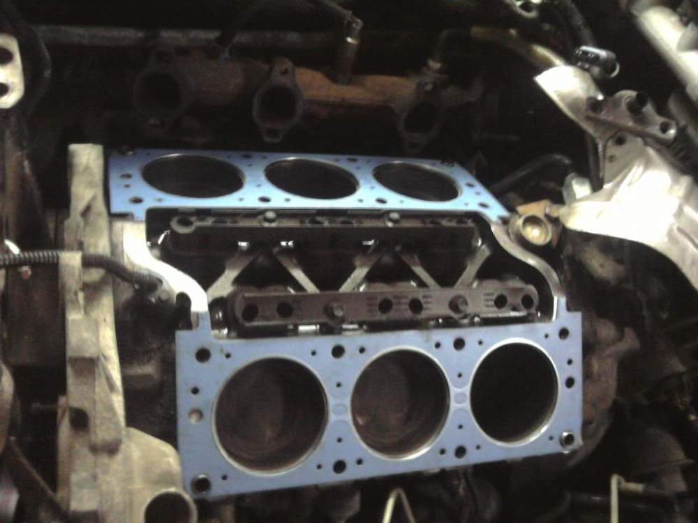

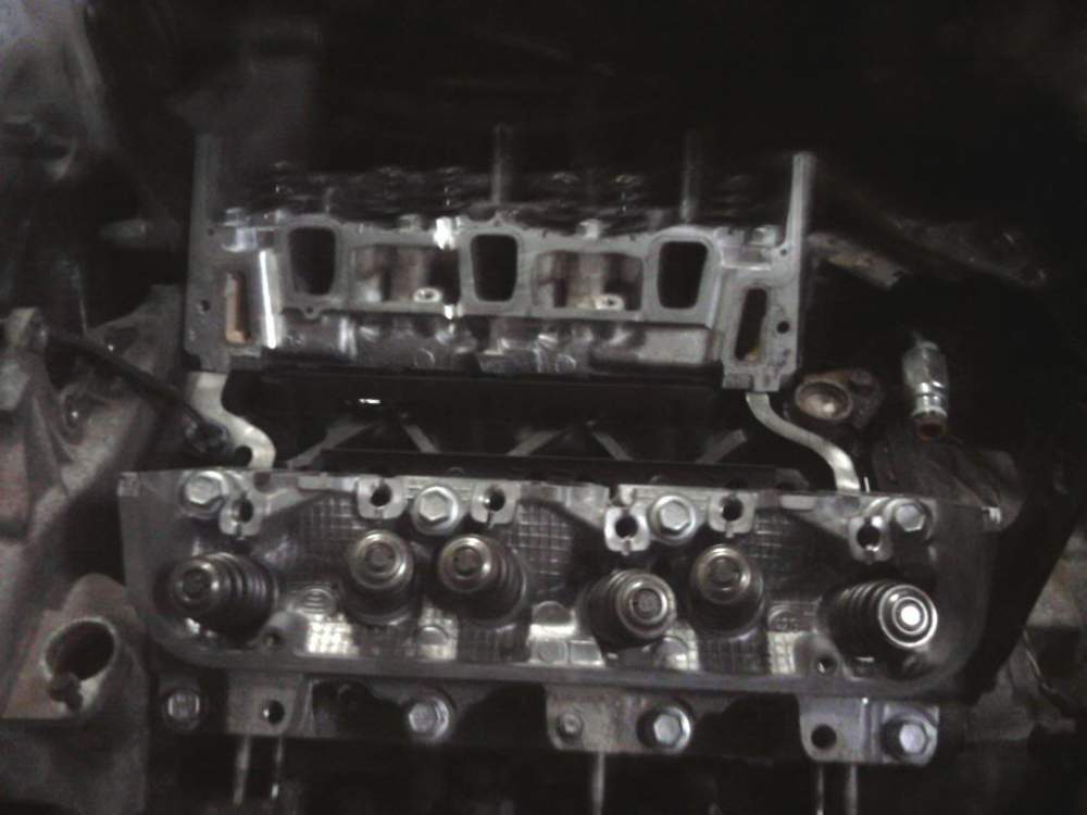

New felpro gaskets sitting in their new home for the first time
Heads now in place and awaiting that lower intake manifold
Lower intake now in place, as well as valve covers, and exhaust manifolds.

Yeah, when you are having that many major problems and stuff has a lot of miles on it, sometimes it is better to just replace a lot and rebuild it like that. That way you know stuff is good. Hard to tell from the pic but i don't see any actual failures on the head gasket. Just some gunk around the ports which is a coolant/overheating problem and not a gasket issue. But anyway, GM has improved their gasket material since those stock head gaskets were installed, as well as the water pump design, LIM gasket design, and several other things. So it was a good idea to replace that stuff anyway. i never need to take my hood off to do that though. :lol2: Might give you more light, or a tiny bit more room to work, but then you have to align the hood when you put it back on. Should run better with the heads cleaned up and rebuilt though. Let us know how everything turns out.
