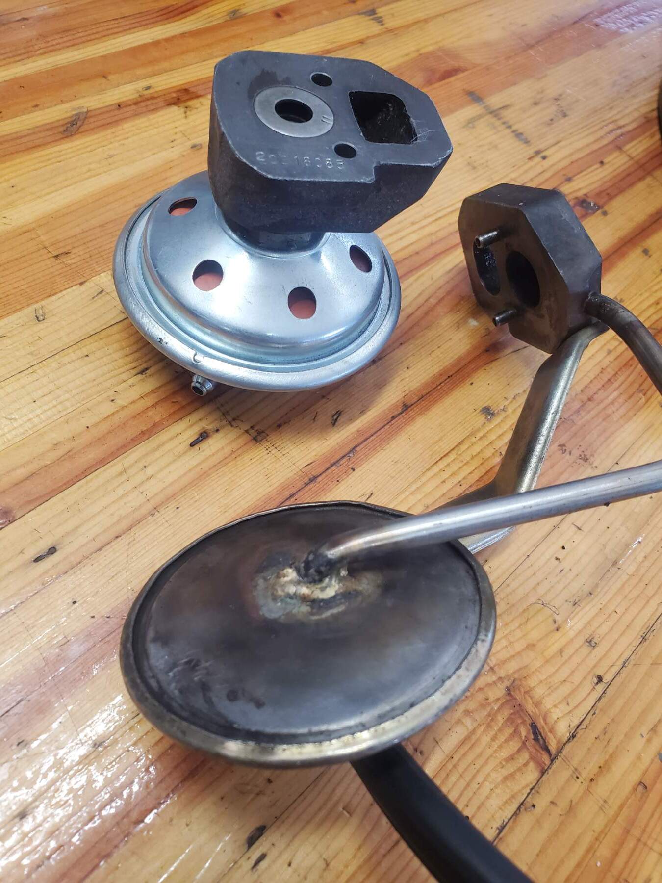

So left work early to look at this egr valve see photo. I remember last time I took it apart a couple years ago that the transducer had been braised sometime many years ago. It does not hold vacuum. The egr is good I was hoping to find a chunk of carbon holding it open, nope. Any thoughts about the transducer.
I omitted the transducer and put it back together. It still stumbles at idle and running without the transducer it also hesitates when you take off. Guess I'll reinstall it now. I haven't opened it up yet to see if I cured that problem yet. I don't get how that transducer is so important.

Runs nice and smooth with backflow transducer installed. I romped on it and it goes like it should. Paper inline fuel filter went bad using pump gas in two months.
