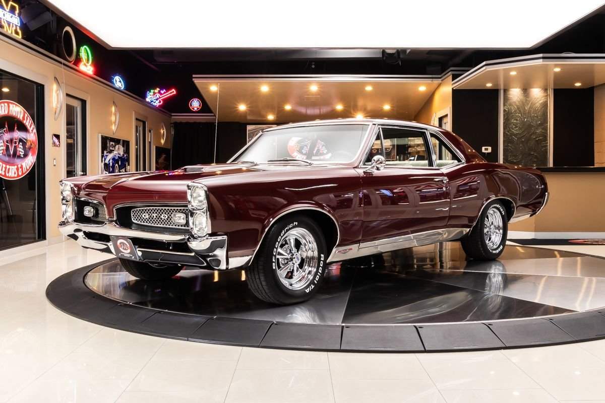

um ur... i am justA drooling over your outstanding purchase !!!:bowdown:
You know what, I didn't even notice the photo. I was too busy expounding my innate knowledge of Pontiac steering. Yep, that's a fine looking car.
