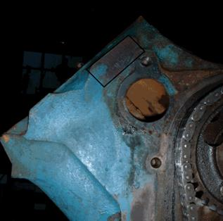

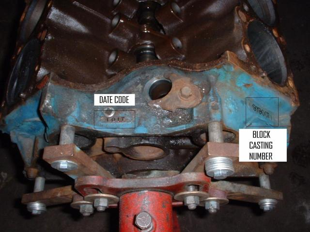

You need ti find the block casting number. Early Pontiacs are on the passenger side. Mid-60s is near the distributor. Later blocks had the displacement stamped on the side. I suspect you don't have an uber-valueable 421 Super Duty, but I included it in the list anyway.
