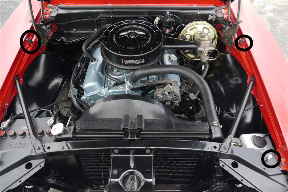

The factory had some small rubber isolators at the front and usually along the fenders. Where did your mechanic friend say the squeaking/metal-to-metal contact was coming from?
The picture highlights where the factory had them.
That is such a huge help! Definitely on the front circles, both driver and passenger side! So front fender circles.

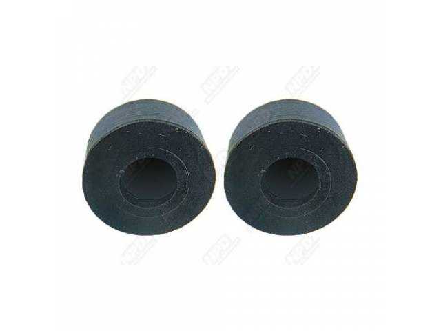

Those are generally called a "hood bumper" or "hood cushion". They can be picked up on Amazon, eBay, etc.. Check out this link on Rock Auto to see if this is what you're after. Because I'm not familiar with your year Firebird, I may be way off but maybe Frosty or someone else who is familiar with the '67's can chime in.
Awesome, thanks Stewy and Frosty. I believe from that picture I will be able to get what I need. Appreciate the link to guide my shopping!
Several of the catalogs have them: National Parts Depot, Ames Performance Engineering, Classic Industries
Here is what National Parts Depot shows:
