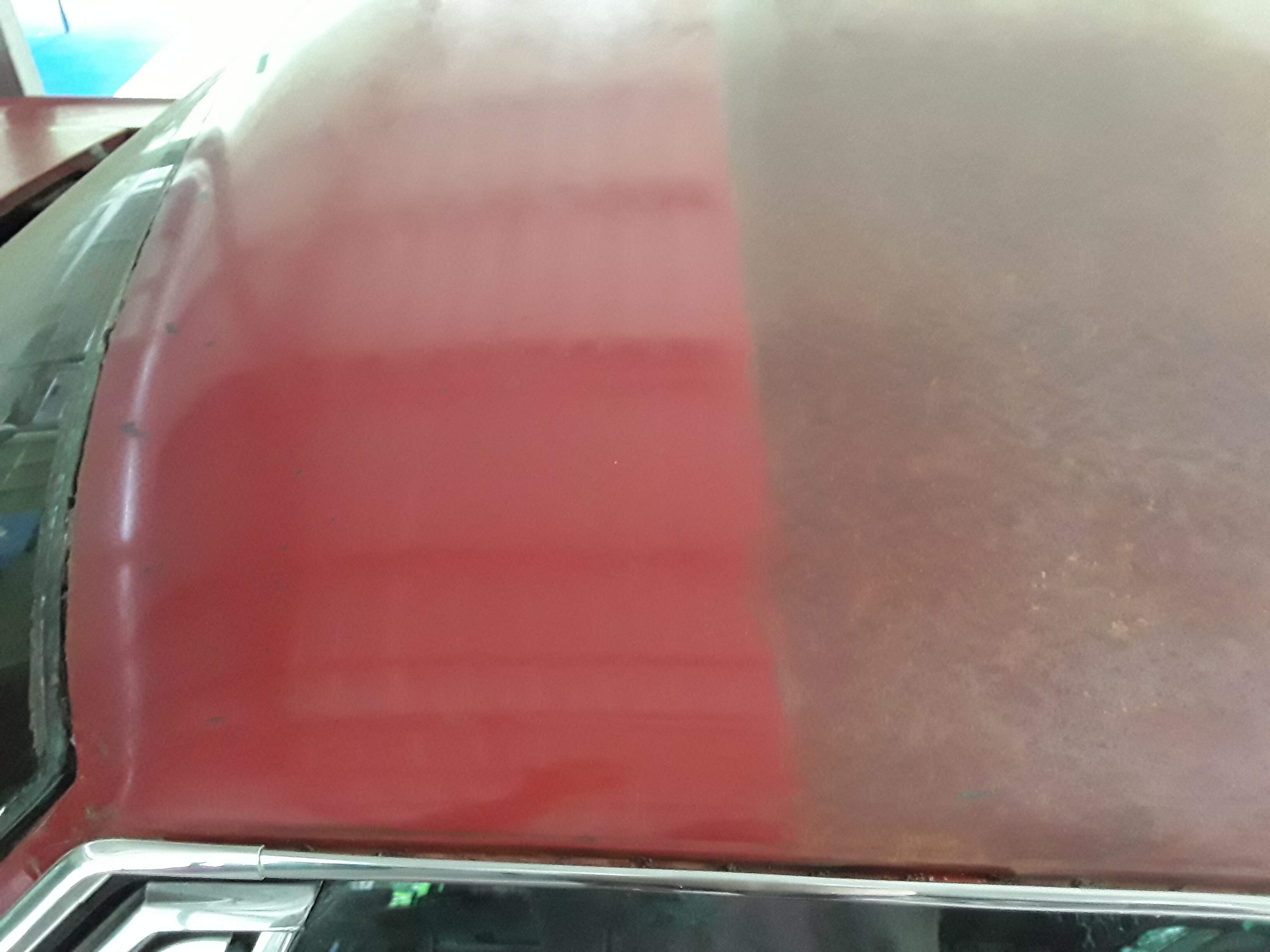

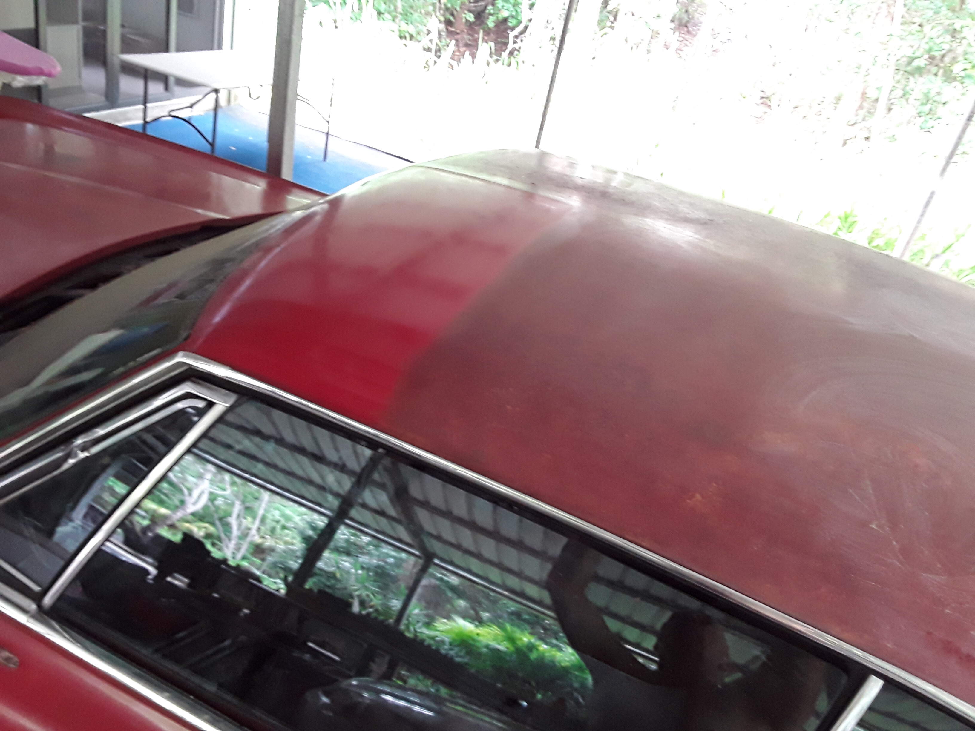

As a result, my roof is a mixture of faded paint, old vinyl glue, rust and patches where the paint has disappeared and the metal has oxidised, turning black. So, being on my regular tight budget and armed only with sandpaper, several paint cleaning compounds and lots of elbow grease, I have begun the tedious time consuming process of bringing my roof paint back to life. If you have a similar circumstance and don't yet have the funds for fresh paint, you can try this:
Because the paint was in such poor condition, I started with 80 grit wet, eventually working down to 400, then 1200. Cutting compound, then a good quality cut & polish (I use T Cut) then a final clean with regular cut & polish, and finally a coating of wax. Have a look...

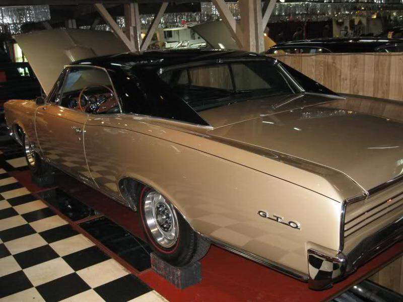

Looking good. Hagerty Barn Find Hunter brought an old ford back to life with similar paint issues.  If you car had a vinyl roof and the trim is still in-place you could paint the roof in a stain to mimic vinyl look. I don't know about '64 but in '66 you could get a painted roof as opposed to vinyl but it would be in gloss. Just a thought.  Cheers.

Hi Sprint, sorry about the late reply (I'm still lucky enough to have a job and just got back from 2 weeks away.)
I never even considered a painted roof as an option. That GTO looks great in that combo. I love the way the GP has that flowing hardtop rear sheetmetal and I think I'll keep it in one colour so that the flowing lines continue to, um, flow.
