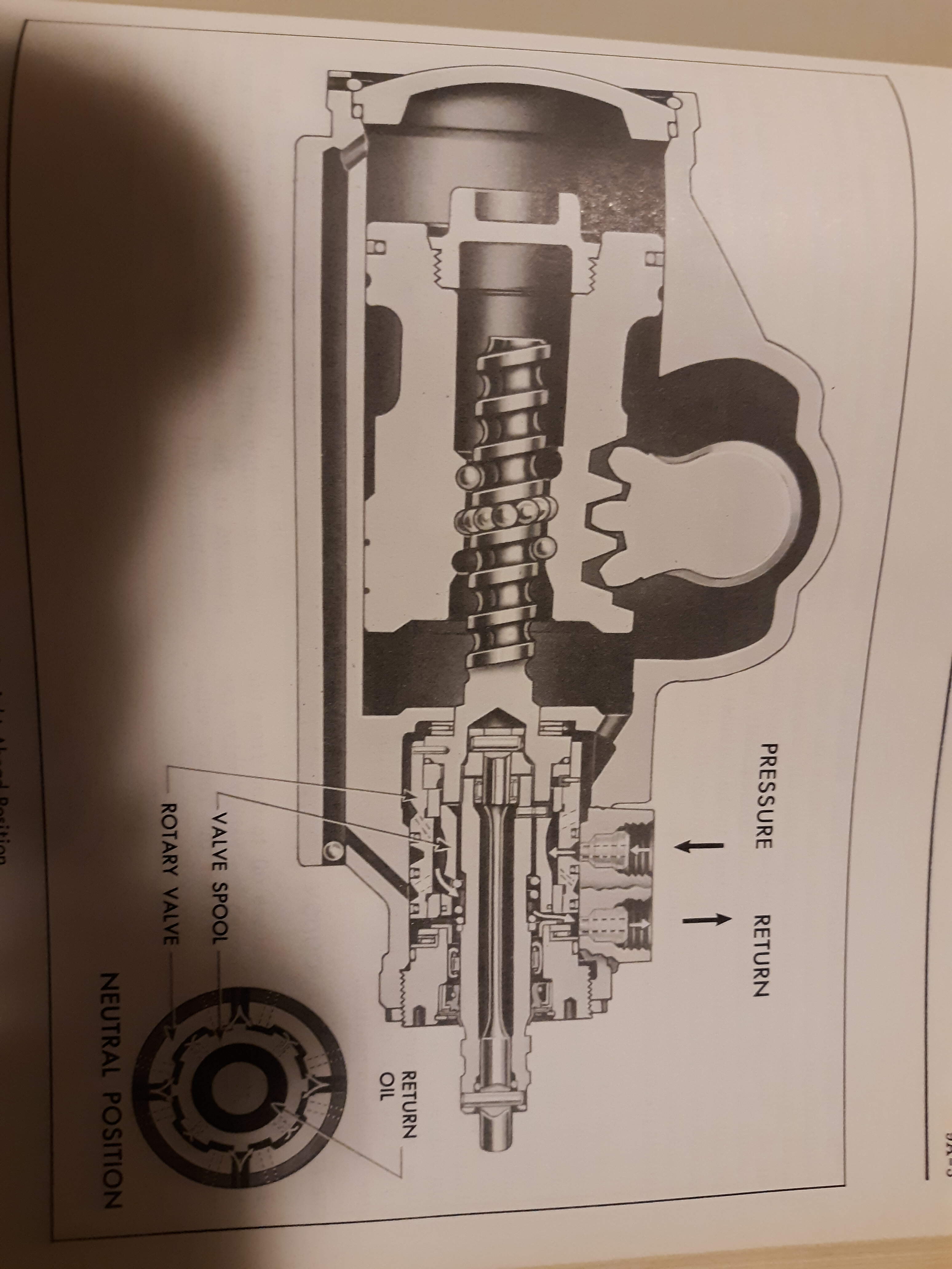

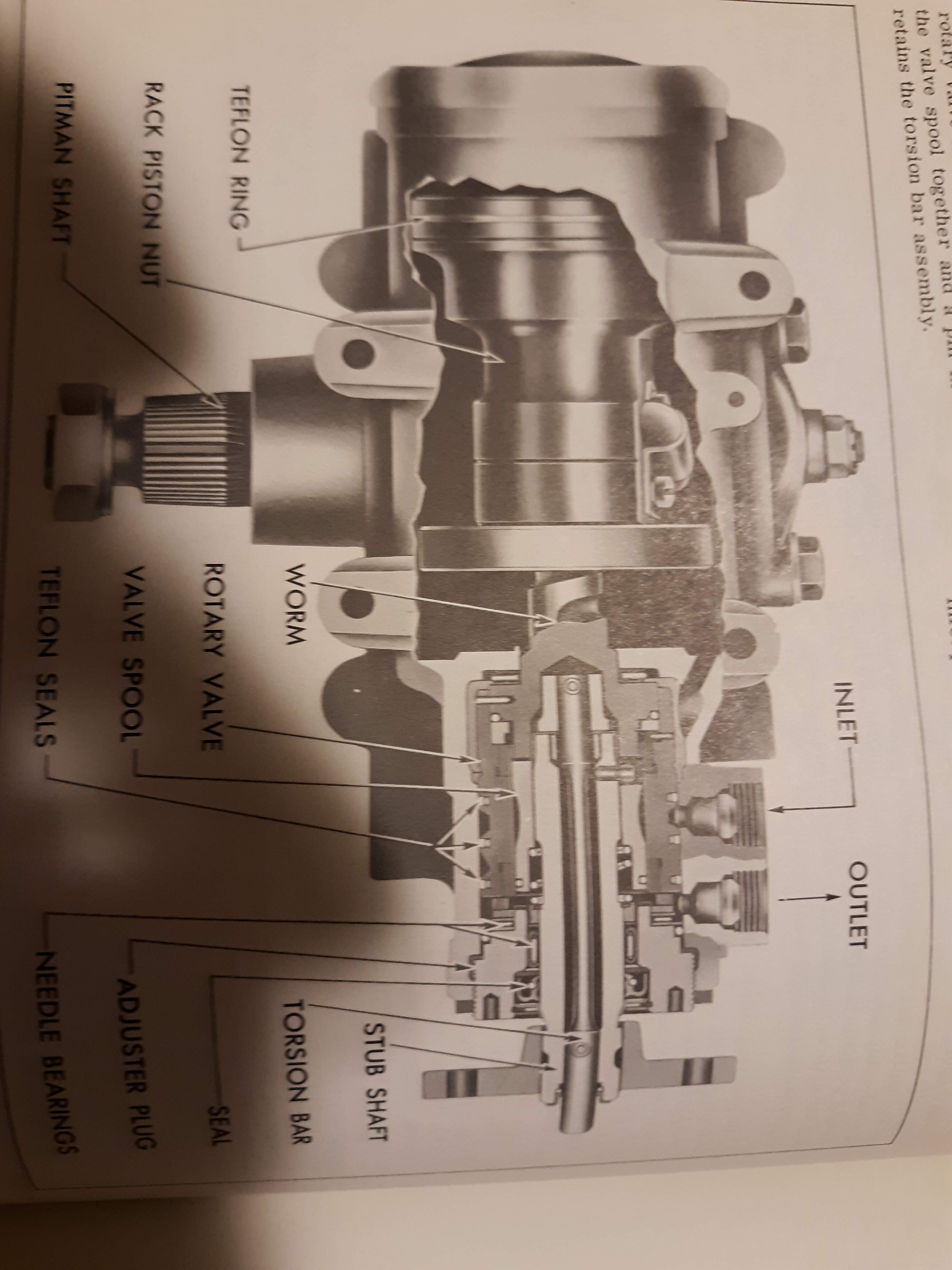

Hi Frosty-thanks very much for the info. You know, I reckon I might get by with simply disconnecting the hoses, removing the pump, expelling all the fluid and hey presto, Armstrong steering.
I need to get under the thing and see if there's a ram that does all the work, or if the fluid going to the box is the main driver. Without the ram, I reckon I can disable the rest and put up with the heavy steering. I must admit here that I love all sorts of cars, but this is my first US GM experience, so I'm learning as I go.
What exactly is the issue with your power steering..??
Both the pump and the steering box are serviceable units and can be repaired and/or rebuilt...
Thanks Two Lane. Somewhat embarrassingly, I actually own that same shop manual and have already read those pages that you kindly posted! I'm on a road trip at the moment and was reading up on the conversion on a Mustang site-clearly Ford use a power ram to take care of the effort.
I'm gonna drain the fluid from my box and see how she goes!
