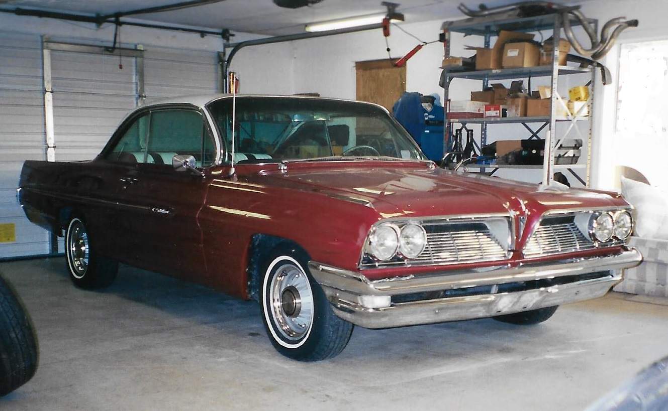

Hi there very new to the pontiac seen. Just bought a 61 star chief and I love it. It's got the 8 lug rims and drums very rare from what I see. Well I dont like them and trying to find out if you can but regular drums with just the 5 lug pattern so I can run any aftermarket rims I want.  If anyone can help i would greatly appreciate the help

IIRC the rear is a direct swap but the fronts are a complete assembly.                                                                                                                                                                                                                                                     Thus you don't have to change the spindle but will need a full standard drum assembly to replace the 8-lug wheel.
                                                     I have to say you are the first person I can recall that does like the 8-lug 😲 but it's all good!   👍                                                                                                                                                                                                                                                                                                                     Cheers.

Thank you for responding. There are a few reason I was wanting to change them. One of the reasons is bc I cant figure out how replace the drums without spending alot of money. And I talked to a company that restore them and he said they have a tendency to separate with corrosion and I wont be able to true them up. And he charges 340 a rim to fix them.  The guy I bought the car gave me new shoes bc the brakes are bad. But my concern is I wont be able to get the drums turned. I will be doing the brakes this week so I will know which one is the issue.
Also have you heard of those issues? Or is it just like any other drum set up? Just change the shoes and get the drums turned and I'm all good? The car is in great shape so im suspecting that the shoes are worn out. But there is definitely alot of vibration in the pedal

Beautiful ride bro. Good luck with her.
Yes there were reported corrosion issues with some between the Aluminum and cast insert.  Any good old school brake shop should be able to turn them as long as they are still within spec.  Yes having them RE-Lined can be pricey but once done correctly and maintained they are worth it if your wanting to maintain the OE wheels.  IMO your going to be spending some good coin which ever way you decide to go,  weather its restoring what you have or buying all the needed parts to switch back to standard drums.

Thanks for the advice. I got them off and it looks like I might have one small spot on the rear. I'm having them taken to a shop to get turned today. I'm just hoping there still enough there to turn. I've got my fingers crossed. Bc I'm not sure what the specs are. So I'll see
