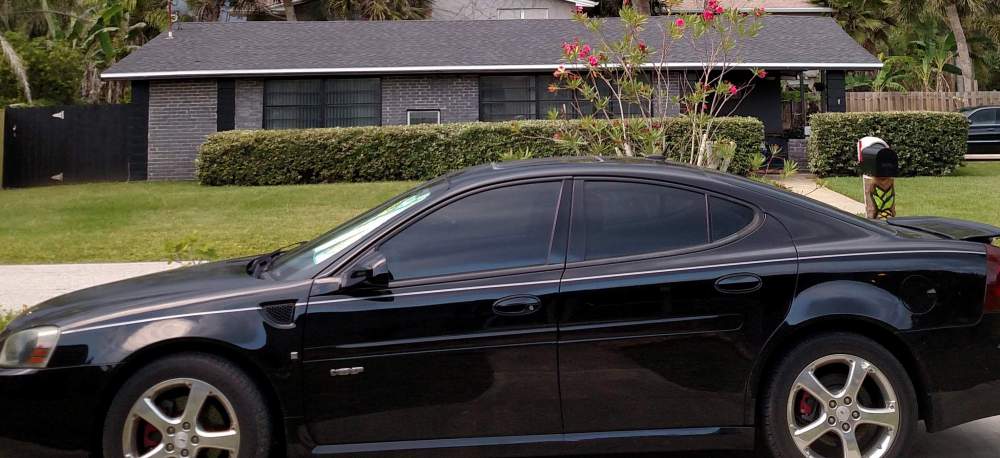

I need to buy new headlights for my 2007 black Pontiac Grand Prix GXP (86,000 miles, original owner, excellent condition). I'm kind of a purist but am leaning towards the new LED style for better visibility at night. Thoughts between sticking with the original factory style or upgrading to the new LED style.... also, if you have a suggestion on where to buy them... Thanks
