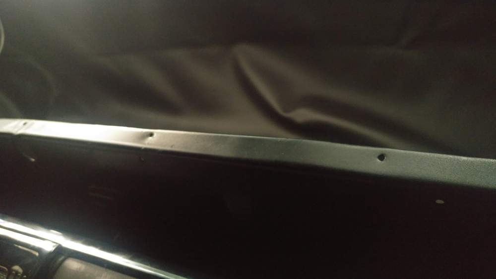

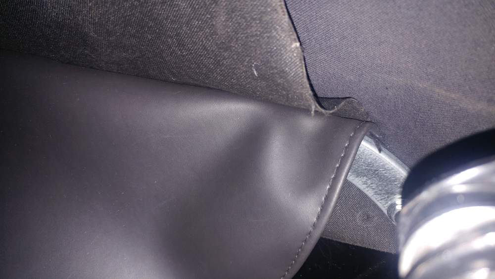

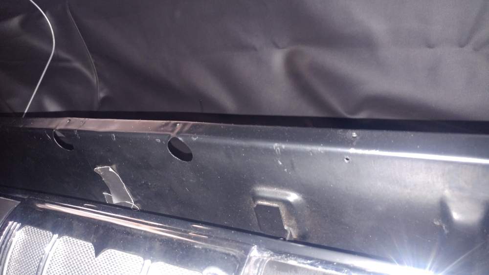

Thank you Sprint 6. I suppose, "draped over the rear seat retaining strip" is the closest so far but, as you can see from the pics, there are some holes on top of the rear seat backing panel that gives the idea of screws to attach the well material but then again maybe not. If not then the material would be glued after draping over. Would you agree? The other pic shows that I did fasten the rear end of the well material properly. Bud

On my Lemans convertible, the convertible top boot cover is screwed (via sheet metal screws) to a retaining bar directly behind the rear seat. I suspect your boot cover might attach  in a similar fashion into the holes you see in the top 2 pictures.
