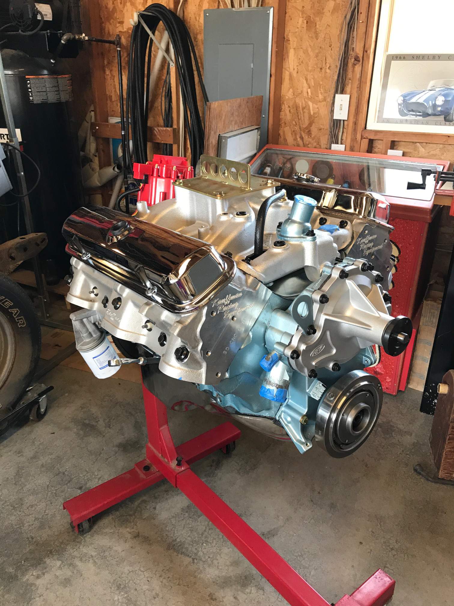

My engine is back home. Should be getting the flow sheet soon. As it sits, KRE heads modified by SD Performance, port matched Torker II, Comp Cams roller cam, H beam rods, forged aluminum pistons, .040 overbore. I did go with the HEI ignition. It's cleaner and more simple. Less parts , less failures.
Sweet combo. I can’t wait to what she’ll do both on the dyno and in the car!
