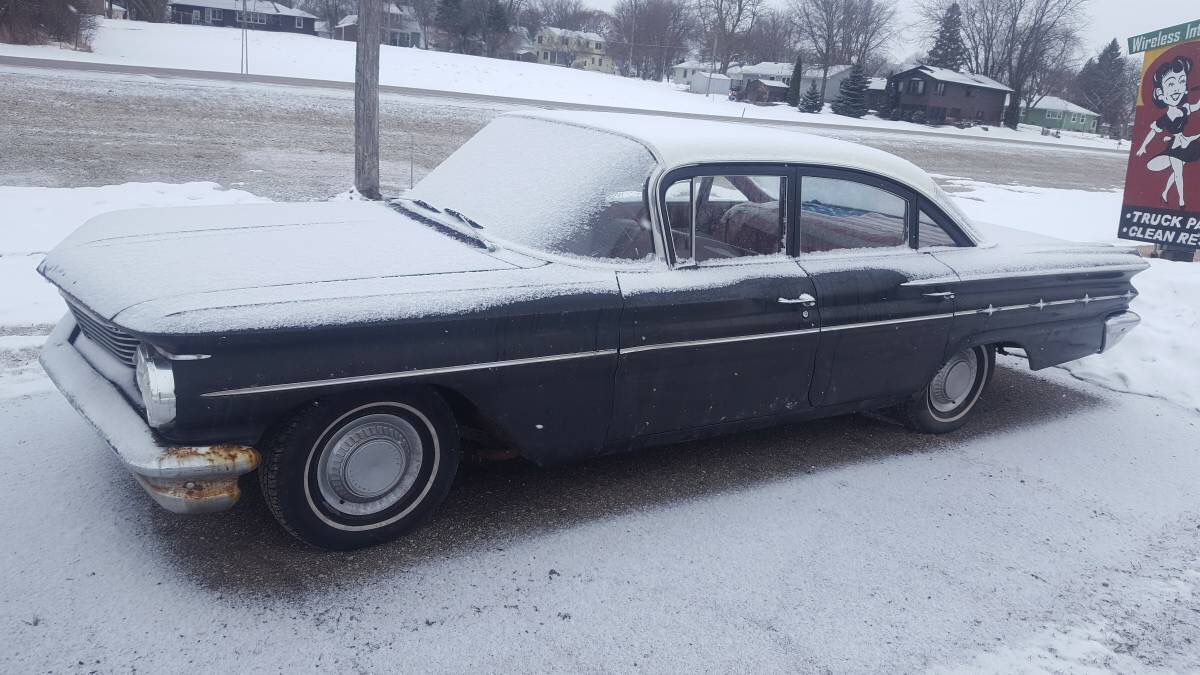

Found a 1960 Laurentian for sale on my local Craigslist. It says it has a V6 in it and that’s its originally a Canadian car, brought down to the states.
Anyone have some good info about it?
Are Catalina parts 100% transferable to it?

Pontiac's of that era built in Canada are just basically Pontiac Bodies on Chevrolet Chassis. Thus why you couldn't get a WIDE-TRACK Pontiac North of the Border. Being on a Chevy chassis means it also would be Chevy powered and if the 6 under the hood is original it's going to be a Chevy inline 6. The Only Pontiac Engine in a Canadian Built Pontiac that I'm fully aware of is the OHC 6, but I'm sure there had to be a few other offerings.
Edited by SPRINT 6
Spint6 is spot on with his response. The chassis of a Canada-only built Pontiac like the Laurentian were Chevy-based. Some Catalina/Bonneville body parts do interchange but others don't. Therefore you must be careful. So to answer your question about Catalina parts being interchangeable with the Laurentian, the answer is no, they are not 100% interchangeable.
As for the engine, it should either be an inline 6 or a Chevy V8. If it is a V6, it is definitely not the original motor as the venerable Buick V6 aluminium 215 cu in wasn't developed until 1963. All other V6 engines from GM were developed much later in the 1970s and beyond.
That said, don't let this diamond in the rough dissuade you from buying the car if you are that interested. Even at an all Pontiac show here in the U.S., you will probably be the only one. There are Canadian Pontiac clubs that can help you find parts. Also the Pontiac Oakland Club International (POCI) embraces these cars too. So you can reach out to their technical advisers and try to use them a a resource to find unique parts.

The ad said 6 cyl, so I wasn't 100% positive on the engine. I'm sure its an I6. I'll have to go out to take a look at it then.
The owner says that it runs and drives great and that its used as a everyday errand runner. It also only has 60k on the clock. KMs I assume. Lol
