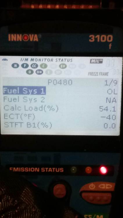

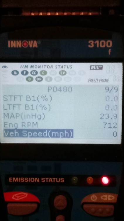

I added a couple pics of the scanner data. It showed the code p0480 and don't remember other number but it said cooling temp sensor the p0480 is #1 fan but I noticed that fuel system 1 has OL can't find a reference for that my thought was Off Line. Also the STFT & LTFT are also part of the fuel system and they are at zero. Are you familiar with any of this info. It may mean nothing I am not familiar with these scanners at all. Thanks for any help
STFT= short term fuel trim
LTFT= long term fuel trim
OL= open loop which means that when the engine is cold the MAF (Mass Airflow sensor) and the Oxygen sensors are not talking to each other and is running on the factory cold start parameters.. (rich)..that are stored in the PCM (Power control module) As the engine warms up it goes into closed loop..Which is where the coolant temp sensor comes into the picture... When it senses the proper temp..It tells the PCM.... Then the MAF and the O2 sensors actually start communicating..Adjusting timing..fuel mixture (leaner or richer) fuel Injecter pulse width...ETC..According to the throttle position..Temp..humidity and driving conditions...ETC....That is also why a vacum leak can cause it to idle up and down..When extra air is introduced into the system between the MAF..and the O2..It sends the PCM a confusing signal so it  idols up and down to try and compensate...for the extra air...
Also when the check engine light is on it sends it into open loop...(rich condition)...
The fuel trim is basically what the mixture of air and fuel is over different time periods....

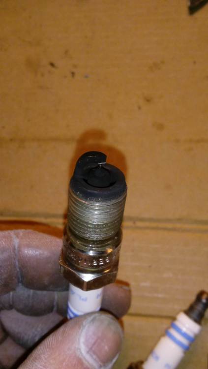

That's great feed back I appreciate the info! I'm mechanically inclined but when it comes to all this computer stuff I'm a bit behind the times. After I finished the engine I installed new Bosch plugs thinking they are new I didn't think they could be a issue. Friend came out to help me and he could hear what he thought was spark arching so I removed cover and sure enough #1 plug was cracked in half. Put in a old one and it started and idled a lot better. I'm going to pick up a new set of NGK plugs tomorrow. I have heard this engine is picky about plugs. What's your thinking on this? NGK double platinum?
It's funny how you get tunnel vision when trying to solve a running problem. It took all of 5 min for my friend to resolve my problem. What have I learned from this? Take a step back and start with the basics. I found that three of the four Bosch plugs I bought were defective. The ceramic piece was loose and apparently causing spark to arch. I've heard a lot of bad things about Bosch plugs now that I have experienced them I think I will stay away from them! TWO LANE BLACK TOP I truly appreciate the impute. I'm happy to say the car had its first test drive tonight and ran great! I forgot to mention that I had also failed to reconnect the temp sensor and from your info on the scanner readings that would have also caused some issues and thanks to that info made me check the temp sensor! Thanks again!
