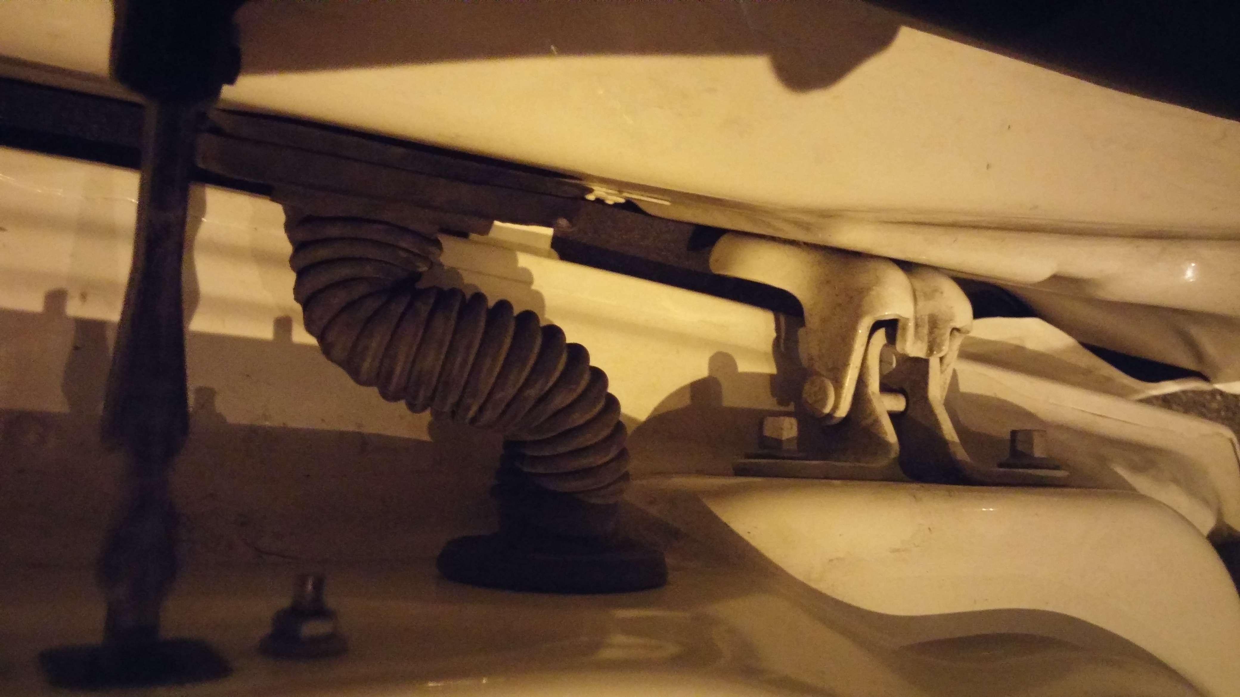

Problem: Doors will not lock or unlock from the driver door control panel. Doesn't even make noise or show any attempt to work when clicking the button. The passenger door panel switch does work, but only for the 2 front doors. The rear doors to do not look or unlock unless by hand. Up until an hour ago, the driver door panel was completely useless. It wouldn't allow me to roll the windows up or down, but after messing with the boot/harness/accordian (picture attached) between the door and the car, the windows started to work again.

Does the entire system work off the key fob?   Press once to open drivers door. Press twice to unlock/lock all doors.  If you were moving the wires in the door cover and some things are now working,  I'm guessing you have a bad connection or broken wire.
