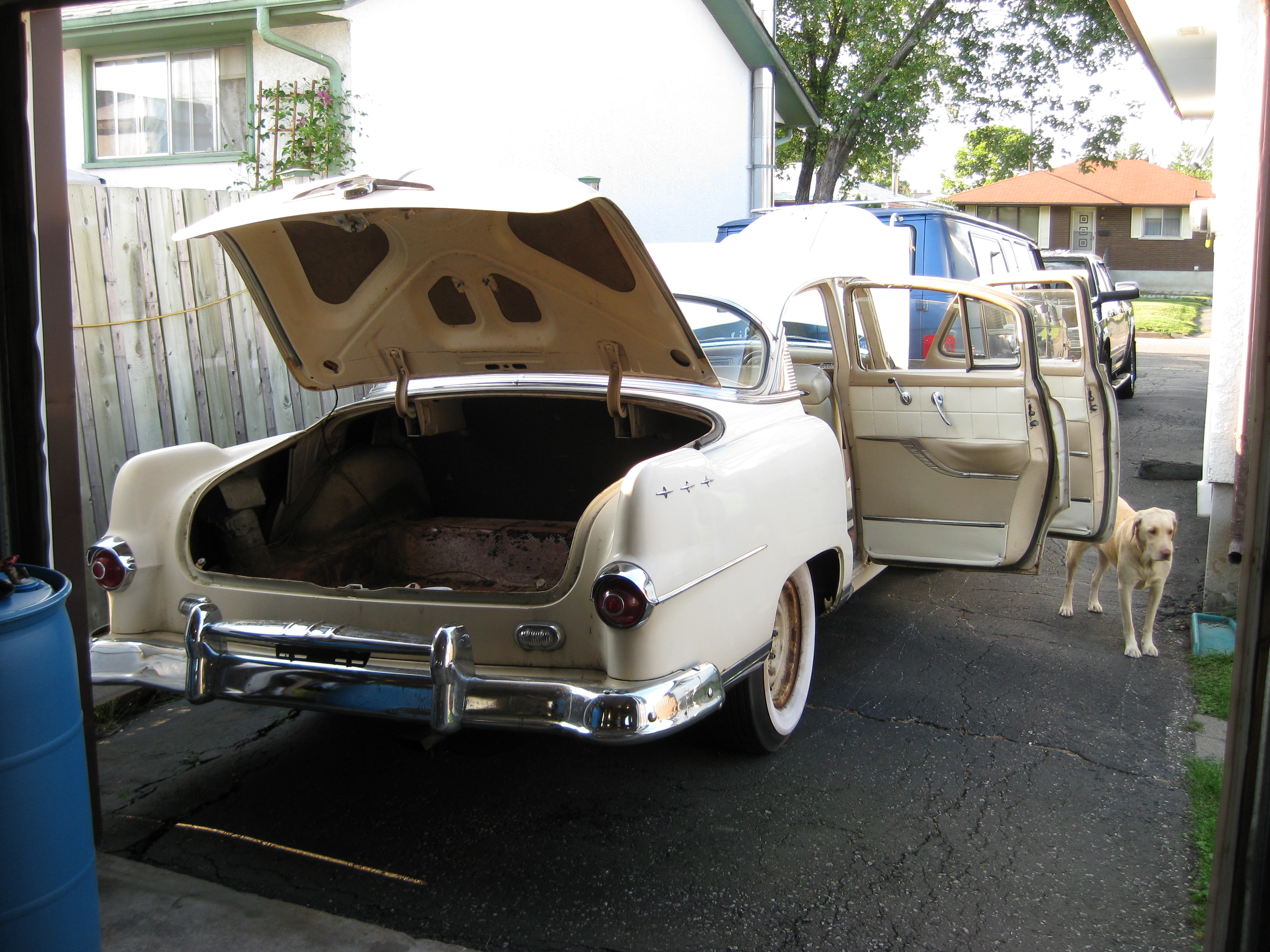

When I got my '54 I noticed the bulb was missing from the trunk. I put one in and it lit up. I can't for the life of me figure out how it turns off? I can't find a switch anywhere. I've tried every switch thinking it was located somewhere else.  I know I could install a manual one but I'm trying to keep the girl original. Until then, the bulb stays out. Any one have the same?

I did the video check and the bulb stayed on with the trunk lid closed. Maybe the PO removed the mercury switch and never got around to installing a manual one? Maybe I'll never know unless another '54 Star Chief can chime in. Just another wiring conundrum to work on this winter. Thanks for the hints guys!
