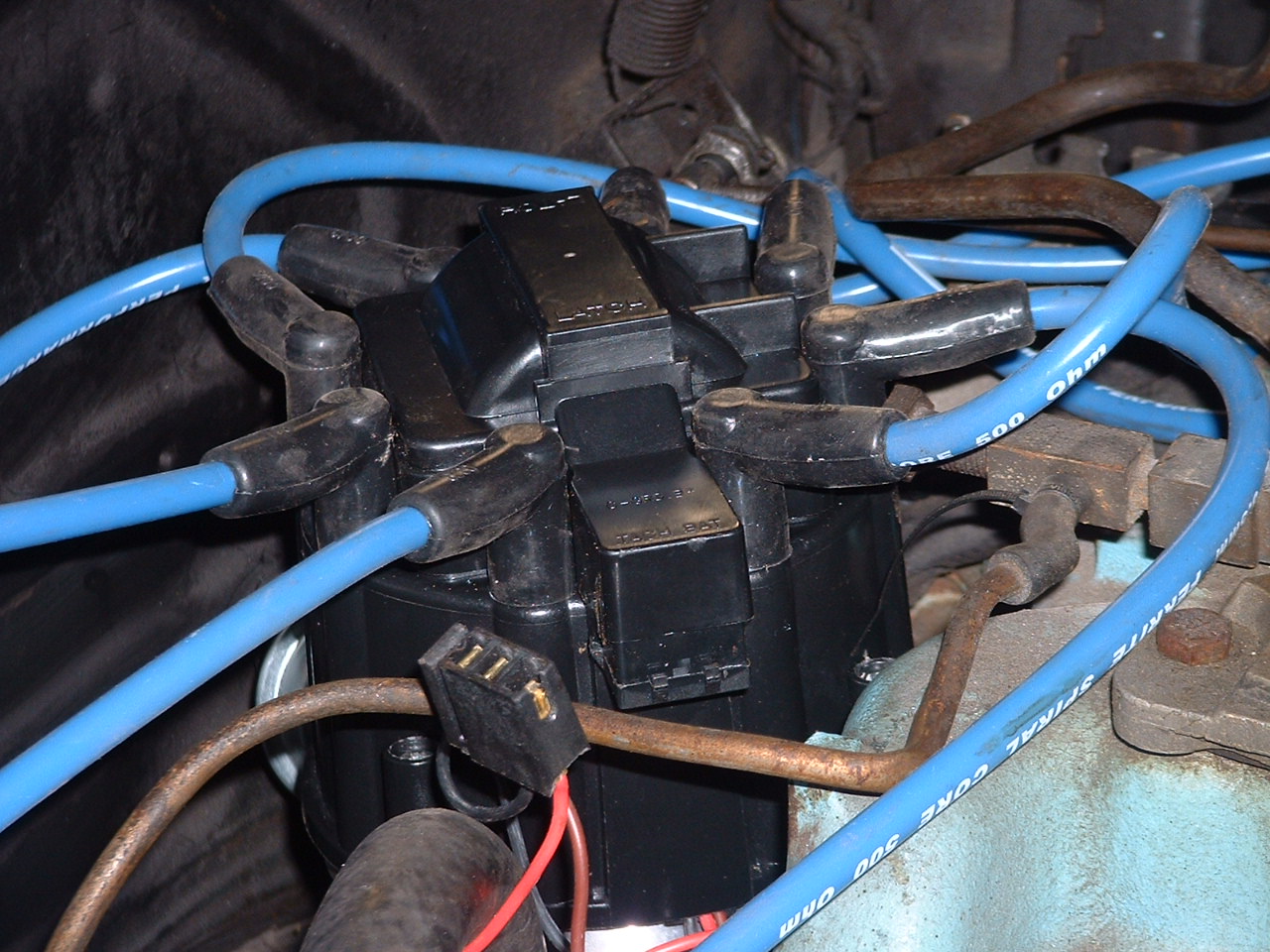

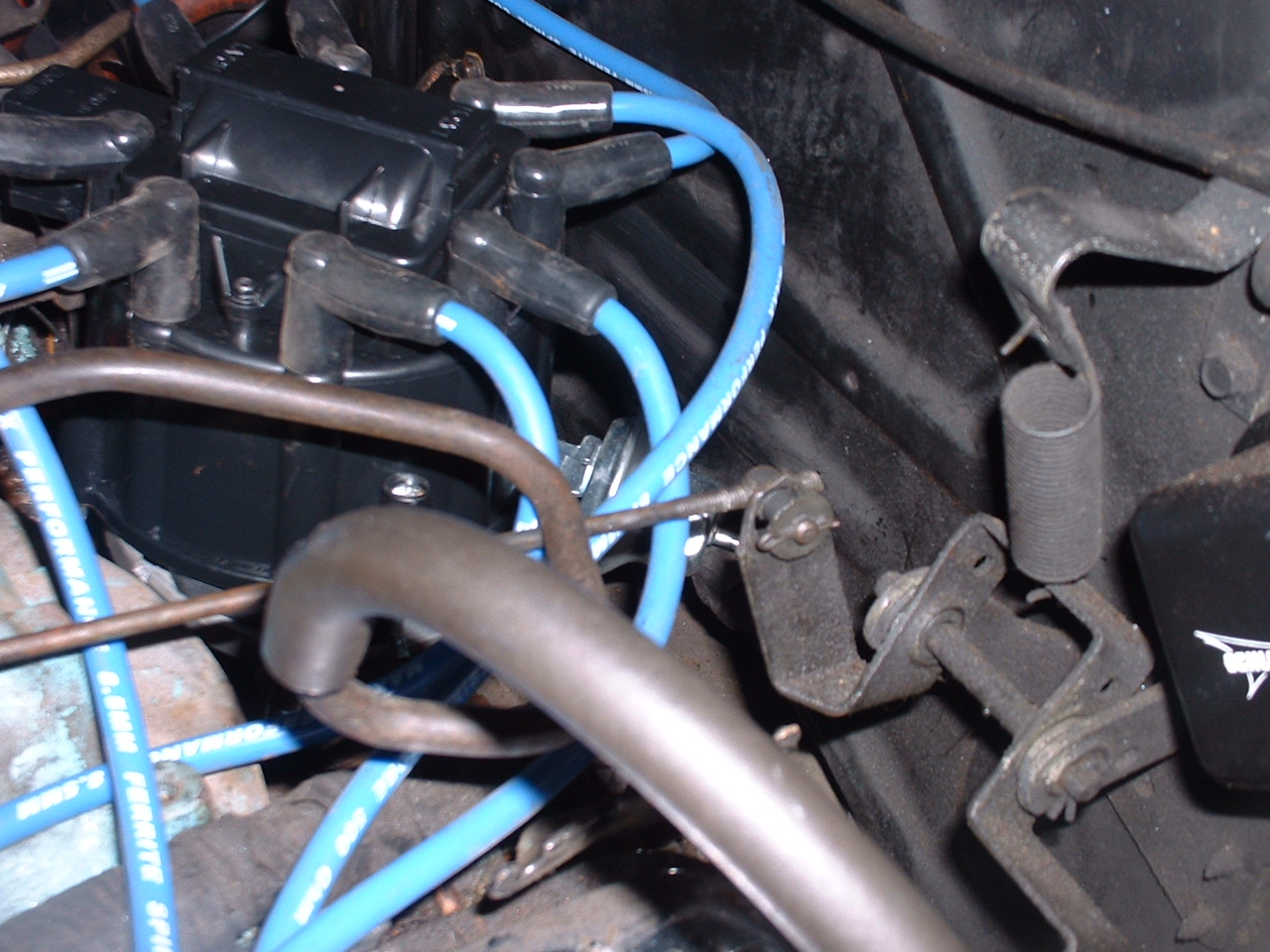

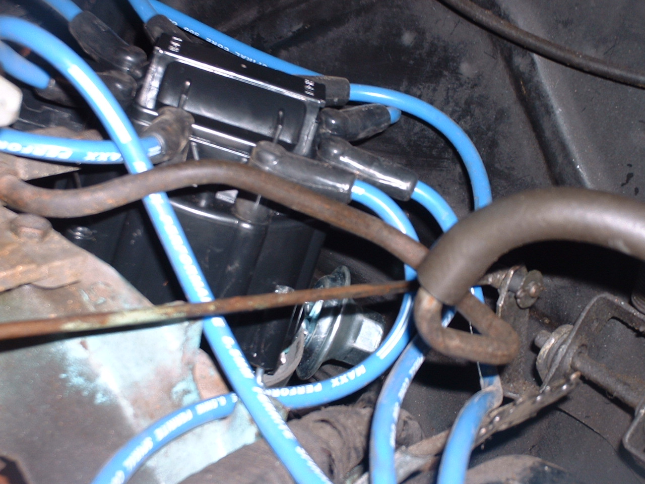

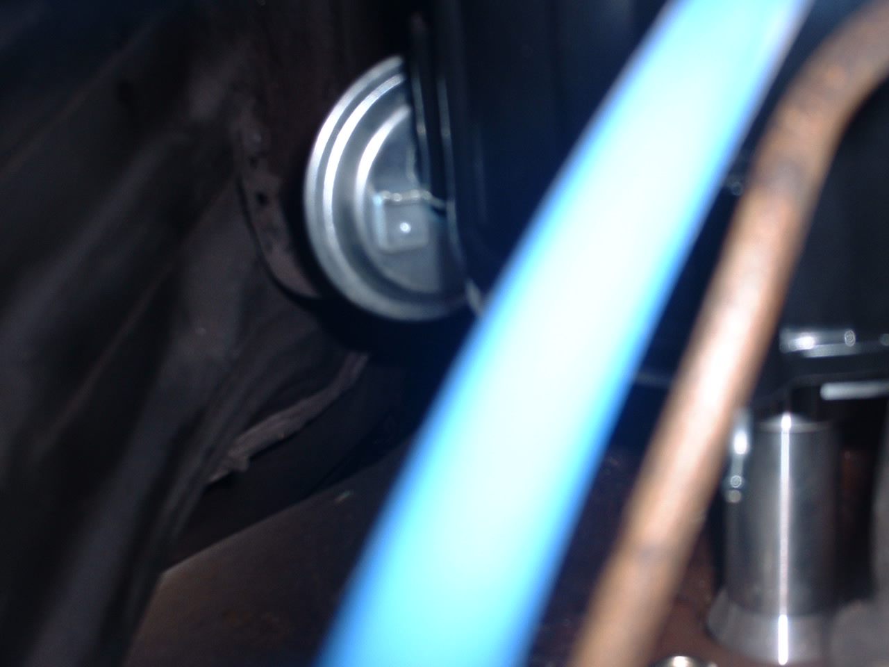

Ok guys two more questions and I'll be out of your hair..Anyway got my timing set and sounds pretty after it has settled in.Now my questions are can I move my wiring around to kind of clean it some but staying in the correct firing order.And my Second question is can I move my vacuum advice position with out having to to actually lift the dist out or can I lift just enough to move it.The reason I am asking that is that the advance is close to firewall and with the HEI with coil inside the wiring is very close to the carb.

Hope this helps..as you can how close the advance is to the fire wall just hoping to be able to slightly lift the dist and turn advance closer to  engine. And the wiring in a better order as you can see in pic 1 turnning the dist also turned the wiring.
Looks like what you might need to do is find TDC again....pull the distributor unhook all the wires off the cap...with the dist out put the cap on it..Orient the vacuum diaphram where you want it...you can use any terminal on the cap that you want as #1...when you decide which terminal that you want to use as #1 put a Mark on distributor base in the center of where that particular terminal is when the cap is installed...remove the cap reinstall distributor with the rotor pointing toward the position where #1is going to be...when the distributor drops in the rotor should be pointing close to the Mark you made on it...the rotate the base so that the Mark is right at the leading edge of the contact on the rotor...Shouldn't have to move very much.... tighten holdown just right enough to turn by hand reinstall cap put wires back on in order starting with the #1.... With the Mark on the base lined up with the rotor as indicated the timing will be within a couple of degrees of the final setting......might have to move the rotor a tooth one way or the other to get it exactly where you want it.....to keep vacuum diaphram where you want it and lined up with #1

I thought I could put the wiring were ever I needed as long as I kept the firing rotation in order.And was hoping that I could by just lifting the dist a little but might be more trouble then just taking it out doing it that way.Like to just move my advance more towards the engine and the dial it in which should give me more room.
