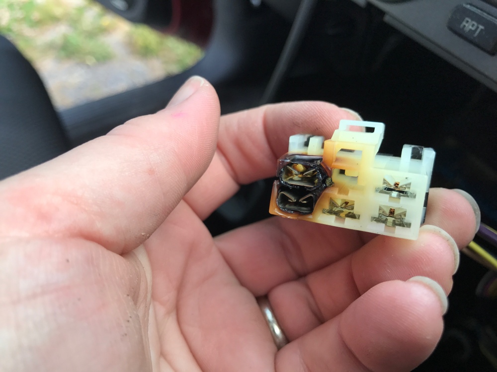

So my wife, ever the badass, looked into some issues that failed state inspection here in VA. She was also concerned about the blower switch after the blower resistor didn't fix her single speed problem. She pulled apart her dash console and found the attached connector issue on the blower control side of the wiring harness. So, we need to replace the harness. However, my google fu is not strong, and I can't find the actual part name or number.

Brian1313 - Sorry to hear that you and your wife are experience this issue. Based on the photograph, can I assume that this was plugged into the back of the blower control switch or was it plugged into the blower motor/fan itself? I am guessing it is the switch giving the multiple leads but I want to be certain.
The blower motor is run by a 40A circuit. So when a resistor breaks down, that much current is going to fry something downstream eventually. It is one of the highest current systems in the car. The blower resistor problem in the Torrent/Equinox/VUE is sadly, well documented.

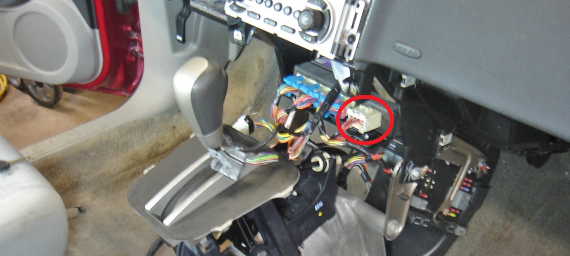

I was able to find this photograph online from an '06 Equinox. Is the connector you are holding in your photograph the same on I have circled in red?
Since my wife was the one who pulled it apart this morning, I'm not sure which it is in the photo. I believe it was plugged into the back of the blower control switch.

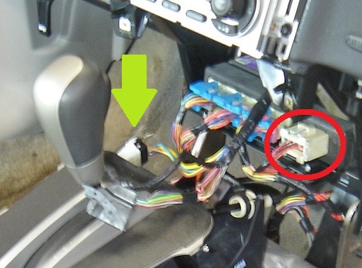

I think it might be the one tucked behind the shifter knob.

Matches the connector. I believe it would tie in to the instrument panel harness which is bloody expensive to replace the whole thing. If this is the right connector, (will confirm at home), then I'll just need to test continuity of the harness to the connector for the blower motor resistor, right?
Just based on the wire colours, it's definitely not the one Frosty circled.
The connector my wife is holding plugs directly in the Blower Control Switch. It is not the red circled connector Frosty thought it may have been.

Sorry I have been a tad preoccupied putting my own car back together Brian1313. I do believe your research does match up to the part your wife is holding in her hand. I would certainly try purchasing it to see if it matches up. If it doesn't, you can return it. The description from Rock Auto also lends itself to being the correct part too.
