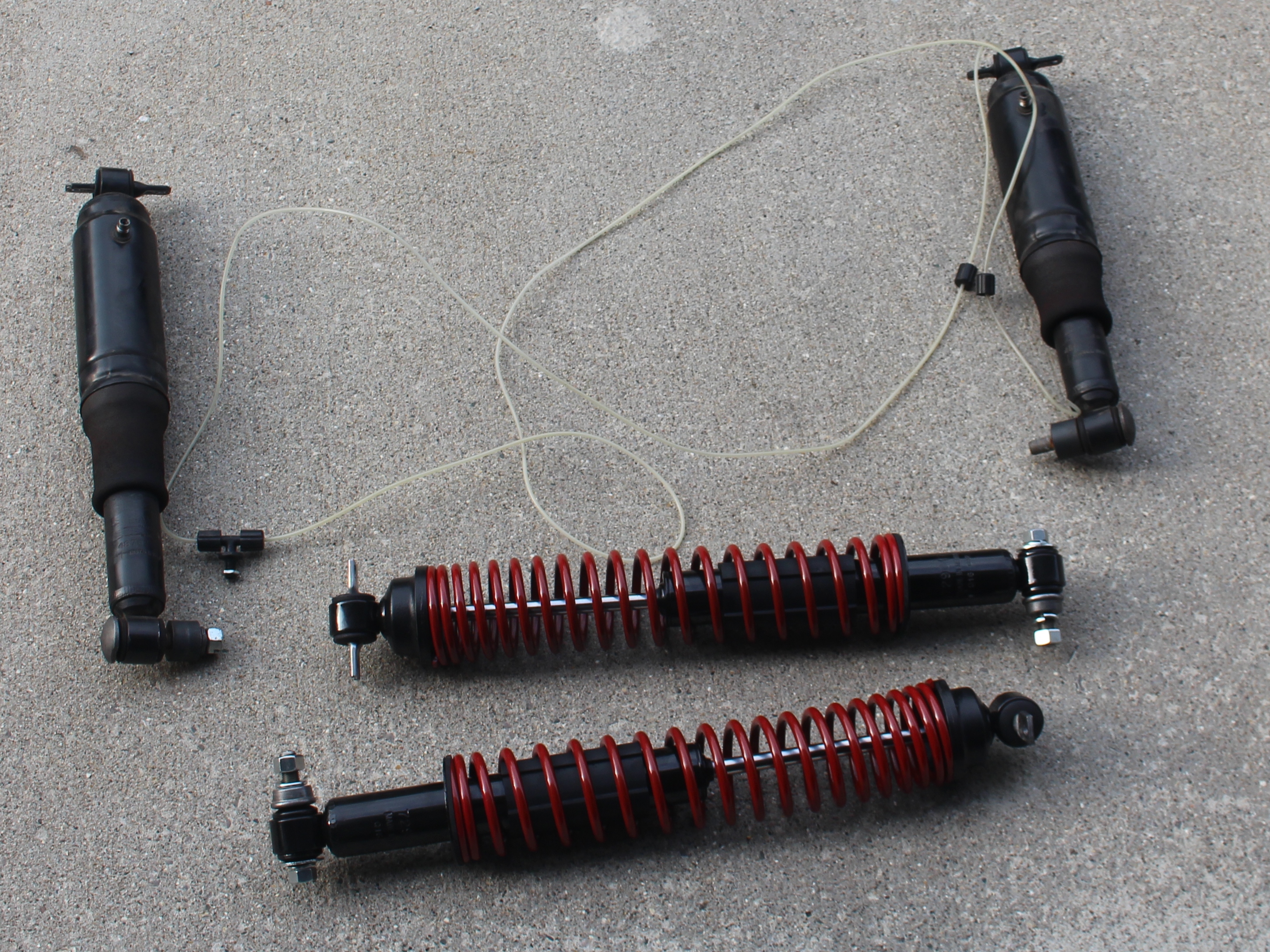

Out back is a little more complicated. Do you plan to haul a lot of people and/or luggage/tents/car show chairs/coolers, etc, etc, etc. that could weigh down the back end? Again, I would probably start with a premium gas shock. If you think a lot of stuff or people will be needed to be lugged around that will weigh a ton, then perhaps a set of rear air shocks from Gabriel is the ticket. I had issues with my air shocks during a recent parade with my whole family in my Lemans convertible. Since my wife complained about the ride, I decided to try something new. I got a set of Gabriel "Rear Spring Assist Shocks" which is a gas shock with an added coil spring to help support the rear spring under heavier than normal rear loads and I don't have to rely on air pressure to keep them up. Everything is mechanical.

Frosty, I am mostly interested in getting the thing nailed to the ground a little better. The mileage is so low that I believe everything to be factory. Looking at the front bushings they are not really worn out but the exposed rubber is rotting away. My guess is that the shocks all around are factory, yes 54 years old. The ride height will remain stock and for the most part the only thing that will see the rear seat will be the dogs. As stated the few miles I put on it it reminded me of being in a boat just floating along.
Back when I did this for a living, when we were still washing dinosaur poop off the tires, the go to shock was Monroe but there are so many shocks out there now all making different claims it gets a bit confusing. If I am correct that the shocks are the originals ANYTHING will be an improvement but what is best? Frankly I have not changed a shock or strut in the last 30 or so years except for the front end rebuild on the 500SL basket I resurrected. For better or worse the newer iron seems to last a lot longer. I may just go with a set of Monroes all around and see how they work.

Monroe is a decent shock, but KYB makes some nice gas adjustable shocks, but I would still consider air shocks for the rear as Frosty suggested, no matter what you do or don’t carry, just adjust the air accordingly.
