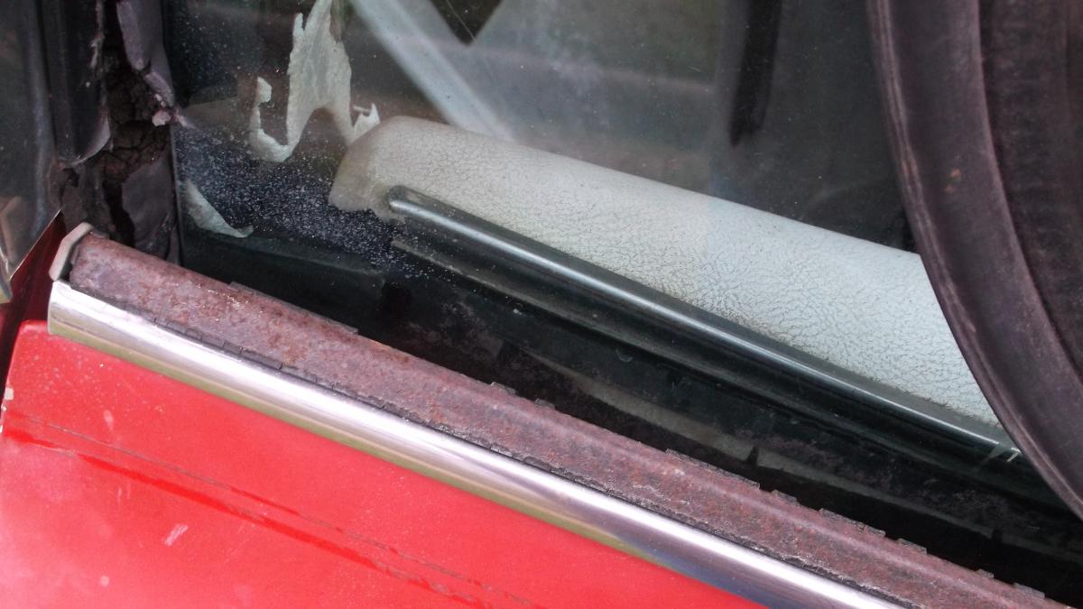

Hey fellow Pontiac enthusiasts, where would I look to get replacement door and trunk seals? When the car arrived, It was like completely rotted away and the h2o can just go straight into the doors. Also, isn't there a trim piece that should go where the top of the doors meet the windows? post-2540-0-06785300-1437951849_thumb.jp

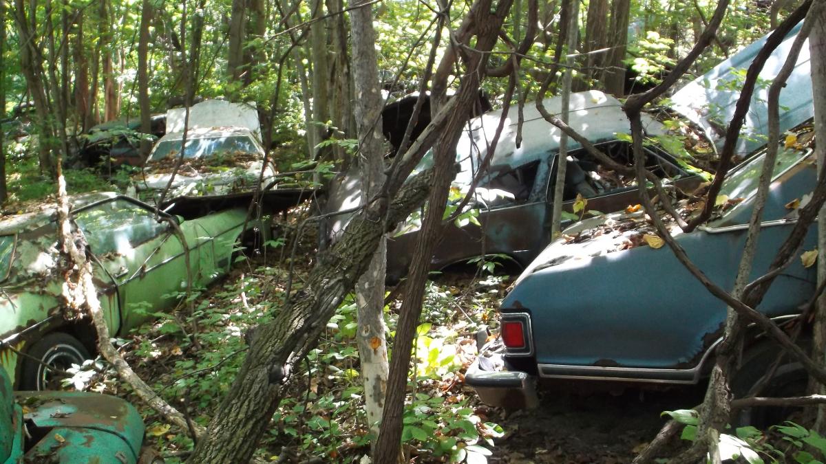

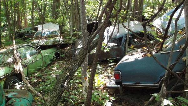

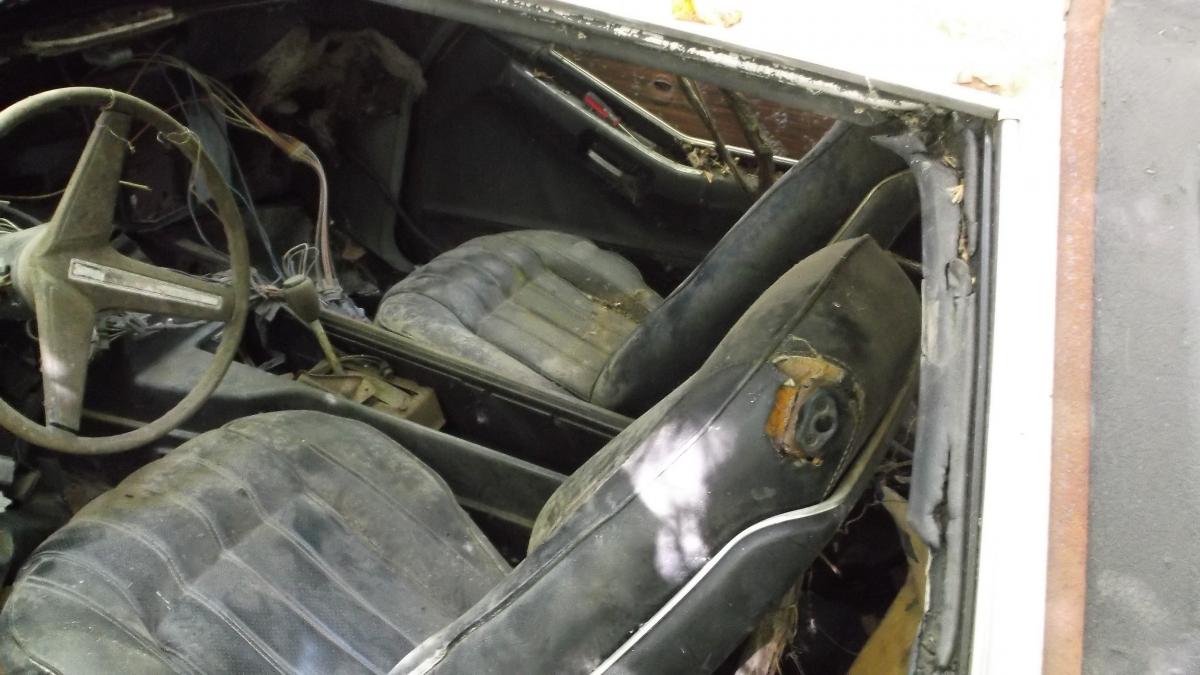

After further searches, I found that Ames has a ton of stuff for many older makes and models. I'm also going today to strip the interior out of a '76 SJ at a local junkyard. Surprisingly he has 6 of them among many classics...  (The only thing saving them from the crusher is the difficult location they're in) I will post pictures of the ol' GP's interior as well as the junkyards location and number if he doesn't mind -- for anyone in the Midwest looking for parts. Was shocked that for the price of 1 door panel online, I am getting the entire interior. More later fellas.
I, for one, love to see pictures of cars in boneyards. I can't wait to see what you have to post.
