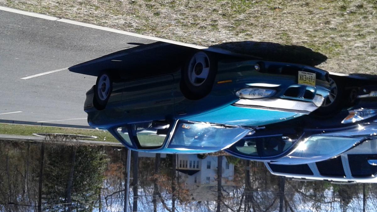

Hmm mm can't figure out how to post pics from my phone, but as soon as I do I will
post-2417-0-43509000-1428343390_thumb.jp
It's upside down.....whatever haha you get the idea
