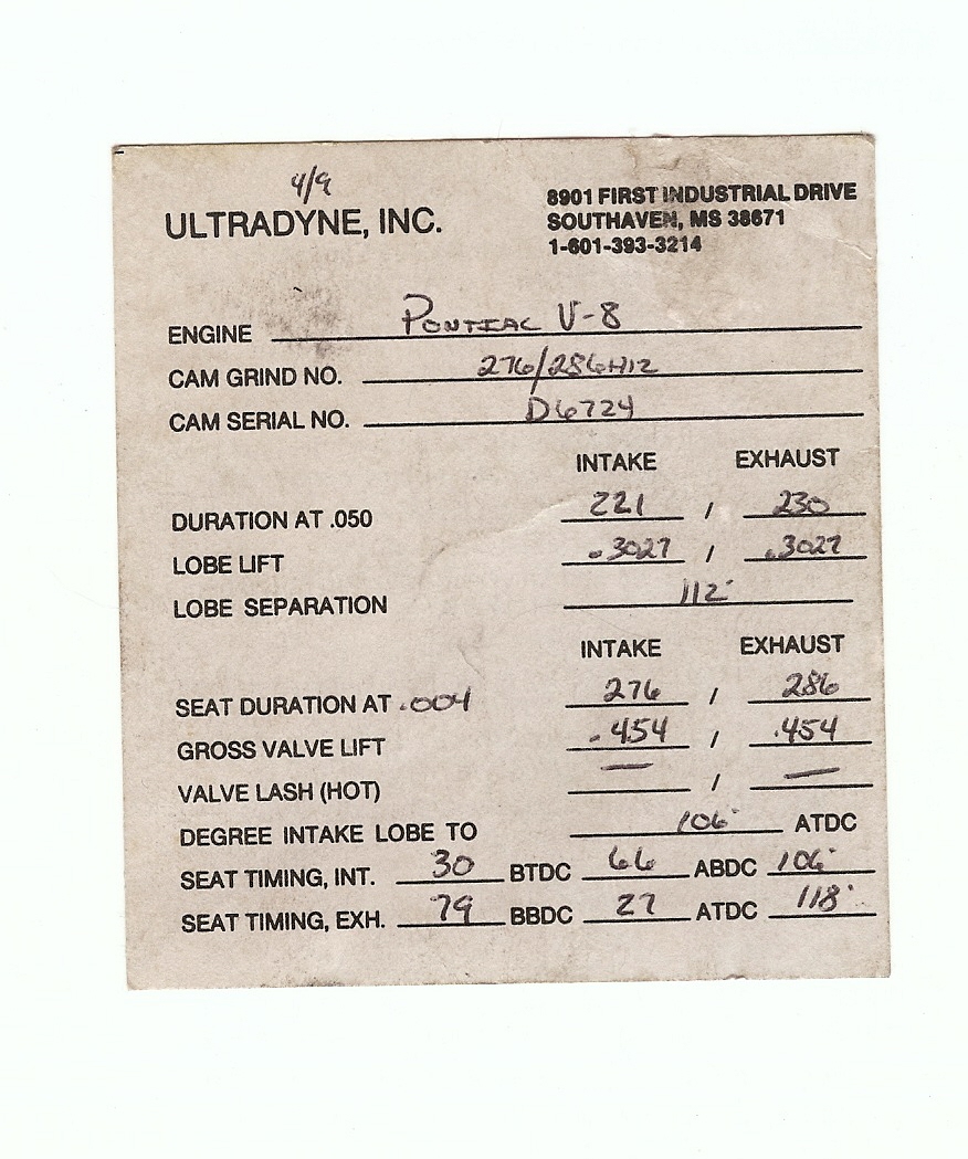

My Ultradyne cam specs are attached, it appears to be close to the one listed at the bottom of the list.

Based on your cam profile, it would appear your cam is the third from the top - the excellent 455 performance cam. All Pontiac 326-455 except the 265/301s are externally the same dimensionally and only vary by the bore and stroke combination. So this cam will work with your 350 motor.
