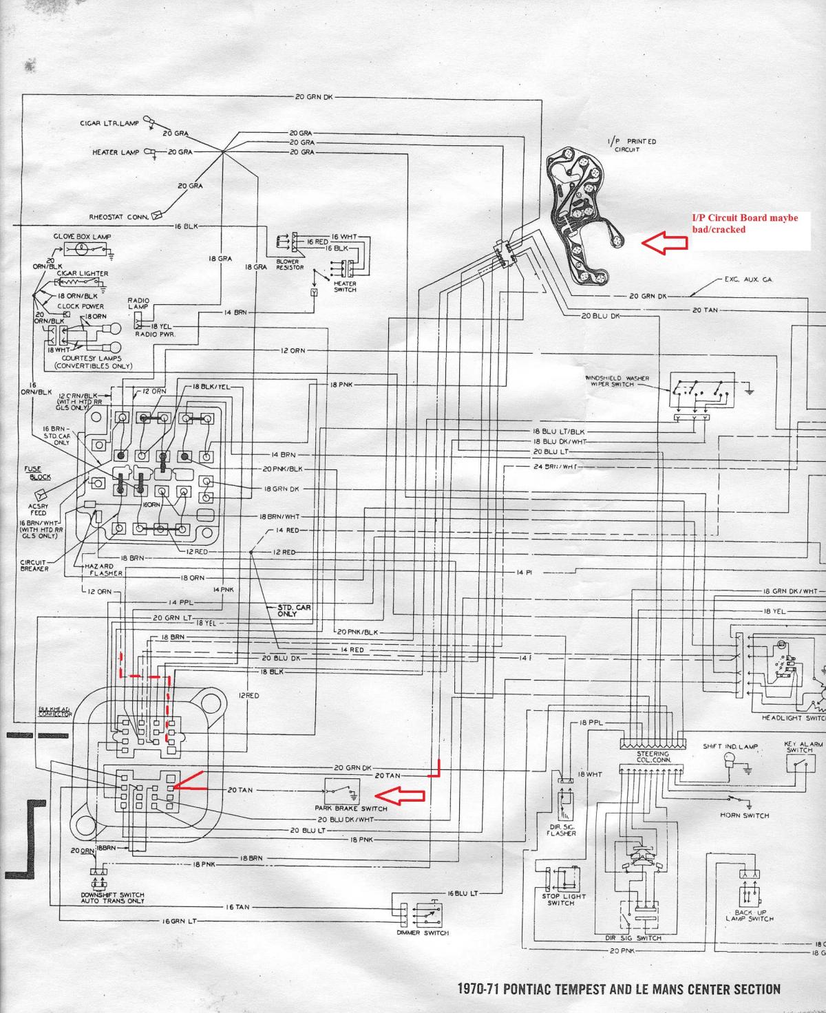

Alright, I have a couple of possibilities for you to check. I have marked up a page from the 70-71 electrical diagram manual. It should be virtually the same for your '69.
The parking brake switch is a 20 gauge tan wire that runs to the bulkhead connector and then ties into the cluster wiring harness into the back of the instrument panel.
1. Test the tan wire from the bulkhead connector to the I/P connector to see if it is broken.
2. Check to see if the I/P circuit panel from the I/P connector to the bulb is broken.
3. Check to see if there is power coming from the fuse from the 12 gauge Orange wiring going to the fuse panel (opposite half of the bulkhead connector or if the 12 gauge wire is broken.

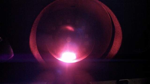

Frosty, I got it working, Turns out it was a bad socket..the second I swapped it it lit up. Thanks so much for your help. Your write-ups and documents are very in depth and I thank you so much for helping me with this
