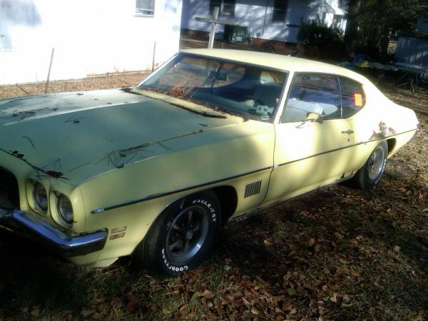

I have a 1971 Pontiac Lemans Sport with a 428 engine in it. How rare are these engines and are they reliable? I am thinking about pulling that engine out and putting in a LS3 pontiac engine in my Lemans Sport. Good idea or not?

It is an interesting engine/body combination, but it is definitely not original. The 428 was never offered in a '70s Pontiac of any size. They were only offered in the mid-60s large B & C platform cars. They are as reliable as any other Pontiac engine if built and maintained properly. If yours is in need of a rebuild at this point, I would definitely give consideration to the LS motor only because the 428 is not original to the car and you do not have a numbers matching car at this point anyway.
That said, the 428 is a strong motor and it is a somewhat desirable motor in the Pontiac world, especially if it is an 428 H.O.. It can be bored and stroked to a larger displacement if you so choose too. You can probably sell it rather readily too, in its current state, assuming the motor isn't permanently damaged (no crack block or heads).
The choice is yours.
Other things to consider with the LS3 will be the wiring harness for the engine and the ECM, a higher pressure fuel pump for the motor, possibly a return fuel line to the gas tank. Also, the LS3 uses the Chevy transmission bolt pattern so you will have to use an adapter kit to re-use your original transmission or you will have to get a different transmission for the car that bolts up to the motor. If you change transmissions, you made need an ECM for the transmission if you get a more modern 4L60E/4L80E. This may also require changes to your driveshaft. The yoke on the transmission side may need to change and you might need to shorten it. There is also transmission tunnel clearance considerations too.
I am not trying to scare you, I am just being realistic about what a modern, fuel injected motor may need in terms of re-engineering the car. LS engine swaps are very popular for a reason. They work - very well.
Perhaps an interesting compromise could be a rebuild the 428 then add something like a Fast EFI kit (about $2-3K) that replaces the carb. That way you can use the existing engine and tranny and still get many of the benefits of modern fuel injection.
