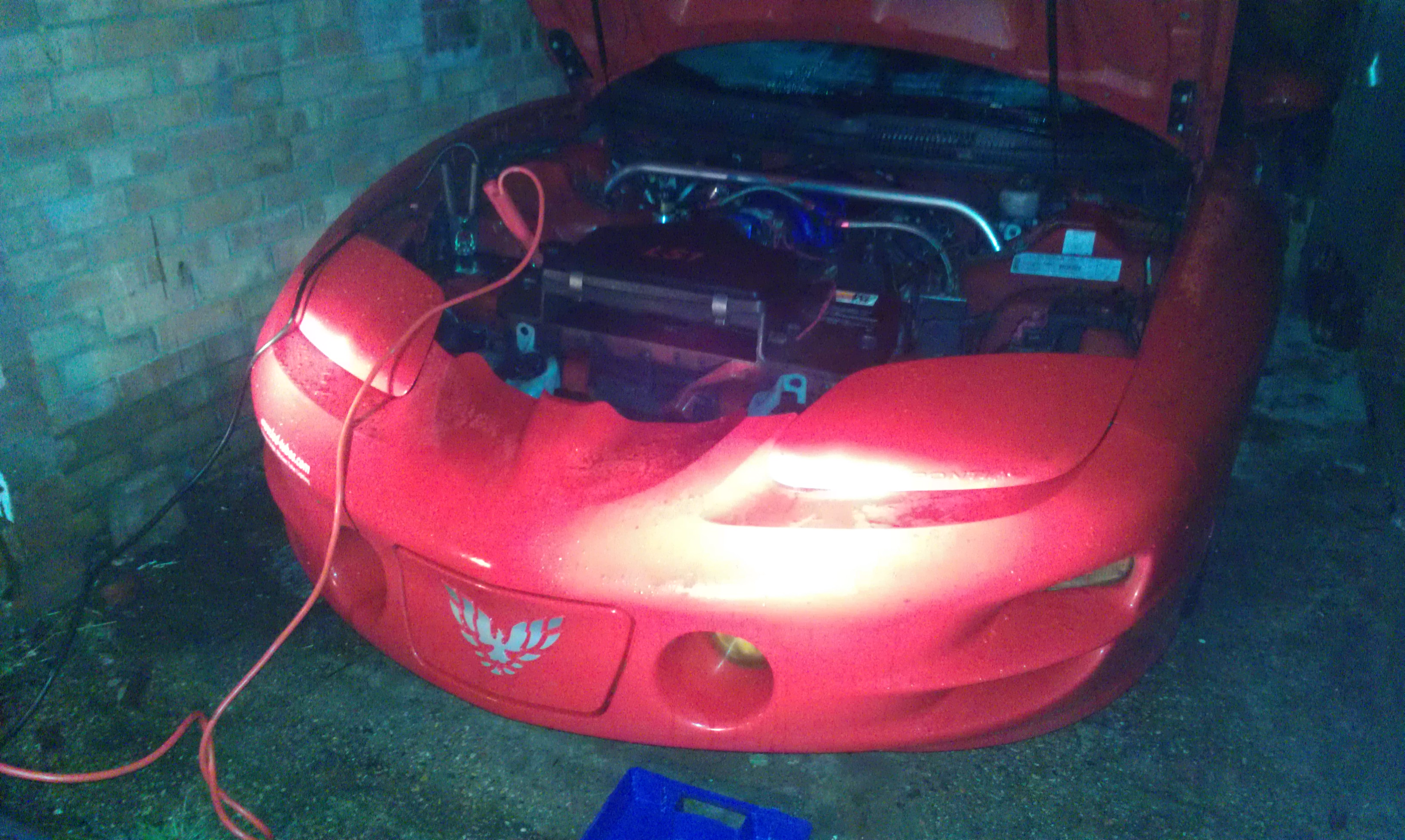

Car in the garage

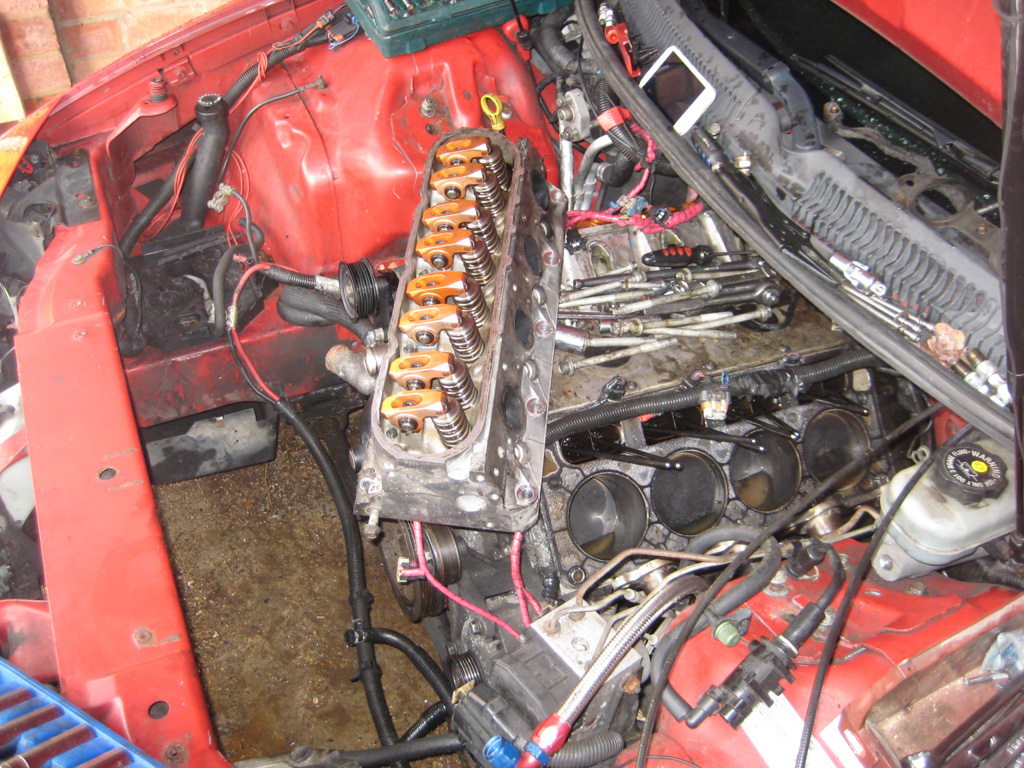

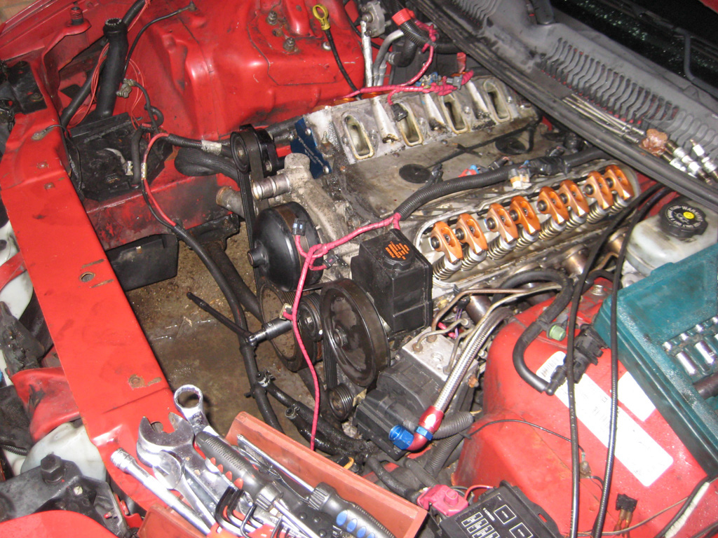

Got one head off. That was a challenge.

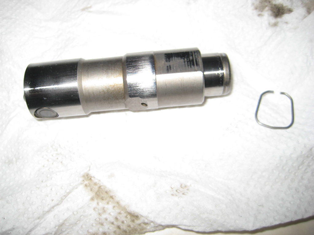

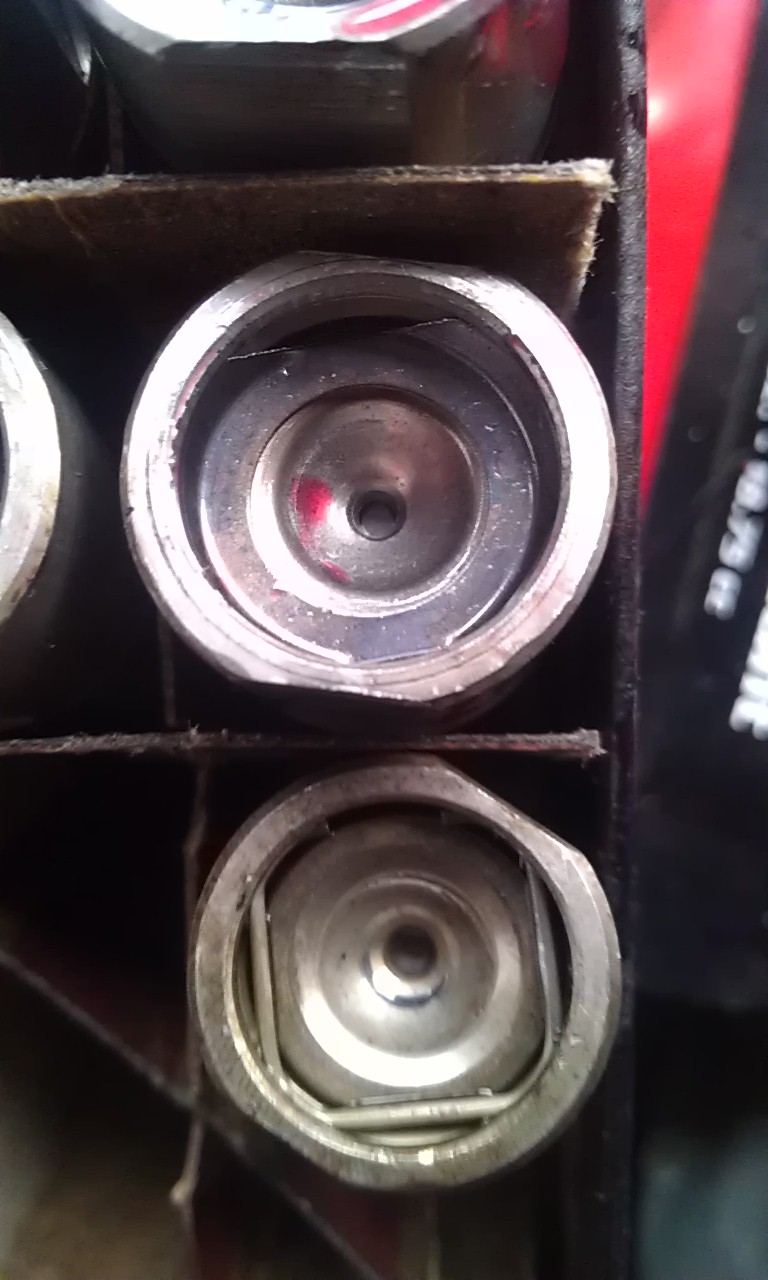

Took out 8 lifters on one side. One of them had a loose surclip. This would have giving a ticking noise as the oil pressure wouldn't have happened in the lifter.
transamdan-albums-engine-issues-december
So that was my problem.

I havn't put the same lifters back in. i have changed all 16 to a slightly different design also made by CompCams, but better for high-revving.
transamdan-albums-trans-am-engine-issues
The one at the top is the new one. The surclip looks a bit more substantial. I'm keeping a listen out for engine noised every time I drive it now, and not revved over 3000rpm yet.
