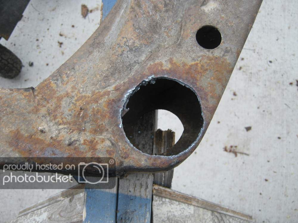

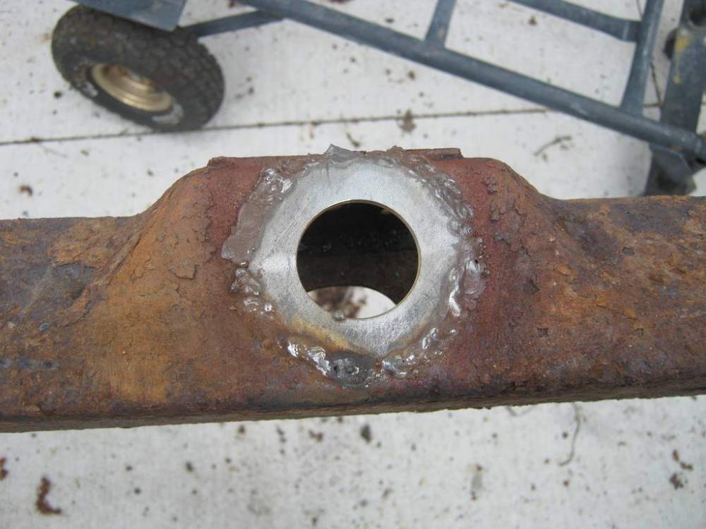

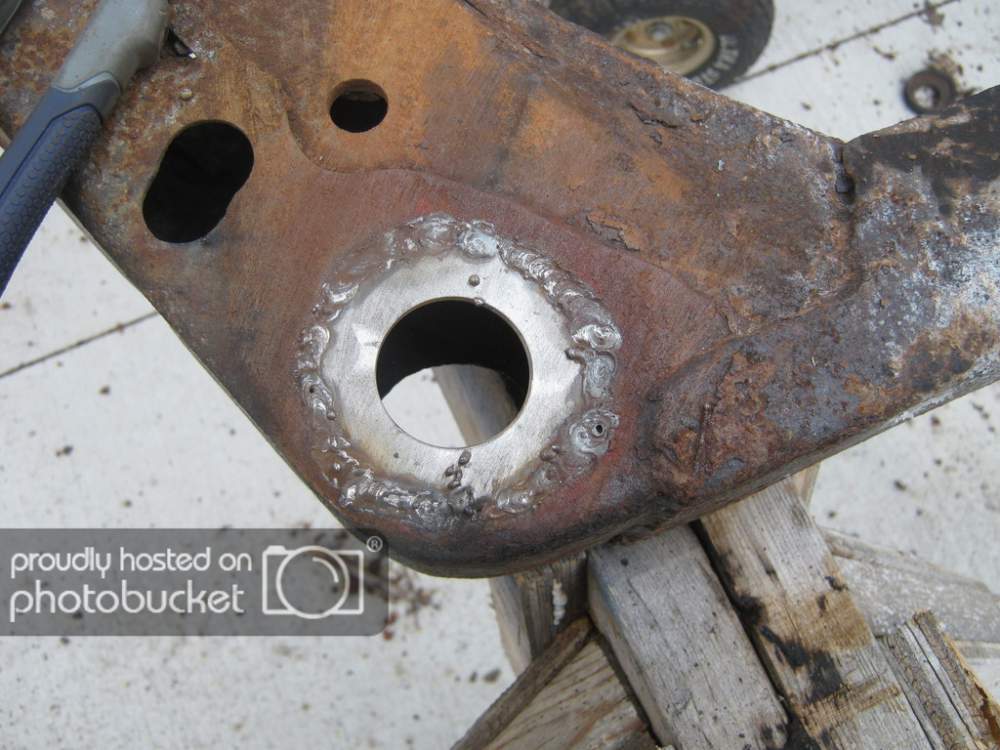

Finished welding the new rear section in today
Cut out the bad mounts God I love having a plasma cutter
tacked in the new
then finished welded

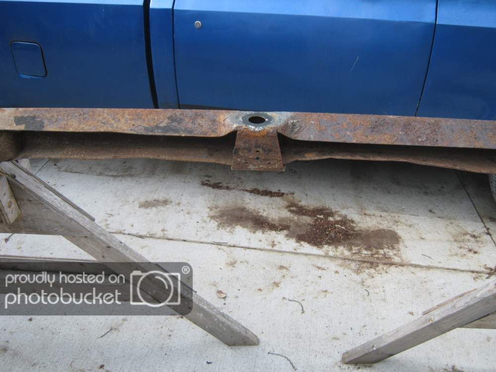

Nice work! Is all that just surface rust around the mounts?
Yeah the rest is just surface rust that is there. The body mounts trap moisture and over time it thins the steel and rots it out. I am fortunate that the rest of the frame did not suffer that much. Now that it is repaired I can just start boxing the frame.
Did you flux core that, or mig?
MIG

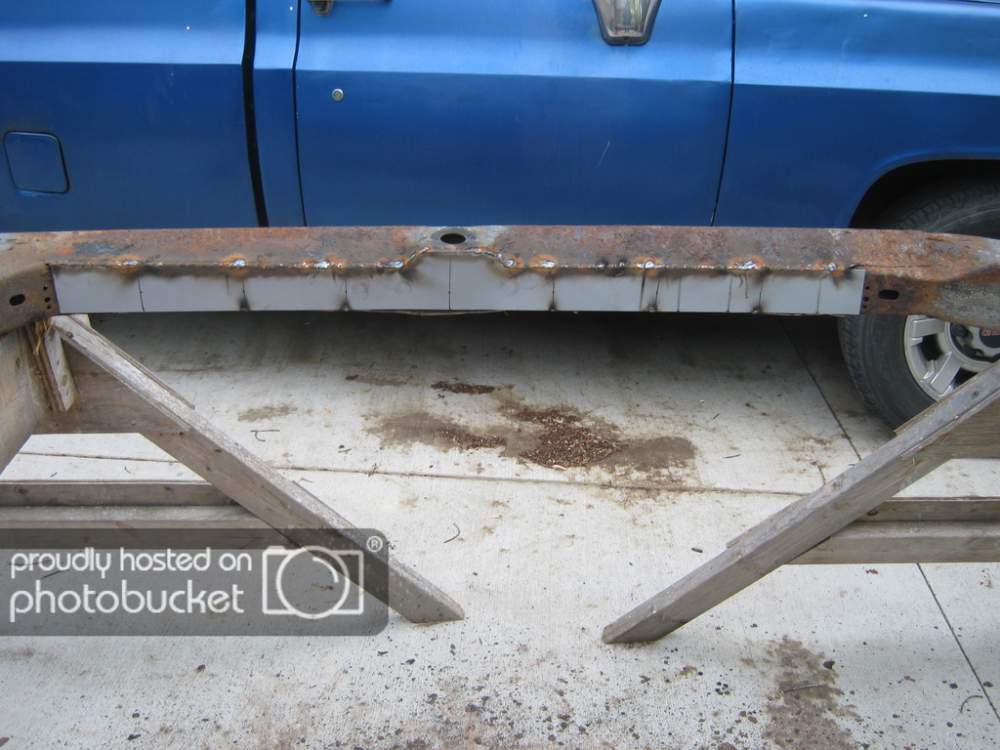

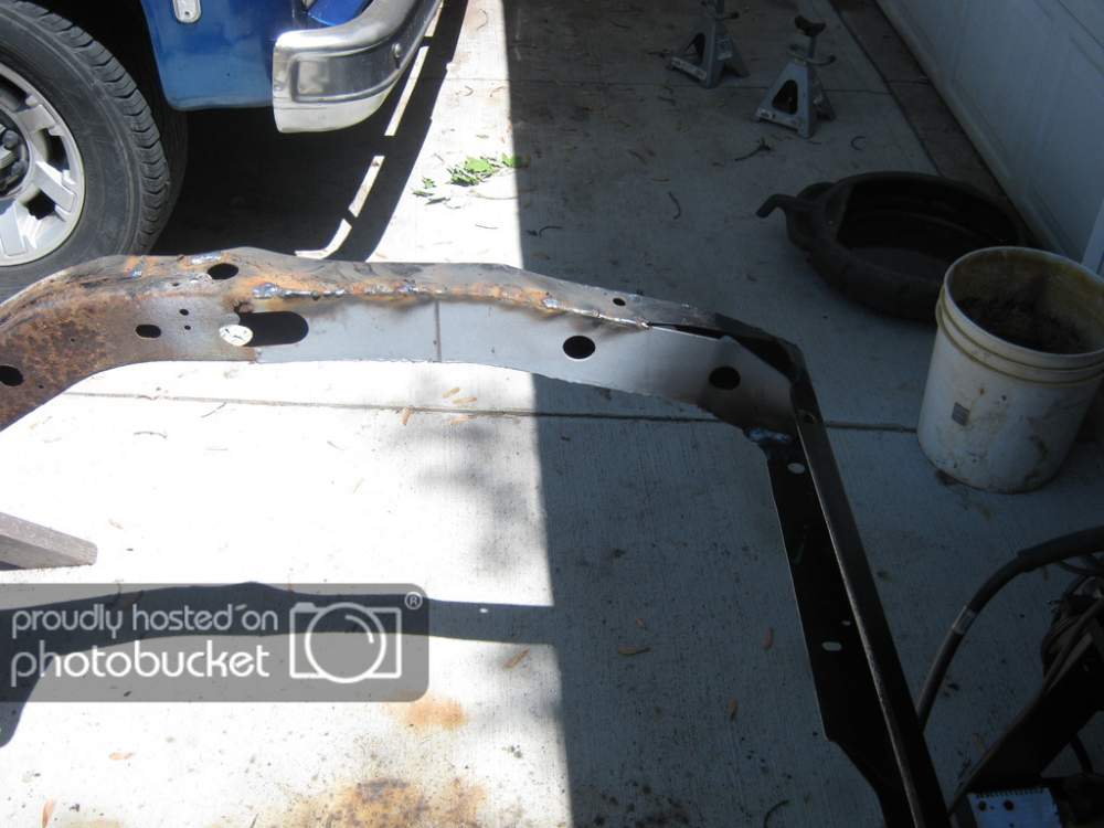

PROGRESS
Factory open channel frame

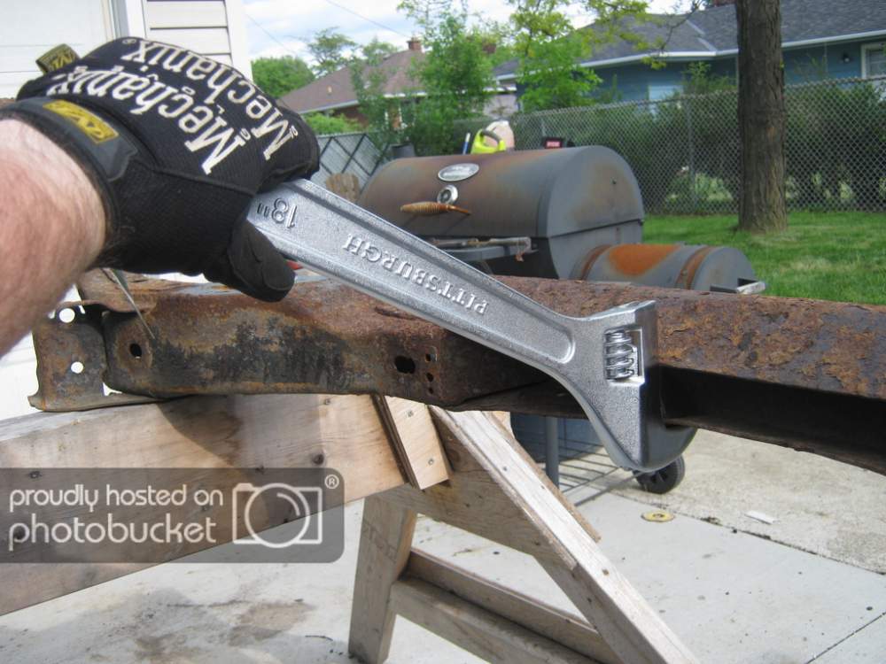

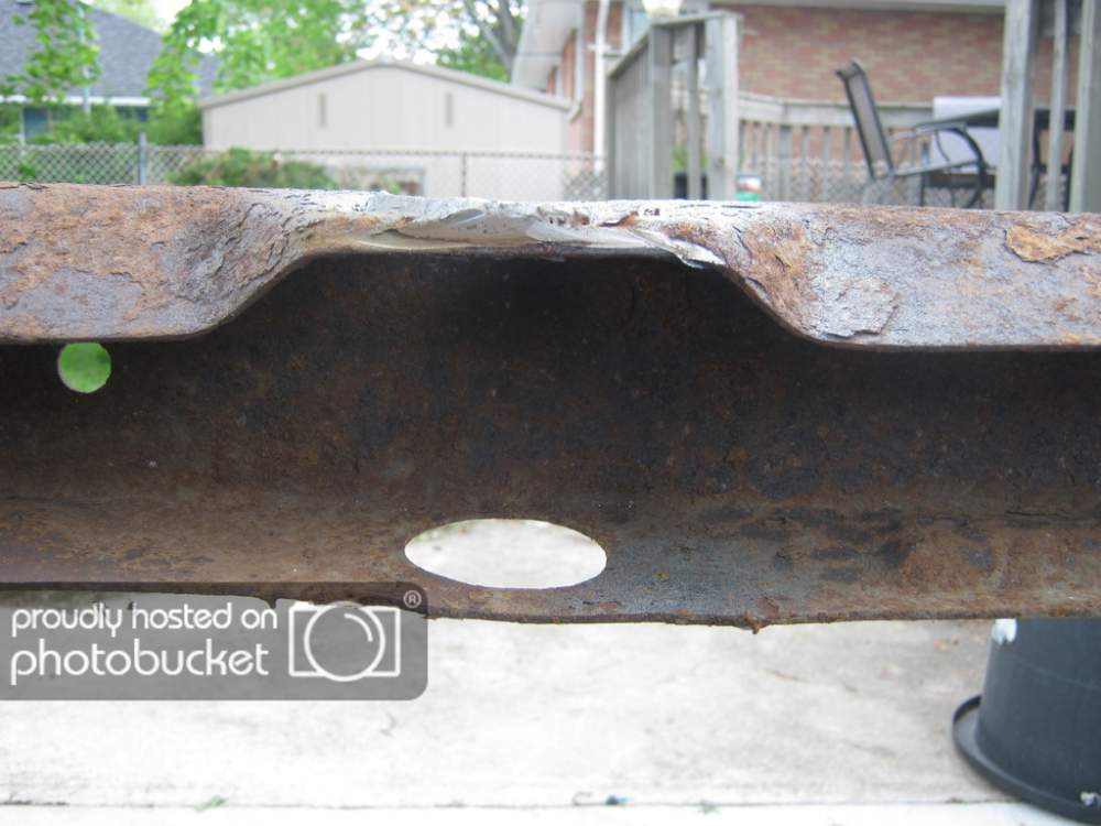

Cut this piece out
Using some manly muscles the lower frame was straightened out.  Years of service this does get bent a little.

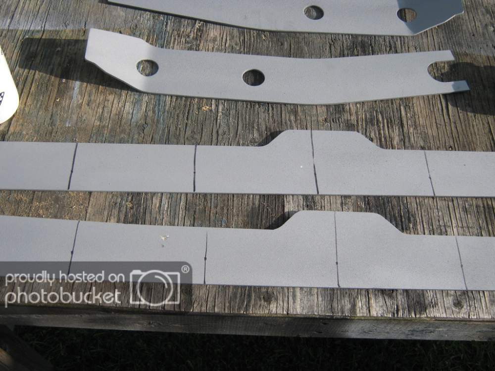

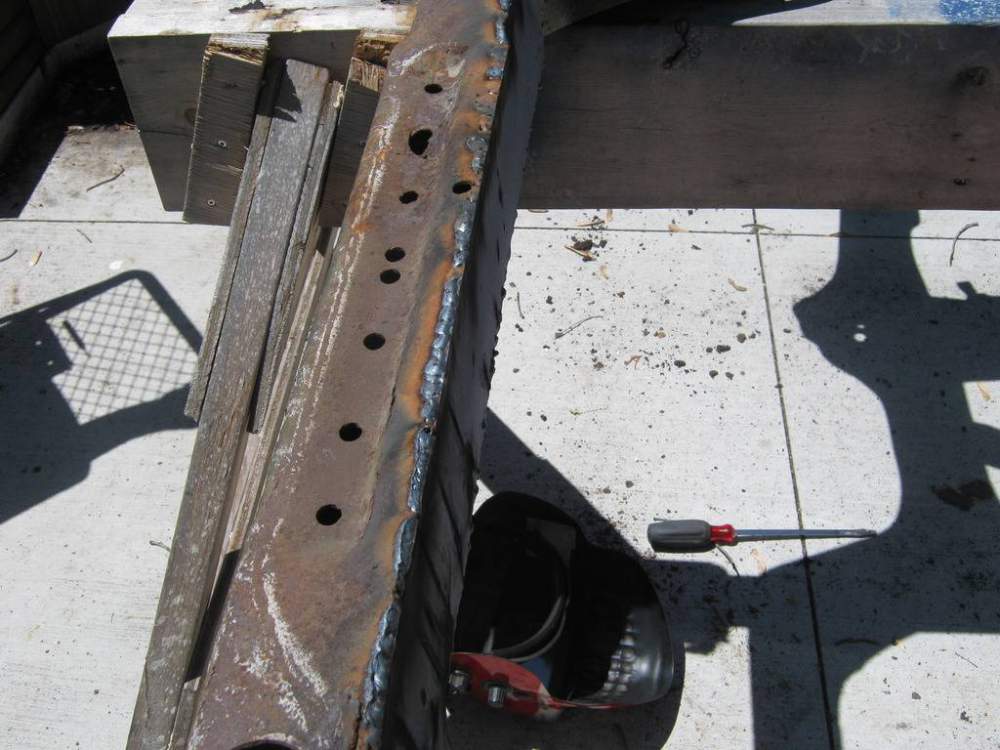

ABC Performance frame boxing kit
Tacked into place then stitch welding started.
Rear section stitch welded and finished
Flipped the frame to get at the bottom welds easier

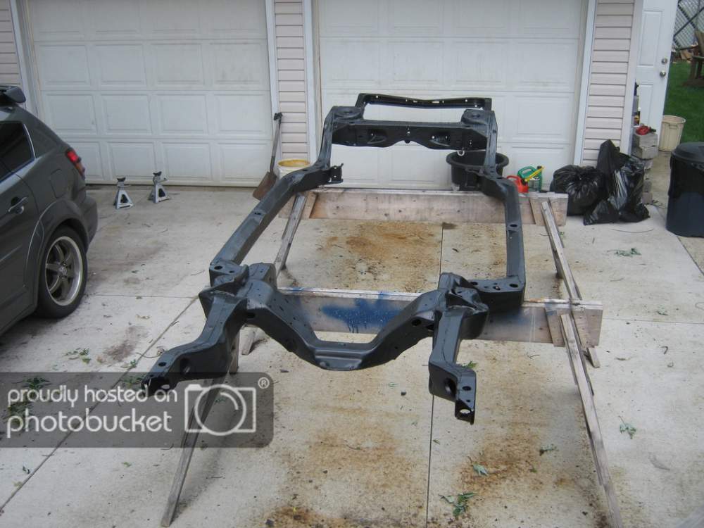

Started grinding, grinding then ground some more.  Finished it with a wire wheel and a whole wack of paint.
great work!
There ya go! Good to see progress!
Wow! Look at the crap all over that pretty new driveway! I hope the missus doesn't get mad at you again!
Looks real good buddy! Great work.
Ms Notallthere knows.  But the new pressure washer that I bought will get all that crap off.
Well done! Wish i had thought of boxing my frame..
Never too late.
NAT, I can honestly say those welds look as good as anything a TV host ever did. I'm just really skittish when it comes to migging with that much rust. What paint did you use?
I used Chassis Saver. paint and it worked really good then a top coat of VHT engine enamel.  The rust was just surface rust so a die grinder cleaned it off fast for a good weld base.  I only had one spot actually blow through.
