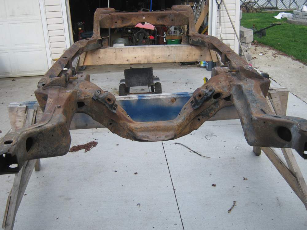

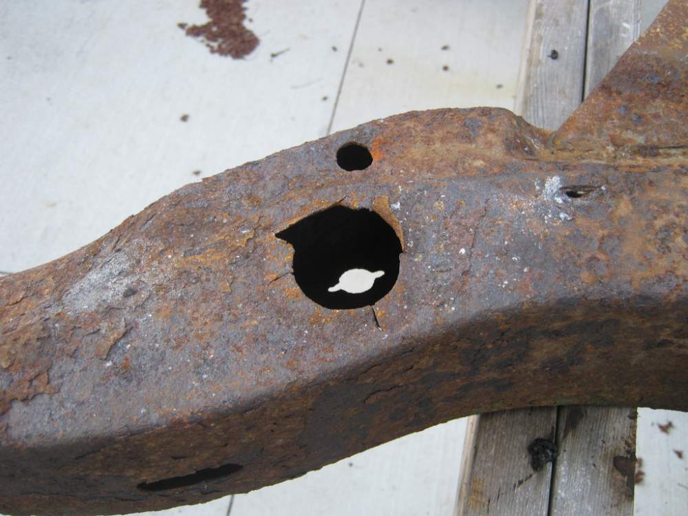

Separated the body of the Chevelle and the frame stuck the body in the corner of the garage. Then I stuck a bunch of crap in the car.
Stuck the frame outside. Degreased it.

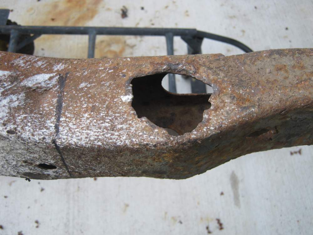

Bad spots on the frame. Gotta fix those.

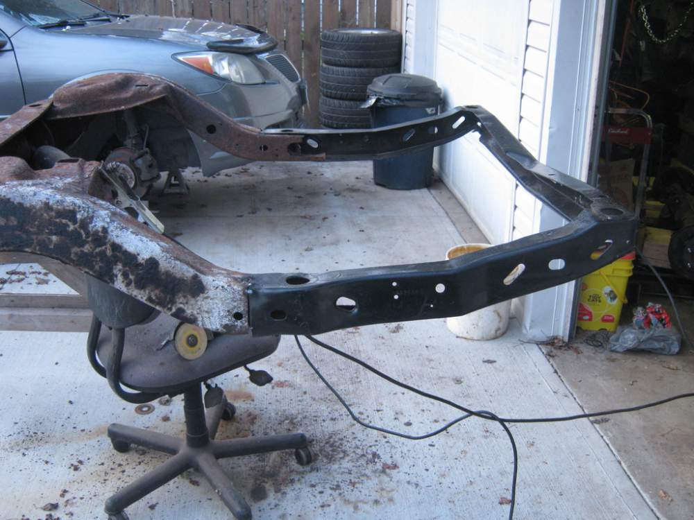

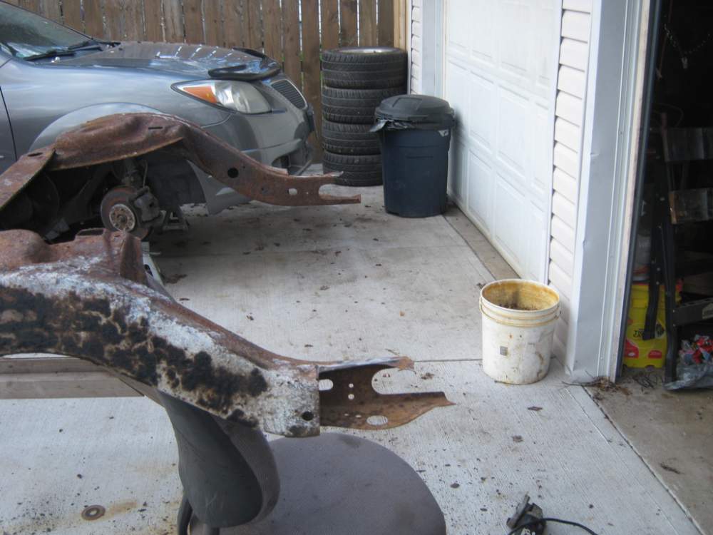

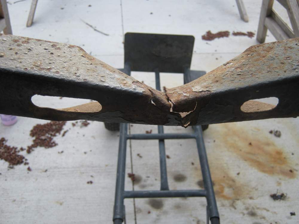

Started cutting

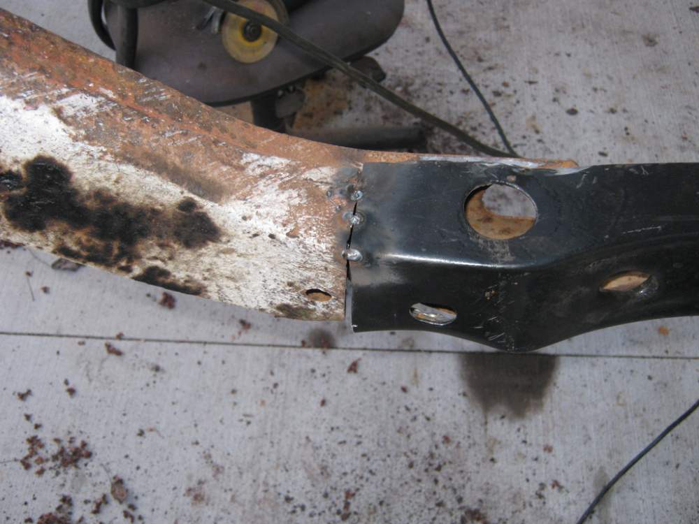

New rear frame section
You should really have Z cut that joint.
Actually I am going to fish plate it on the inside of the frame and then box the whole rear end. That also why I left the inner part of frame in tact.
Daaaammmmnnnn son. Them Canuckistany iron moths had a feast on your frame.
I've seen worse.... but then, we don't have inspections like sane places do.
