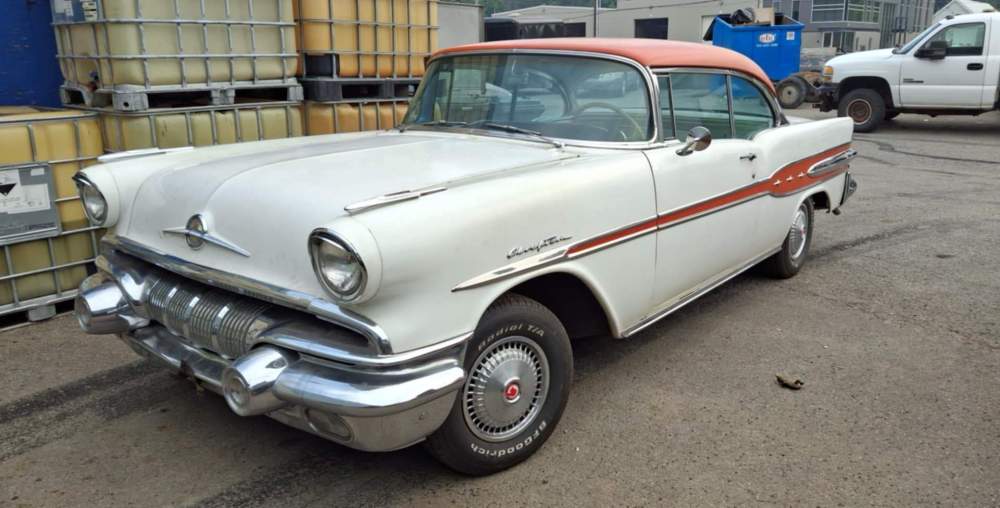

Hi guys,I purchased this 57 about 2 years ago with no motor,motor was getting rebuilt from owner.
I was going to buy the motor ounce ready but life took a curve and was not able to buy it.
I am now looking into installing an 6.0 with a 4l60e that i have from my 1966 beaumont that is another project on hold at the moment.Has anyone done this swap,I cant find motor supports for the us frame,only able to get what goes on the chevy frame.
Also anyone done a direction and suspension upgrade,I have king pins.
Thank you in advance.

your 57 looks super clean, :)
