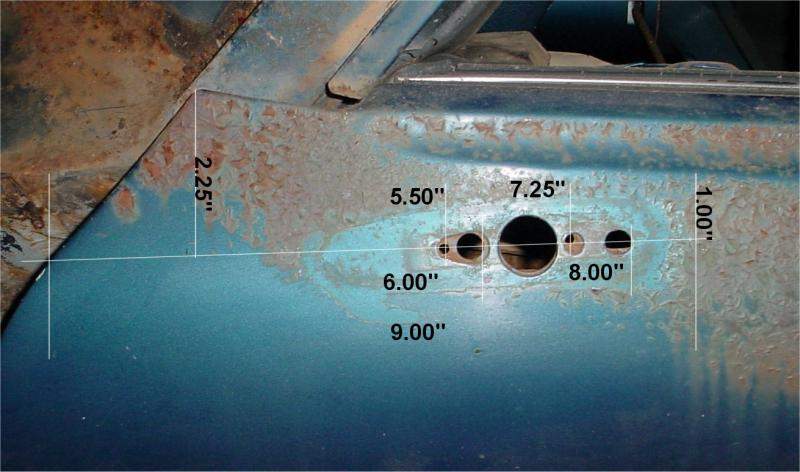

Anyway, I want to add a passenger side view mirror to the Goat, and was would like to know if anyone has any tips on positioning the mirror bracket to the door correctly ? I am not anxious to drill holes in the door and finding the positioning is wrong. I am considering making a cardboard template using the driver's mirror for postioning. Any thoughts or tips would be appreciated & thanks.

I recommend finding someone near you with the same era (68-72) GM A-body car with side sport mirrors, doesn’t matter which brand - Buick, Chevy, Pontiac, or Olds. Use that car to measure and/or create your hole template from.
Another consideration maybe to download the Pontiac service manual we have online here at FP. There may be dimensional references for the side sport mirror.
Here is a picture I downloaded from the web years ago, it worked well on my old 1970 Lemans

Well done Jeff bowdown

Thanks everyone, I appreciate the feedback. Special thanks to Jeff for taking the time to post the picture.
